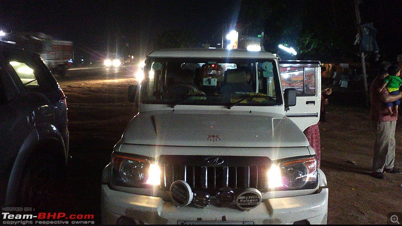

The headlamp assembly :
The bulbs and the harness (note the ceramic holders) :
Fitment in progress :
The wiring route and the relays :

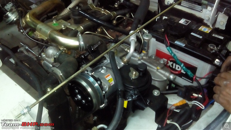

Also, the extreme want of a dashcam, in addition to extreme financial exigencies, plus the presence of an old Android smartphone at home, led to me purchasing the Caroo Pro app, and another windscreen-phone-mount (set me back by Rs.150/-), and voila! I had my own dashcam ready and set up to be used! The Caroo Pro has a plethora of useful features, and all that I need to do is to switch on the phone at the start of the drive. Here's a sample video :
I can't recall if I've stated this in my OP, but almost a month or two after the BolDero came home, we had a family trip to Digha with two infants, so had to get the AC installed in the BolDero super quickly and super reliably. So landed one fine morning at Daga Autolek at Exide crossing (right opposite Calcutta Club, and beside Exide building), and two days and close to Rs. 30,000/- later, had a very reliable and steady AC system installed. Till date, it has worked marvellously! The only gripe here is that the Bolero LX does not have the system in the blower unit to shift between Hot and Cold air (as was explained by Mr. Daga), and the part required to be sourced after-market was not readily available, fixing a heater would not be possible. It didn't really matter then, because I didn't have any hilltrips planned. May be later.
Here are the pictures :
The all-important gap between the belts, ensuring they don't snap due to inter-belt contact and resultant friction :

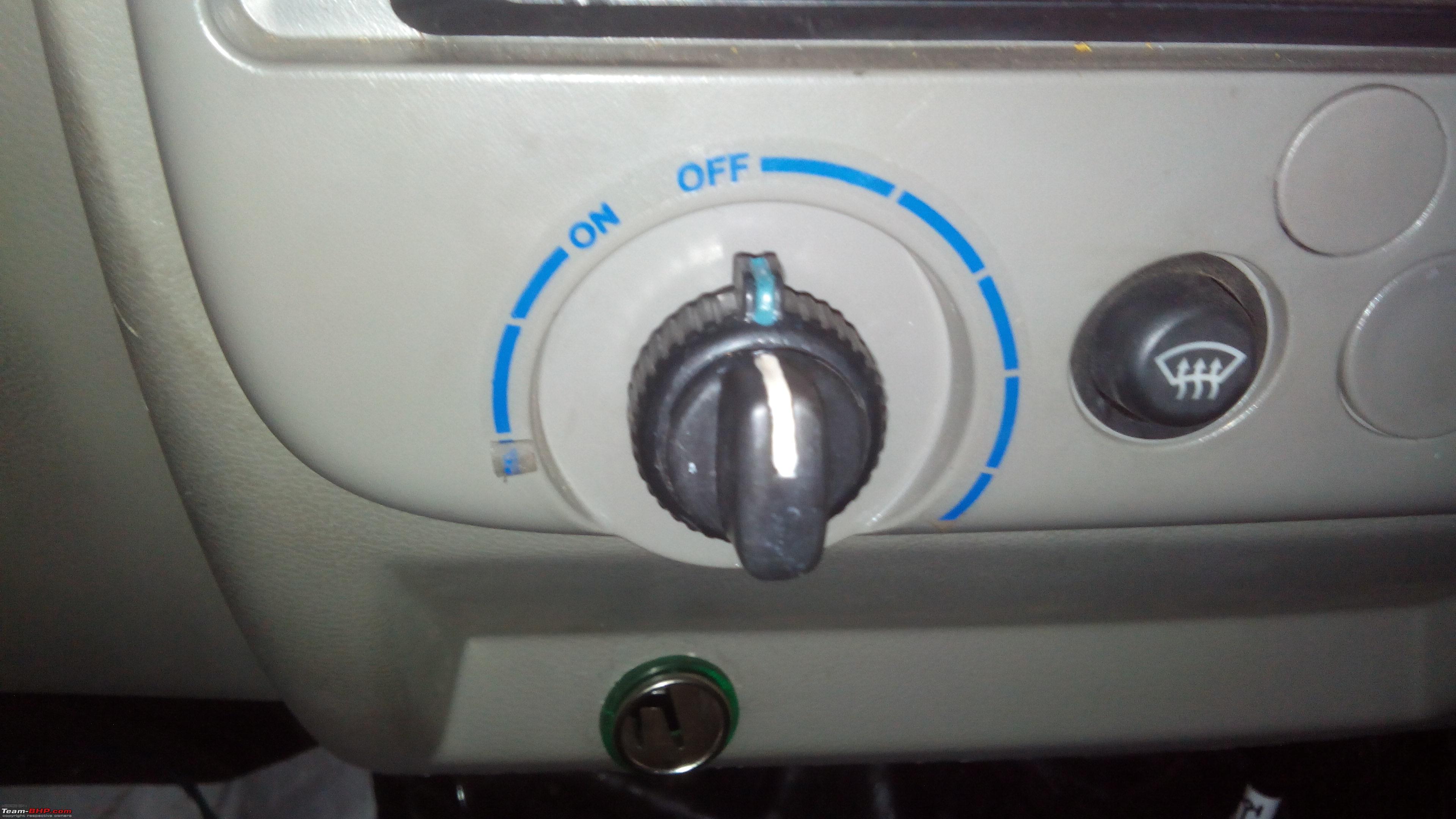

The On-Off - & - Thermostat knob :
The piping :
The entire engine bay after all was completed :

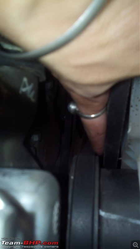

There arose one other problem from the fitment, though, and a serious one at that! One fine morning, when I reached work, I saw coolant fluid dripping from sides of the bonnet. Opened the bonnet, and to my surprise, found the entire engine bay covered in coolant fluid spray! Almost had a heart attack, but could not find the source of the leak then. A day later, found this :
That happened because of the compressor rotor was brushing against the pipe carrying the coolant from the radiator to the engine block, and eroding it to a very minute and well-hidden leak. The leak surfaced when the pressure increased. Immediately had it changed, and made another JUGAAD to keep such further incidents at bay. See below :
Since then, by Almighty's Grace, had smooth sailing!

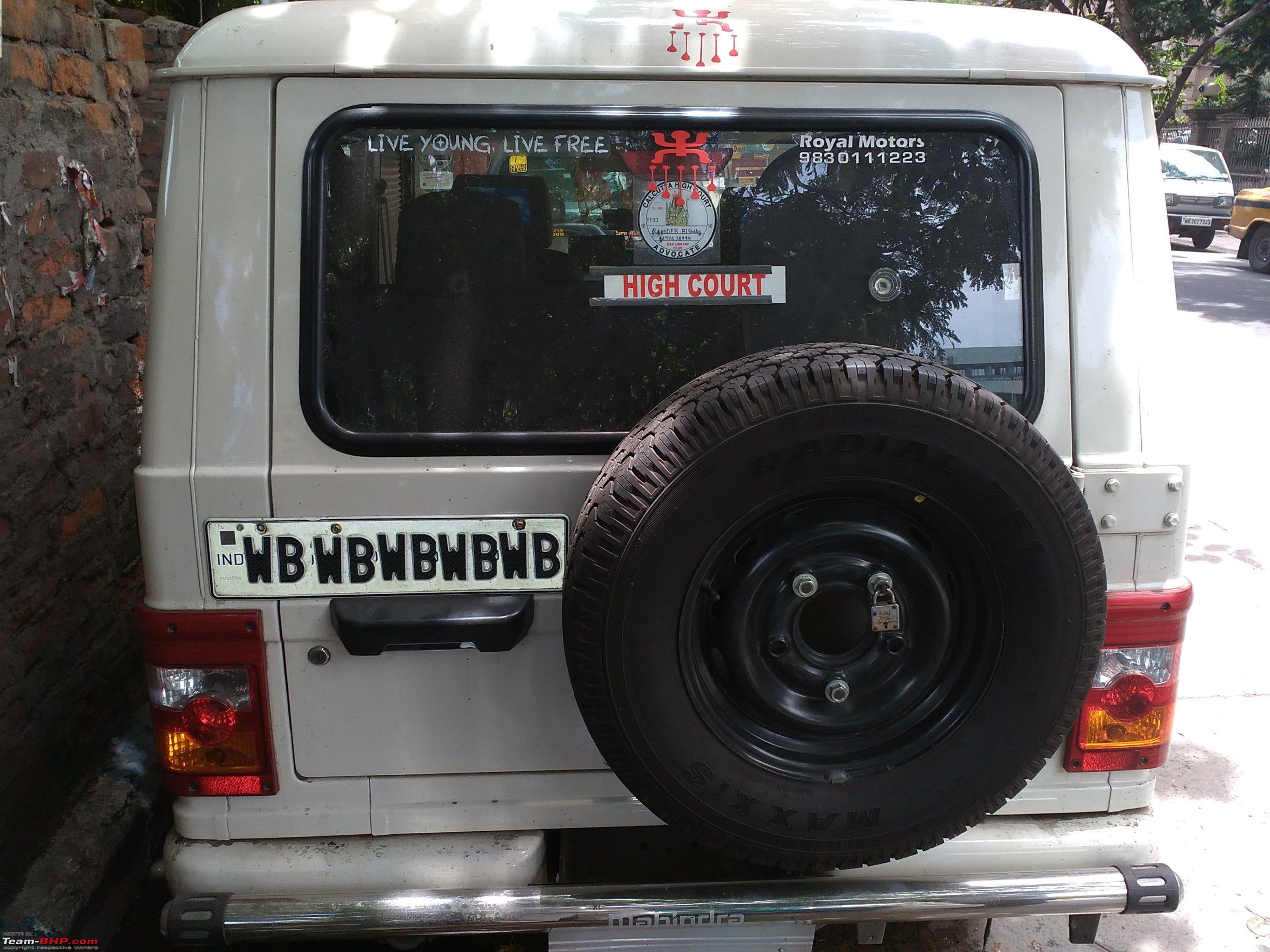

Apart from the above, there are two changes I made to the exterior; one is fitting two pairs of auxillary driving lights (local make) up front in case of any emergent use, and the second being relocating the number plate. A few days ago, I saw the number plate tilted on its right side. Closer inspection revealed that the rivet used by the Transport Authorities while fixing the HSNP had rusted and broken off. I also stumbled upon several TLs and Reviews on the Bolero where I found that the first thing to take a hit is the number plate. So the local garage drilled in two holes on the rear door (Size – 10) and with the help of a treated and painted plank of wood, fixed the number plate like this :
Now that's a solution (so it seems now!) to the problem that has plagued many!
