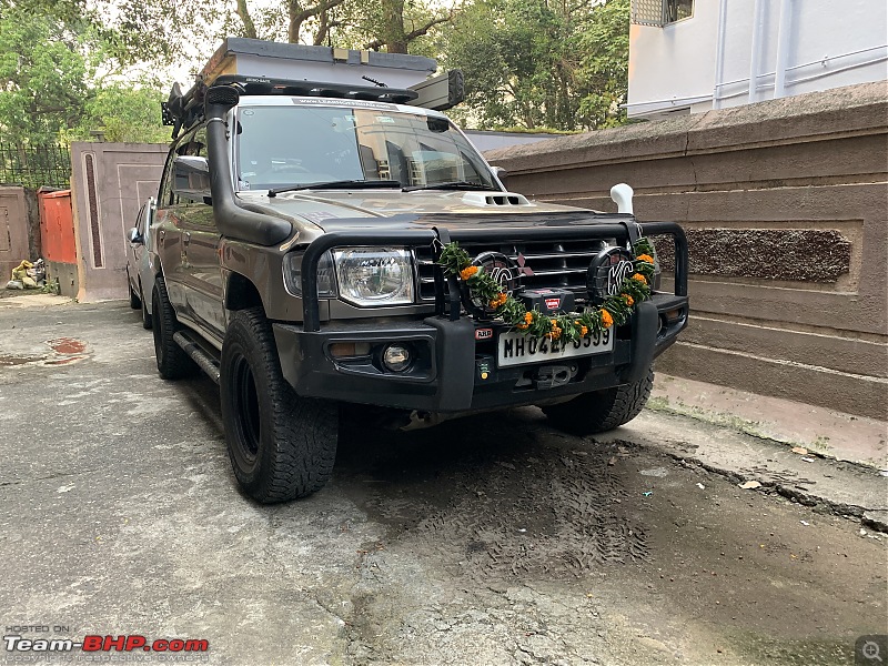

Happy dussera. Just realized I have never posted a pic with any flowers.
Honestly I don’t like to put a Garland and definitely not the red swastika that the ladies like.
So compromise is the Garland.

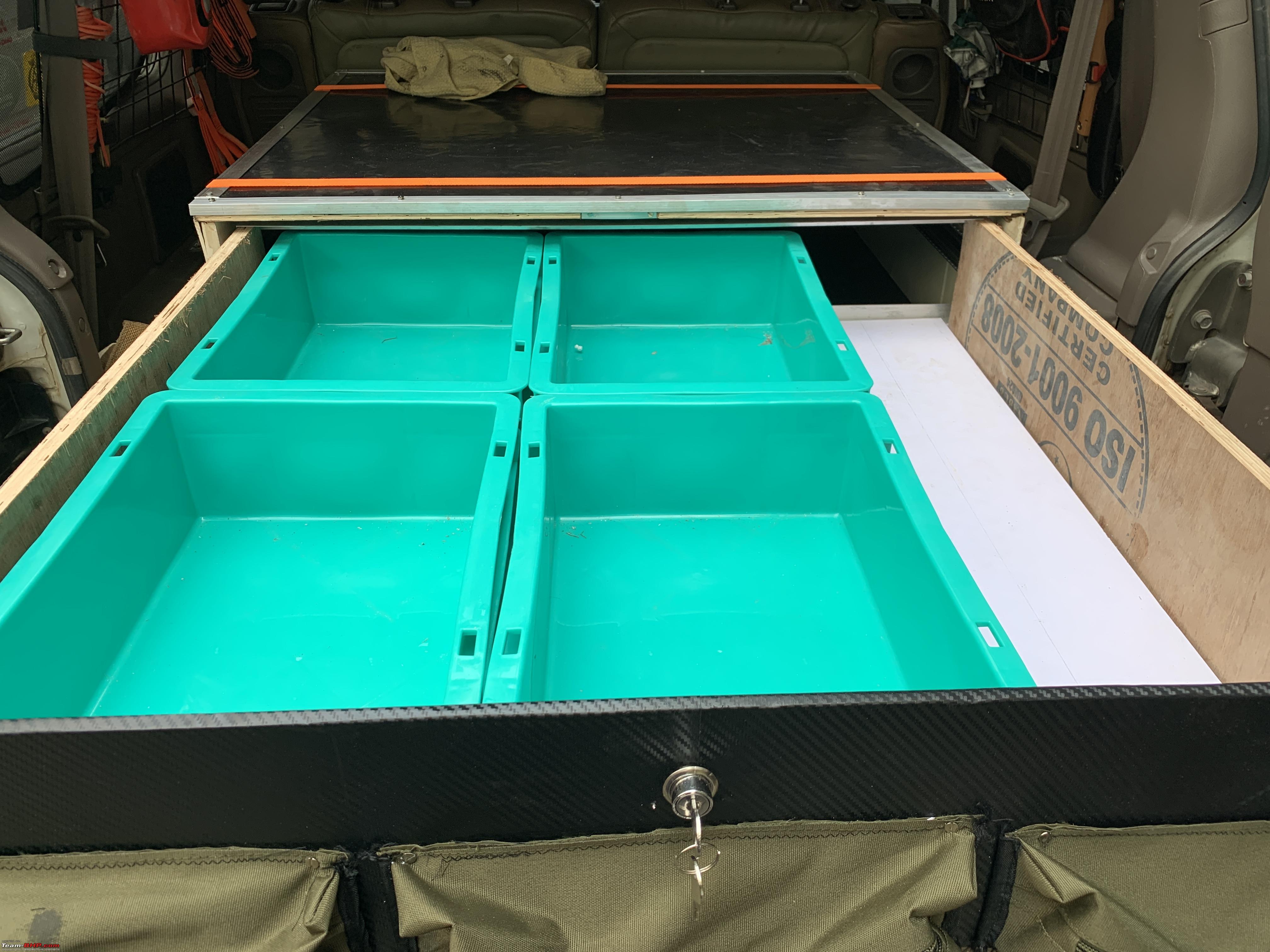

Over the past few weekends, did some more DIY.
Needed another set of drawers over the existing one.
Till date, I used to keep a big plastic crate and store wet recovery gear but it was a pain to access it all plus to access the folding table, everything had to be removed.
So the plan was to add another drawer system on top of the existing one but in such a way that it could be independently removed in case I wanted to travel with big bags.
So fabricated first a frame of Aluminium using "L" shaped sections. These sections would slot over the existing box and prevent movement in the four horizontal directions.
A mounted angle cutter makes life easy:
Once that is done, it's a simple job to create the box on top. Because this time I didn't have a vertical "pillar" I used a thicker section of wood instead of the Pvc ply which does tend to bend under load.
Once the box was ready, I cut a piece of rubber sheet:
Stick with rubber adhesive and then a L section frame on top to secure and prevent edges from chipping.
Then fabricated the drawer and stuck the carbon fibre wrap to match the other drawer.
Mitsubishi Pajero SFX - Project Overland Conversion-03-carbon-fibre-wrap.jpg
I had bought this from amazon a while ago.
https://www.amazon.in/gp/product/B08...?ie=UTF8&psc=1
A pouch for tools but it didn't serve my purpose.
So I cut the pouches up
And sewed them as individual units at home
The quality of these is superb and I screwed them to the outside of the drawer for quick access of anything I need to put (haven't decided yet what)
Next is to test the fit. The depth of this drawer is 4" less than the below one to accommodate the angulation of the rear seats.
Secured with heavy duty straps and drawer goes in
Used smaller plastic carton inside and there is a L section frame inside to prevent them moving around
Mitsubishi Pajero SFX - Project Overland Conversion-09drawer-open-closer.jpg
These would hold wet and dirty recovery gear and I can easily remove each box and take them for cleaning
Still need to finish up the insides and edges of the drawer.
Have purposely left some space between the two (around 2.5 inches) so I can slide in a folding table, folding stools, and a white board that I carry during courses.
Used a regular drawer lock currently and I'm waiting for proper latches to a drive from abroad. Once they do will modify to how the lower drawer latches are.
