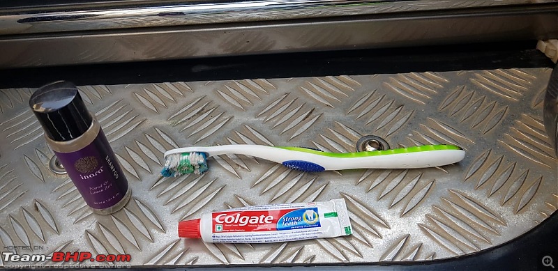

Weekends when I'm home mean I'm doing something with the car in the garage.
Whenever I travel, I'm always picking up the complimentary dental kit and shampoo / body wash from the hotels.
These come in great use for the car.
The toothpaste hotels usually give is the white Colgate dental cream which is best to clean glass and the shampoo is great to add in the windshield washer.
Been using the shampoo and/or body wash for years without any issue for the windshield washer.

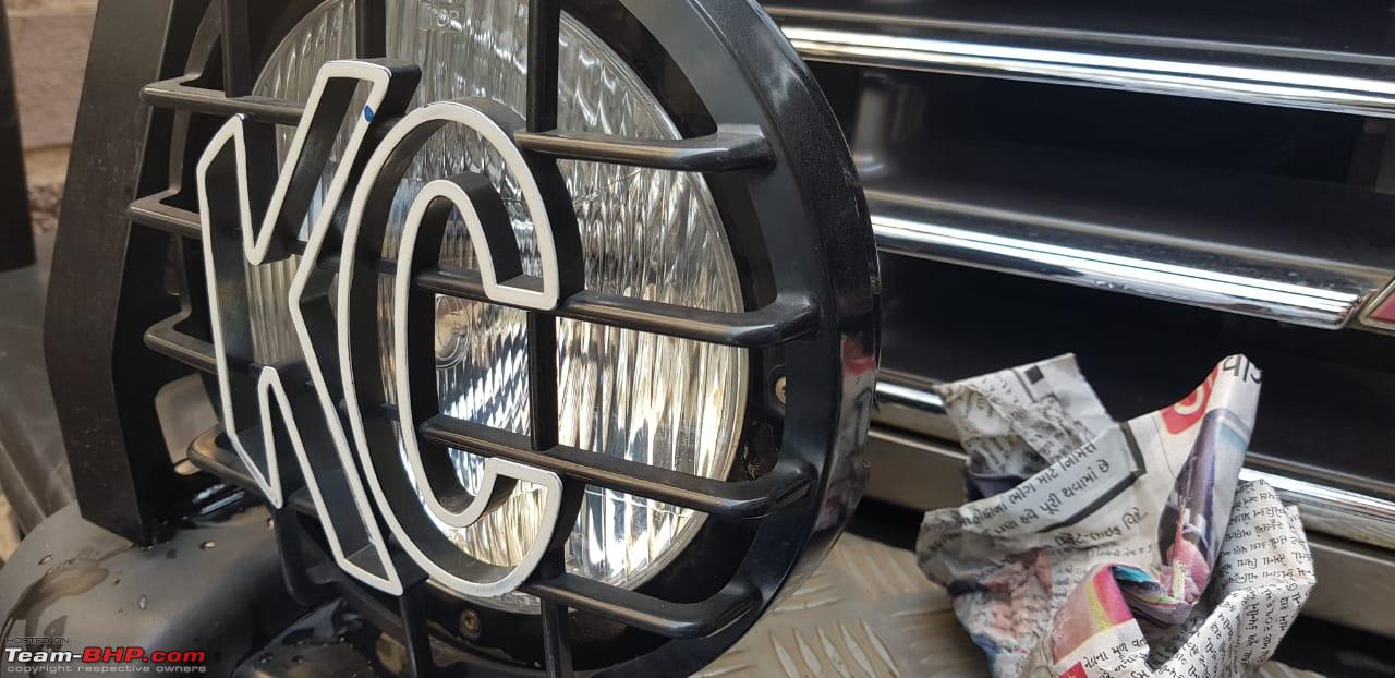

Just take the paste and brush and scrub on the moist headlamp:
Clean with water and dry with a newspaper!

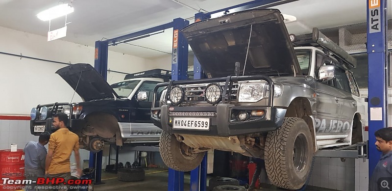

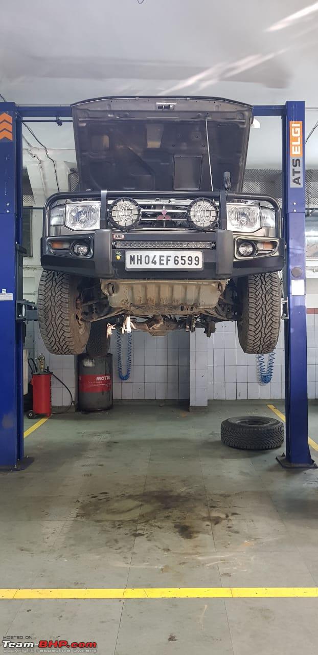

Got the car serviced at 1,10,000kms
Location:
Noble Hub Mitsubishi Service Centre
Address: Unit no.1 to 4 ground floor,
Vijay Industries,
Opp. Forbes & Company,
35 Chandivali Village,
Andheri - Kurla Road, Off, Saki Vihar Rd,
Mumbai, Maharashtra 400072
Timings: 930AM to 8PM
Phone: 084269 28888
The usual, oil and filter change.
My friend amol, also had got his car from lonavla for the service:

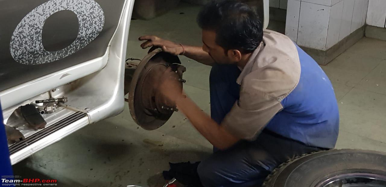

I was finding the handbrake a bit sticky and got the shoes sanded down and while at it even the rear brake pads changed - both sides.

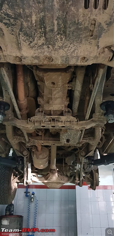

The underbody was a mess:

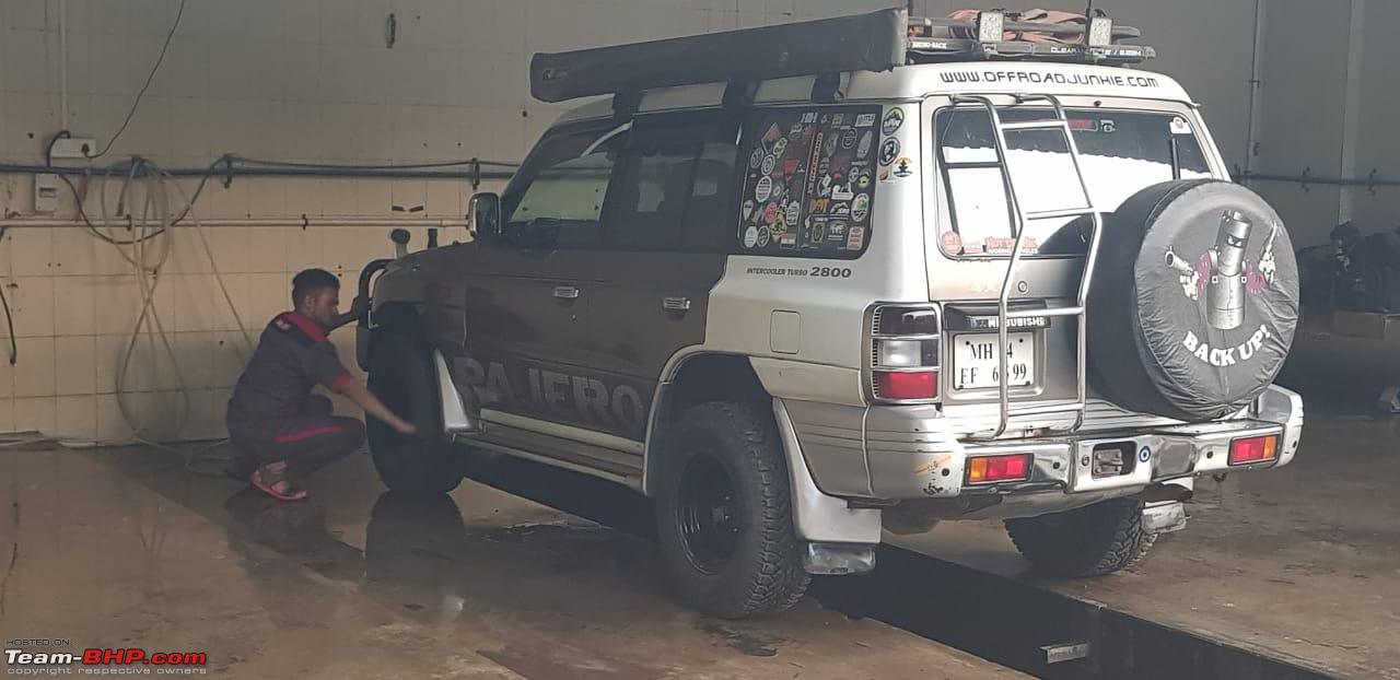

Cars taken for a wash:
I always stand and get everything cleaned properly:
