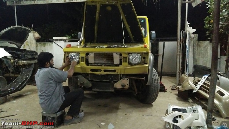

The mods are ON with Yellow one since we had to wait some time to completed the registration formalities and to sort out the above said mechanical issues with the other one. The main plan as of now is -
Cosmetic makeover of Front Fascia with Merc parts
Restructure the roof panel from the current slopping to an almost flat
Reshape the current wheel arches with Merc fender flares
Replace rear bumper and tail lights
These changes will bring out the hidden characteristics of the real G inside Gurkha
The modification works are being done at Marvel Motor Cochin, they are the people behind most of the modded cars in Cochin but are less known to public since they were always behind the curtains the credit for the show went to someone else. Rameshan one of the owners of Marvel is very passionate about what he does and he enjoys such challenging mods, he himself will be working of our cars too.

No it is not an easy direct fit on Gurkha, the dimensions and sizes are matching but a lot of high skilled and precise fabrication jobs required for the fitment of merc parts, if you get the didn't get correct alignment and fitment then the result is gonna be worse.

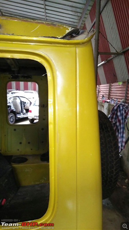

Front facia is almost done and now it's time to have the roof flattened, however not as easy as expected, when being flattened the overall length will also be reduced, which need either extension of the roof panel or tilting of rear pillar forward as in the real G or may be both, let the below pictures explain it better.
Force Gurkha: G-Wagen Makeover-14-2.jpg
When flattened the length of roof panel is shortened and not reaching the rear pillar
Force Gurkha: G-Wagen Makeover-14-3.jpg
Force Gurkha: G-Wagen Makeover-15-1.jpg
Force Gurkha: G-Wagen Makeover-15-3.jpg
Plan is to give a small tilt to the rear pillar as shown below which might solve the length issue of roof panel !!

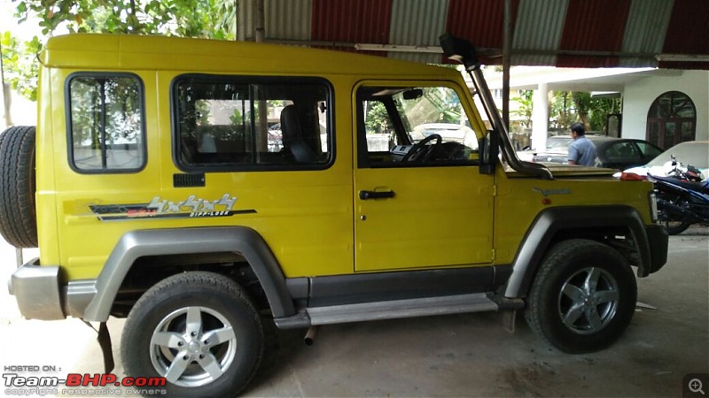

The main body mods are almost done -
Roof flattening is completed, the desired shape is almost achieved. Some more final refinement are on going after which it is ready to go for body preparation and then to paint shop.
This was the third most trouble some mod to bring a tilt to the rear pillars, first of all Gurkha doesn't have reference point to make this tilt and further to which its length (upper edge) has to be made aligned with the flattened roof.
Finally it looks the roof got decently flattened and almost in line with the G dimensions!, anyways i am satisfied with this since i don't intend to replicate point to point of real G Wagen but to bring Gurkha as much close to it
Force Gurkha: G-Wagen Makeover-img_3305.jpg
Here it goes with the rear view, decided to close the rear windows too, that was more of an LR Defender looks
Force Gurkha: G-Wagen Makeover-img_3308.jpg
