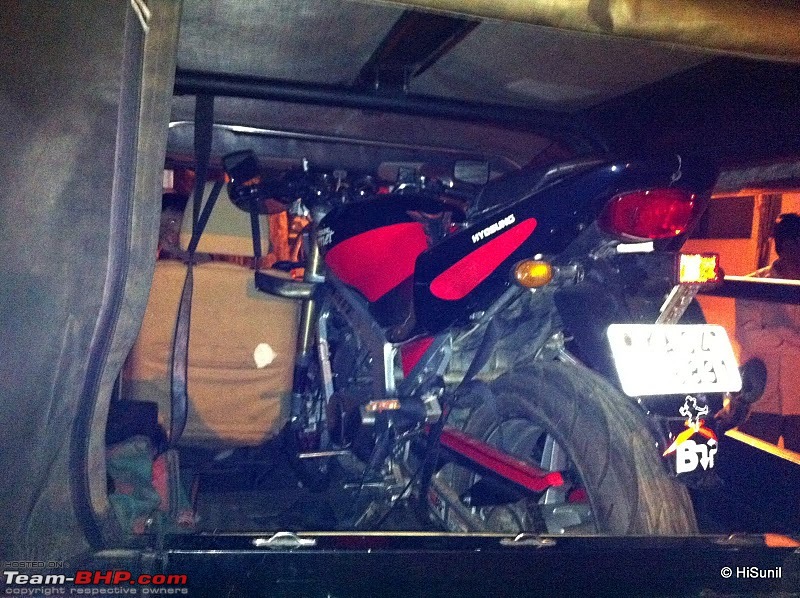

I also was able to load my Bike GT-250 in to the Gurkha with my cousin's help. Need to make proper mount & support points & secure it with straps.
Drove it for 2 to 3 kms at night it felt OK, need to do more testing. Was missing my bike in ghats, so this setup is to help reach ghats base (300- 350 kms from Bangalore ) with family & luggage, check-in to a resort & see the surrounding on the bike, load it back in & return to Bangalore, need to see how piratical it is.
The current Issue is that the seats need to be moved front, also the front wheel coming in necessitates the 4wd liver to be in 4H (in front), need to work around this issue
Some pics Enjoy

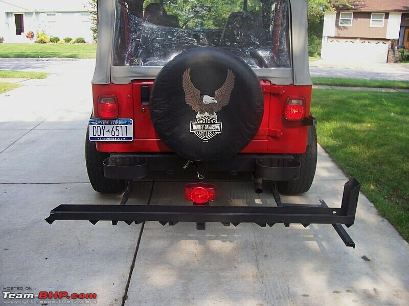

About carrying your bike I thought I will chip in.
See the pics, we call it no mates trailer ( you can load it alone) but basically it is a bike carrier attached to the tow hitch. This may be of use to you and leave room in the Gurkha for more gear.
What’s the best Off-roader under 10L? EDIT : Bought a Gurkha!-dirtbike_carrier_6.jpg
What’s the best Off-roader under 10L? EDIT : Bought a Gurkha!-dirtbikehitchcarrier6.jpg

Thanks Motocoorg in fact that was the first thing I tried, but has 2 Issues
1. The GT-250 is much wider that the Gurkha, hence not sure if it will be safe
2. It weighs 180 Kgs dry & with all my mods 200+ now so really need STRONG mates trailer
Thanks 14000rpm but the Gurkha Door swing opens & carries the spare wheel which is quite heavy & hence cannot change the door to a flip open one as you have shown.
But surely something needs to be done.

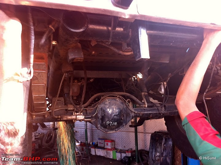

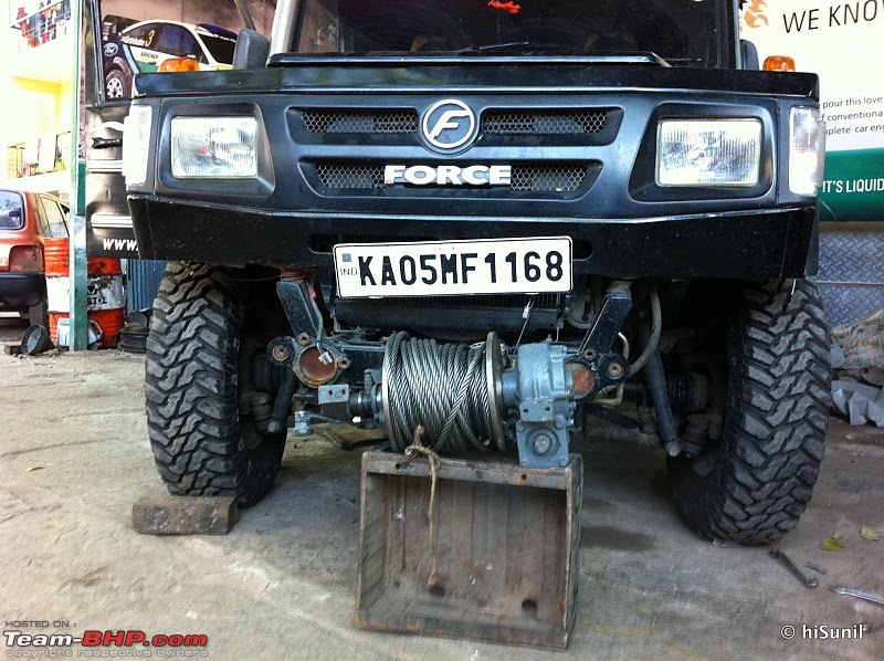

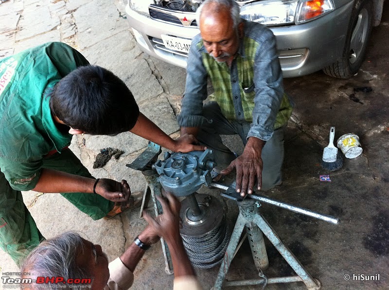

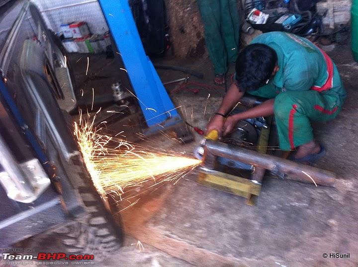

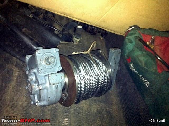

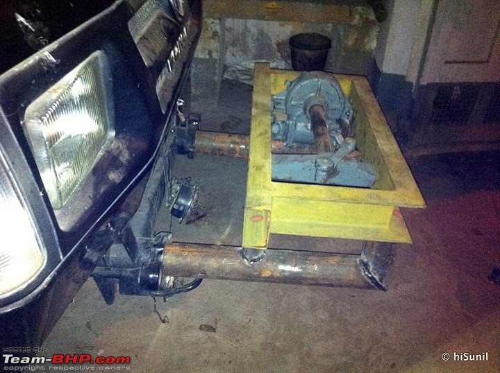

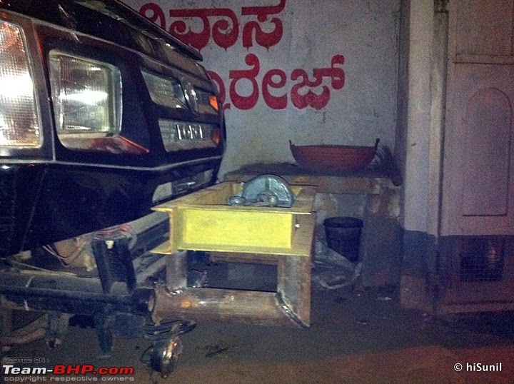

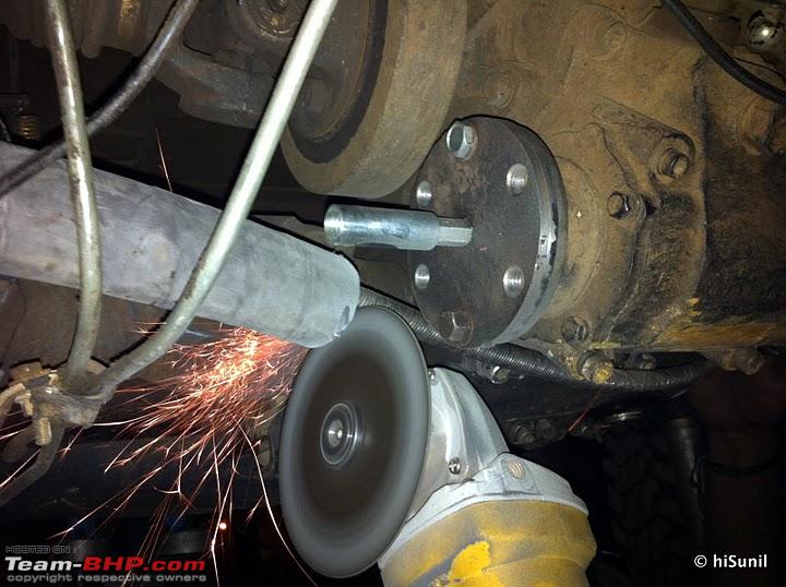

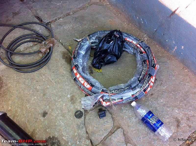

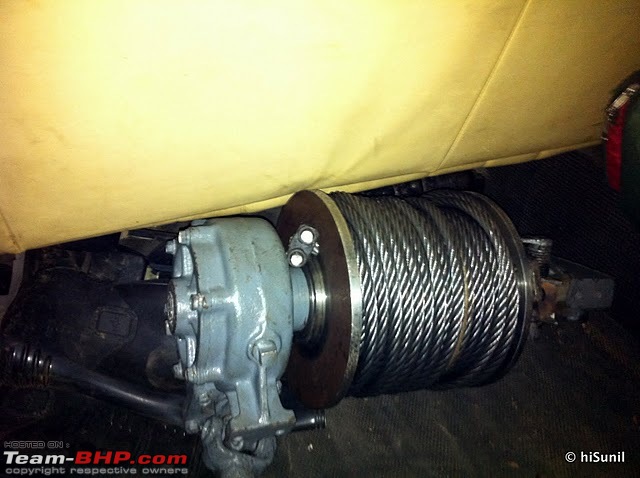

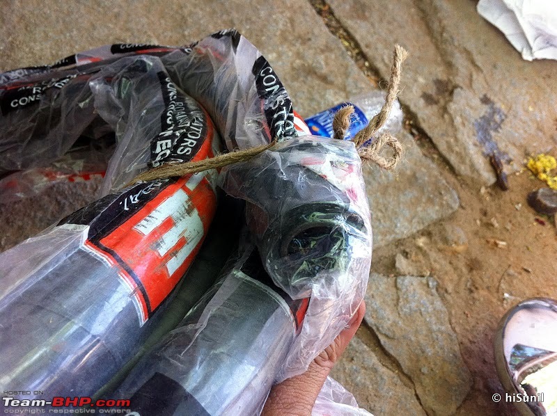

More updates on PTO winch for the Gurkha:
Its almost ready,
New piece fabricated for
  1. 1. Control shaft
  2. 2. Lock / Release mechanism
Bearings Lubed & Hydraulically pressed in to the drum
Yet to fix & wind steel rope & test the setup before mounting
Mounting & Driving is yet an other beast
Planning for a Prism type enclosure to house the entire Heavy setup upside down below the navigator seat
Use a JCB shaft to couple PTO Transmission out to Winch in.
Let the pics speak.

Yet to fabricate its Mount to the body & route a Joint to couple PTO T-Case out to the winch.
Its almost impossible to route the PTO drive to front of the vehicle.
Rear is possible with some effort, Just hoping to see it work in a couple of weeks.

More updates on the PTO Winch:
At first We tried to make a chassis mount & fit it in the front, connect the PTO to TCase via a vibrator cable. But that worked only to roll the cable at no-load, when it was asked to pull the Gurkha (with breaks applied) towards a tree, the cable cut near the braising point just after T-Case output. (Arka did warn about cable not the same as shaft! & I was not sure as-well), but was our only option to couple PTO to T-Case with no line of sight from T-Case to Front Bumper.
Later removed the mounts & welding from front, removed the diesel tank at rear & planning to put winch in its place & connect a propeller shaft (a thick fat one) from T-Case rear output to Winch. Rahul suggests that I get a plastic petrol tank that can be inside the cabin & possible larger in capacity too. I am worried about safety & smell if the tank comes inside the cabin.
We are yet to see if the rear setup works, fingers crossed, the Jeep has been in the garage for the past entire month :(
Lets the pics speak:
