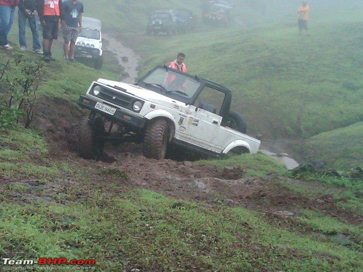

sorry guys i was too busy because of EXAMM so didnt get time to put detailed WIP pics. I will surely give you all the complete writeup with proper pics of each and every mod. As of now posting few pics for your comments

Hey devang!!! looks mean dude..killer Your comment should be the first, so how did she drive?
The articulation pic is cool, did the other tyre scrub against the body?

drive with mudzillas and without sway bar is very risky, it goes anywhere. we are working on it. there was minor scurbbing on full turn not otherwise

one more pic from different angle where you can see the complete Tyre movement.

Devang, the articulation is to-die-for. Looks like the 'missing shackle' doing the work here.
Looks like your gypsy has come out VERY nice. I can see that you using fused rims also and they helping increase the track width & allowing the bigger tyre size. What J you running on right now?
Post some pictures of the underside, leafs & shackles.
Again, very very nicely done Gypsy.

Articulation is yet not upto to the mark because of stock shocks. missing link opens full but springs only half way.. need bigger shocks but still its awesome with stock shocks too.
Rims and tyres are from allans orangie, i believe its 8.5J. allan can give you exact size.
You need to help me with some tips to make it little more stable.
