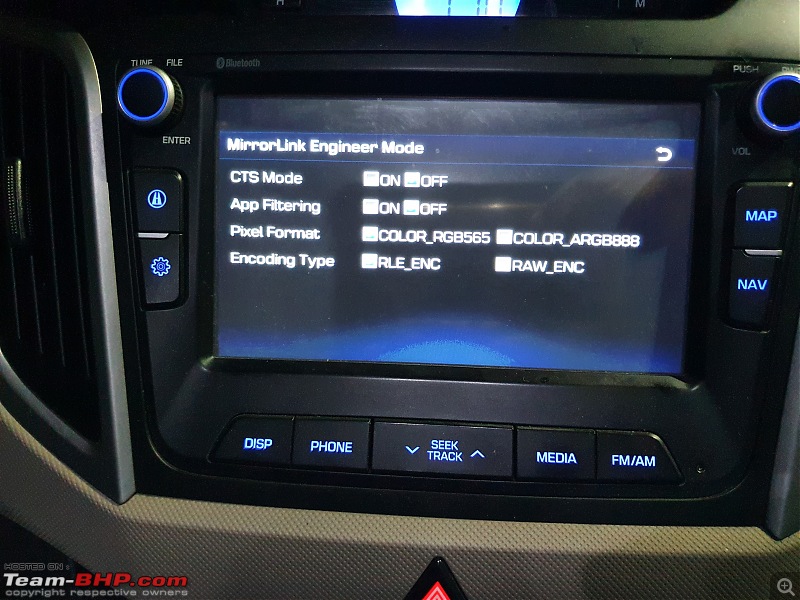

5. Even though a Mirrorlink Engineer mode is enabled now, You can't use it until you enable it like shown here :
Any changes made to this menu get reset when system is restarted.
Step-by-step instructions: Updating the Hyundai Creta's Head-Unit software-mirrorlink.jpg
