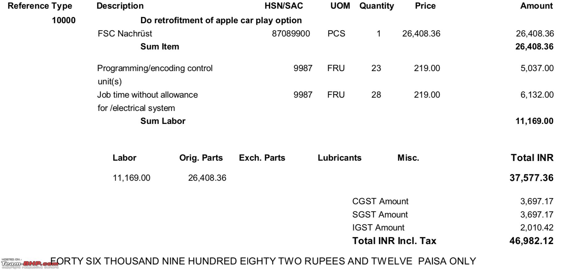

Finally after a long wait, got this installed on my 7 which had the hardware but Carplay was not activated. It costs around 32,000 in case wifi antenna is present else about 4,000 extra. Here's the copy of Invoice that mentions the part number as well some pictures. Spotify sounds so clear and finally, I won't need Mobile holder
Thanks again for this update.
You added the invoice also in your post and it helped me.
I asked my local BMW service station to enable Airplay in my 3GT (I have the same model as @graaja and I even upgraded the suspension to M Sport thanks to his guidance).
First quote I received was for Rs. 46,982.
I called the service advisor and told him that my friend got the same for a lower charge.
He revised the quote downwards to Rs. 38,195.
I am told that it will take around a month to organise the code and then activate it on my car. I wonder why should it take so long, but I shall wait.

No, it can happen same day on any weekdays as the dealership needs to get the vehicle order changed from BMW via their internal software which happens in 15-30 minutes. Speak to someone senior or bring the car to chandigarh, I will get it done by the time you finish your lunch at nearby Elante Mall.
Thanks for the offer.
I think I shall wait now. I have already paid an advance of 30k, on service station's request.
Surprised that different service centres of BMW have different standard operating procedures.
