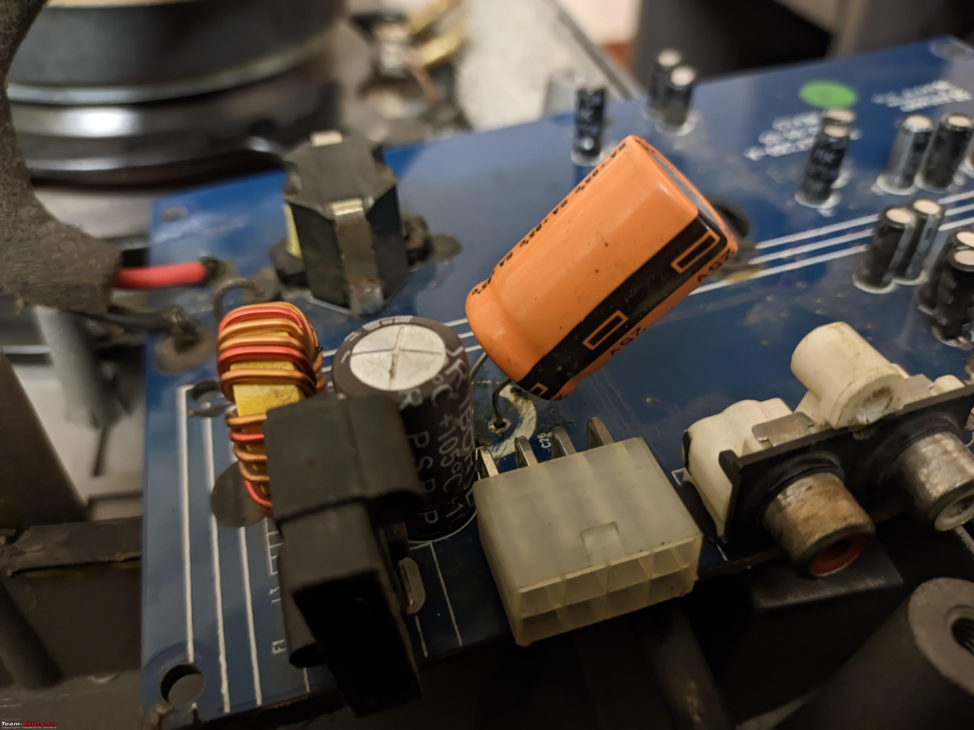

I recently got a used blaupunkt xlf 200a off OLX for my etios. I liked my Sony xs aw8, but 17k was hard to justify. I got the blaupunkt for 5k, and I bought it from a Hyderabad seller. Shipping was another 1k. When it arrived, on testing, it started to smoke. One of the capacitors on the input side had decided to give up it's magic smoke. Got it replaced myself.
The vertical capacitor on the left had vented. You can see the it had already been repaired once before. The orange keltron cap is obviously non original

Old and new caps. 16v is very close to the margin of safety. Car voltages can go up to 13-14v. Replaced it with a 25v part
New capacitor installed. Height was a constraint and I couldn't fit anything taller than 25mm. Else I would have put something bigger.
Interior shot. Looks like a class d amp. No heatsinks for the output devices . The driver is a 0.6 ohm unit so it doesn't need any elaborate voltage boosting circuitry you would need to get 150w out of a 4 ohm sub
