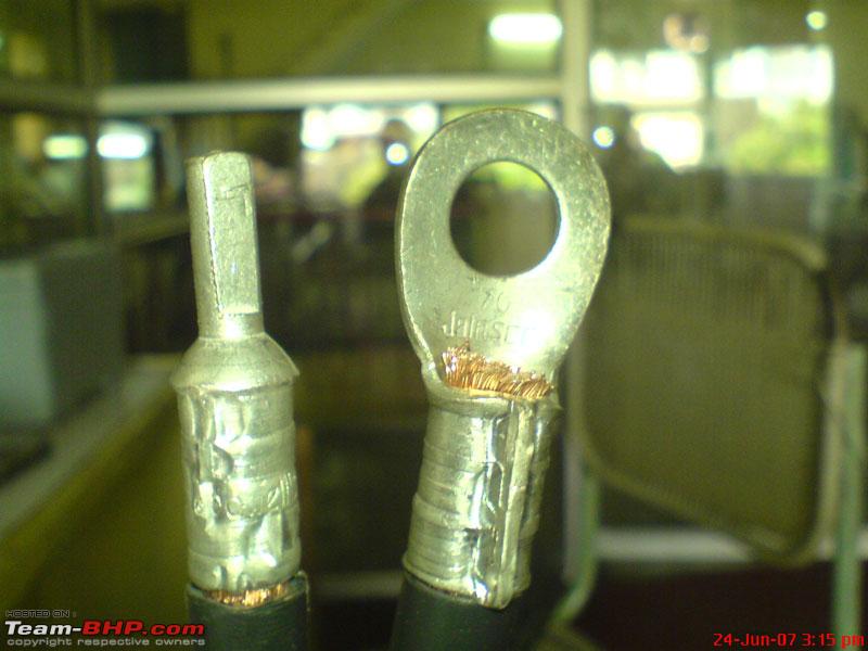

Do not know of fuse holder but you can get thimbles from a good electrical shop from where you will be buying the wire. Here is a photo of the same which has hole and pin type thimble.
You will need hole one for the ground to the chassis like seat mounting bolt. And one for the battery terminal. For the pin type it will go at the amp end.
Take a print out and show it to the shop keeper.

Thanked: 564 Times
Hi LBM, do you use a cutting plier to crimp the ends or you have the crimping tool?
Thats some very good information. Also, wont it be better if the multistrand wires end are soldered just a bit at the end, to ensure that the strands do not snap while crimping?
No cutting plier, I use a specifically designed crimping tools for the job.
Ya, soldering the wire is a good thing , but since the thimble are soft , the breakage of copper is quite less.
