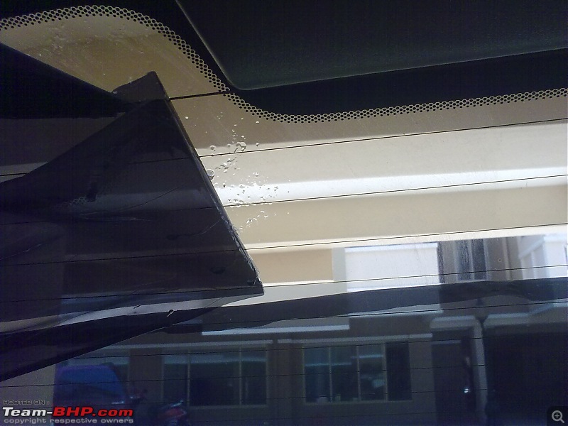

@ Mayank: Instead of starting a new thread, I am using yours to share my experience. Hope you wont mind. I removed my car's sunfilm today. For me it went off very easy. I did carry lots of newspaper with me ( for rear screen). But I noticed that film is coming off very easy from the side windows. Here's how I did it. I used
  • A small knife
  • A soft towel
  • A household glass cleaner (Mr Muscle)
  • Newspaper to clean the glass.
My car was parked in sun. I brought her to shade and started my job. I started with front right window. Got hold of an edge of film using knife. And started pulling down slowly, and sprayed glass cleaner ocassionally. Came off smoothly. Similarily removed all the side window films. Took me 20 mins. Then I went for rear screen with defogger. Luckily it was done in 3 pieces. I had to be very careful not to damage the defogger strips. I slowly started from left and kept moving to right (in line with the defogger strips). I thought going from top to bottom, or vice versa might increase the chances of defogger strips getting damaged. So I did same as Mayank did. Took me about half an hour. I feel the effort and time taken to remove the films is inversely proportional to the quality of sun films. Will take some time to get used to my car sans tints..

I've few queries on removing the sunfilm from the rear windshield of a car with defogger.
1) While peeling off the sun-film, how can I know if I'm damaging the defogger lines or not? Will there be black lines on peeled portion of the sun-film if I'm doing it wrongly?
2) How does the peeled off sun-film layer look like? Will it have alternate band like appearance, with no glue on the portion where the defogger lines were present and glue present on remaining portion?
Thanks in anticipation
As per my observation while removing sunfilms,
1. There will be slight impression/ colour (from the defogger strips). As I mentioned earlier, while pulling out the film, I was careful not to pull the film from up towards down or vice versa. This way, I feel chances are high for damage.
2. Exactly.
I'm quoting mayankk's and nozzlering's posts so that I get my queries answered pretty quick
When I did it, the wet part came off with 0 effort, so no chance there of damaging it.
For the latter half, the film came off, but the tint was left on. That was done very gently with cloth wipes and fingers.
There were indentations on the film where it was on the defogger.
mayankk is offline   (1) Thanks
