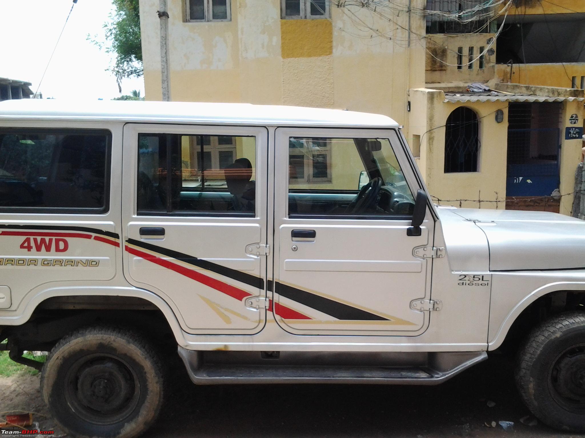

Re: DIY - Removing Sunfilm + what not to do
The guy was holding a BIG can of TVS DOT3 Brake fluid (yellow plastic can with red lid) and applying it liberally on all glasses and let it drip all over the claddings and inners of the door and just spray soap water and use a soft rubber blade to clean out the gum! God save the cars!
I spoke too soon!
Brake fluid, CIF (Household cleaner), news paper, and lots of human muscle power later (approx 1 hour) - this is the result. It works...
