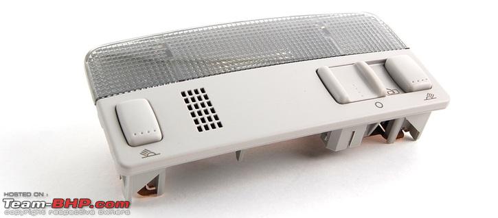

DIY #1: Swapping cabin light:
This is a pretty simple DIY and a relatively inexpensive one for about 2000 INR. Not absolutely essential unlike an arm-rest or a dead pedal which is a must have but this lends an upmarket feel to the interiors of the cabin.
Part No. 3B0 947 105C Y20
Source: AliExpress
Price: 35 USD (Rs. 2260)
Customs duties paid: Nil
Courier: DPEX (proper tracking is available)
Transit time: 6 days
In short, I’ve had a fantastic experience dealing with AliExpress. All my stuff were sourced from a single dealer - I would send him the VW part number or the snap of the item, he would then refer to his factory and he would promptly send a response with the final cost inclusive of the shipping charges via DPEX. The consignments were packed with several bubble wraps/PU wrap, then placed in a box and shipped. No items were damaged during transit.

1. Does the light have the option to turn on while door open? In the product photos, I dont see a door open option in the switch.
Yep. 2 modes of turning the light on - door open or ON.

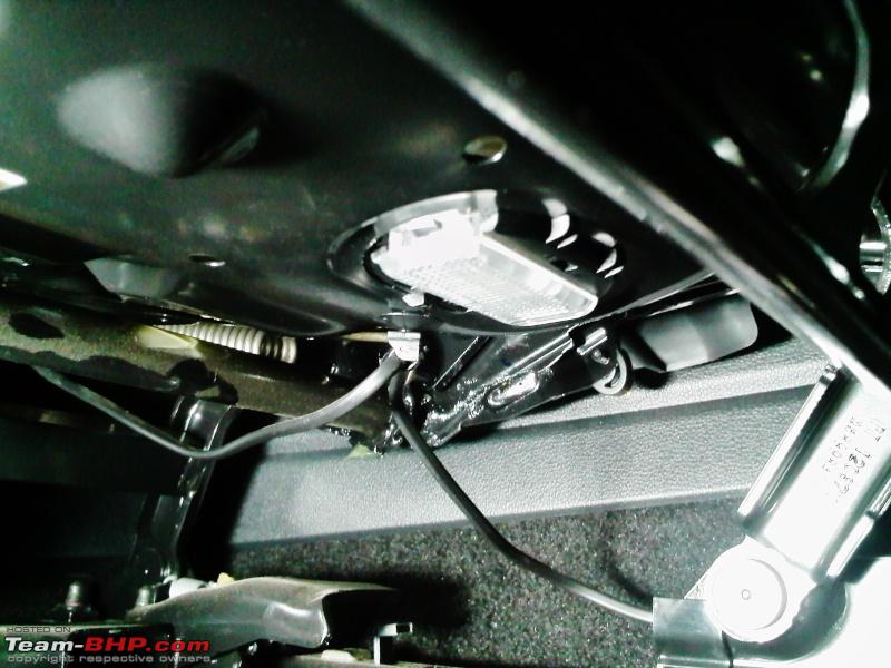

I have got the 2015 polo, which has the front footwell lights. I need to put the ones in the rear, below the front seats like you have done. In such a case, how do you suggest I go ahead with doing this.
We don't have the slots/cavities for the footwell lights on the front seats' bottom area whereas the overseas models get them. I've used a couple of zip ties to tie them up with the metal rods.
This is how it fits elsewhere:
VW Polo DIY: Upgrading cabin light, headlight switch & installing footwell lights-2510.jpg
VW Polo DIY: Upgrading cabin light, headlight switch & installing footwell lights-2610.jpg
(Source: Fernando's Polo from Spain; uk-polos.net)
Understood the placement below the seats with cable ties, but since I already have 2 lights in the front, would the harness that I have to order from AliExpress be different? Also as per my understanding I would not need the 20SWG cable, as I just need to tap the same from the existing front lights. Correct me if required.
Yes, that's correct. You need to connect the additional 2 lights in parallel to these. Check out W9 and W10 from the schematic here. They are the footwell lights for the front area.
