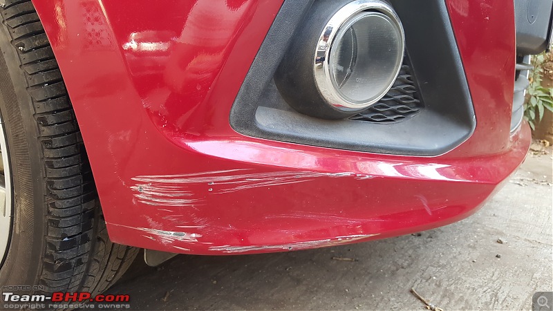

I now curse myself for opening this thread. Unfortunately, Hit and run
Two girls crashed into my car, and ran away before I could even realise what had happened.
DIY: Fixing a scraped / scratched bumper-1.jpg
On the way back home today, just as I entered our area, there is a signal that I have to take right in. The signal displayed green only for going straight and I was on the right lane. As the right signal was red hence we had to come to a halt. As a habit, I glance the IRVM to check if anyone was tailgating me. I saw two young girls riding an access behind me. As I watched them come closer I also braked to a stop. However that lady was too busy talking to the girl behind her and also once she realized I had stopped, she tried to switch to the left lane. A superbike the access is not, it failed to respond to rider inputs and brushed against the bumper.
I am not sure how, but the access just disappeared from my sight, as they had the signal for going straight or I was too busy trying to see what had happened through the RVMs. Need to check dashcam footage to see the two pretty women who had the potential to set me back by a few grand . By the sound of impact I thought I needed a new rear lamp and a bumper.
Work begins tomorrow. This time a little more into detail.

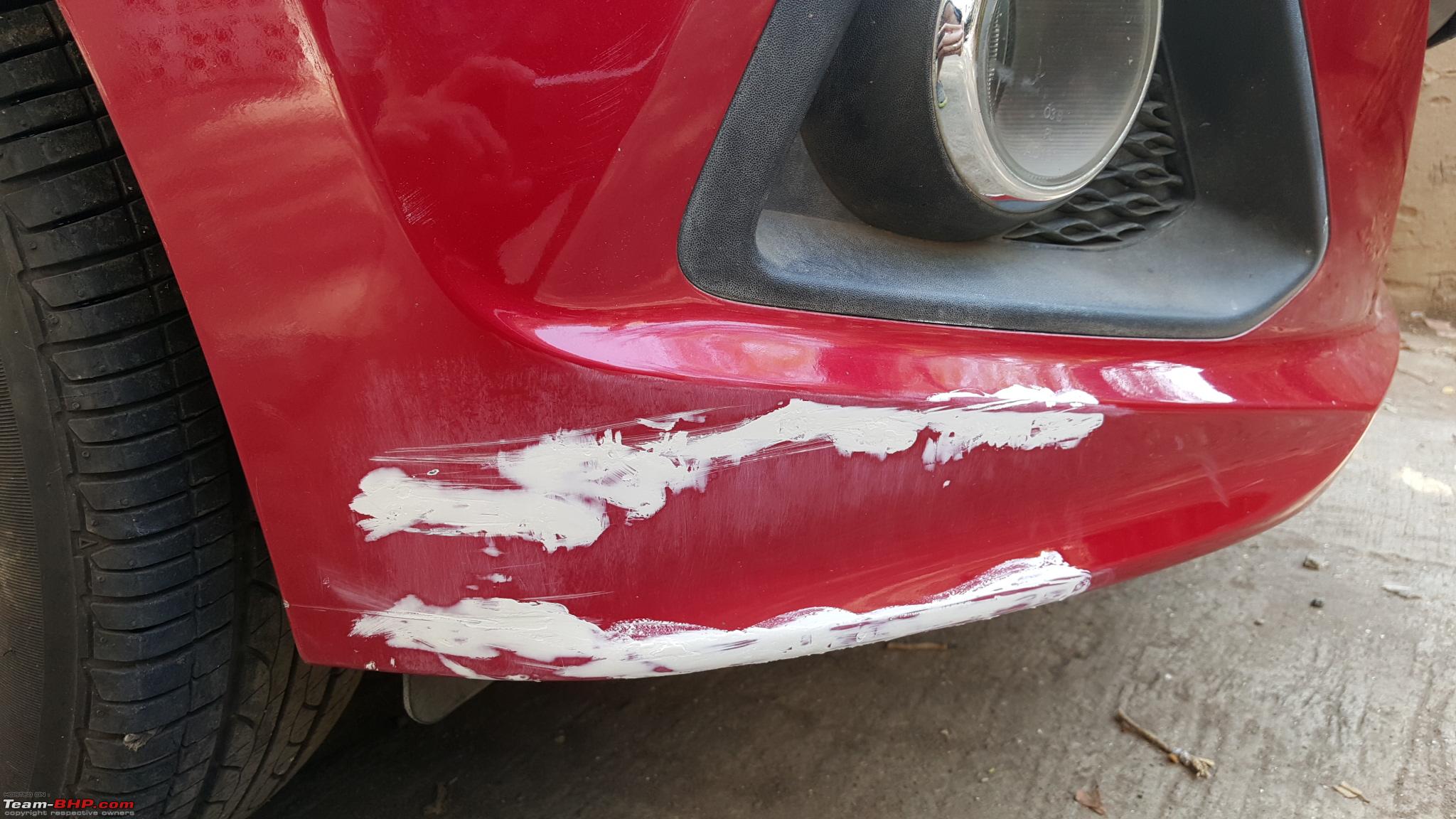

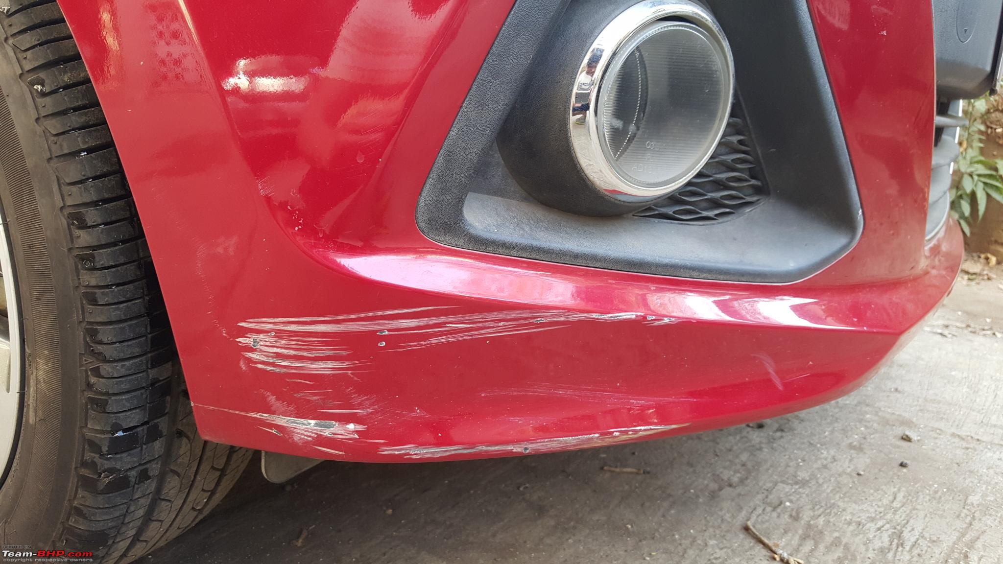

Firstly, thanks a lot @audioholic for introducing me to com-paint through this well written thread. I decided to go ahead and try it out on my Hyundai Xcent and wanted to pen down my experience in a few points.
1) I ordered the value kit from the main web site of com-paint (colour was Hyundai Passion Red)
2) Order placed on 18th, shipped on 19th and delivered on 22nd Jan 2016. Packaging was OK and nothing was damaged.
The steps I followed was as follows:
1) Wash the area with water and wipe dry
2) Use EP 2500 and scrub the area. Wet clean with cloth and then wipe dry again
3) Apply the Com-fill and spread using the rubber applicator. Let it dry for 30 mins
4) Use EP 400 (and some water) and scrub the area to remove excess filler and level/smoothen it. Wipe dry and let it rest for 45 mins
5) Use masking tape and newspapers to isolate the area
6) Start spraying thin coats and give 5 mins gap between coats. Repeat till satisfied.
Learnings/tips from my experience:
1) The passion red is NOT an exact match. It is lighter and more fluorescent than the original colour.
2) Do NOT use the Com-merge for anything. I tried it at the edges and it just messed it up and I had to re-touch it. Use com-merge to remove paint from your hands or any other parts of the car where it was accidentally sprayed
3) Resist the urge to spray more in a coat. I had to do 7 coats to get to this.
Overall, in spite of it not being an exact match, I am quite satisfied with the end result. It definitely looks better than the scratches earlier.
