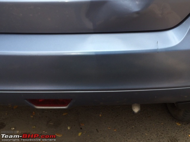

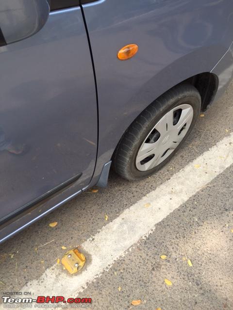

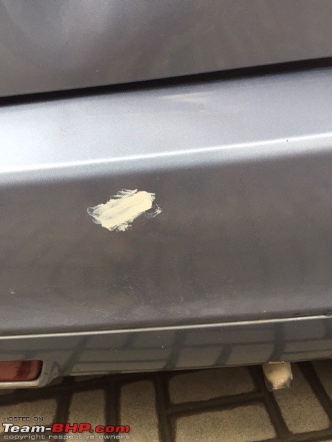

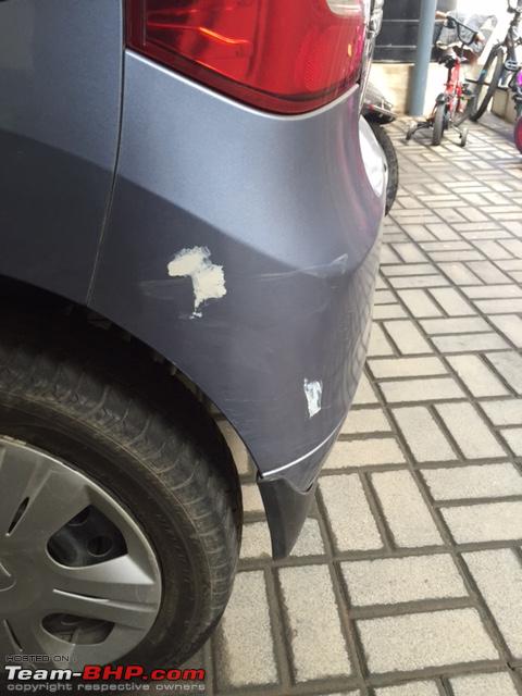

Finished the rear bumper yesterday. Had considerable paint left in the can so painted the front mudflaps and rear ones next since I am thinking of not using it for the body anymore. Hence if anyone wants to use the remaining for any small touch ups you can contact me. I guess it should be fine enough to touch up some small scratches using a brush.
DIY: Fixing a scraped / scratched bumper-img_1805.jpg
DIY: Fixing a scraped / scratched bumper-img_1806.jpg
DIY: Fixing a scraped / scratched bumper-img_1809.jpg
DIY: Fixing a scraped / scratched bumper-img_1813.jpg
DIY: Fixing a scraped / scratched bumper-img_1817.jpg
DIY: Fixing a scraped / scratched bumper-fullsizerender1.jpg
DIY: Fixing a scraped / scratched bumper-img_1857.jpg
The dent on the hatch was an old one which I have left it as it is. Now this is the only eyesore left.

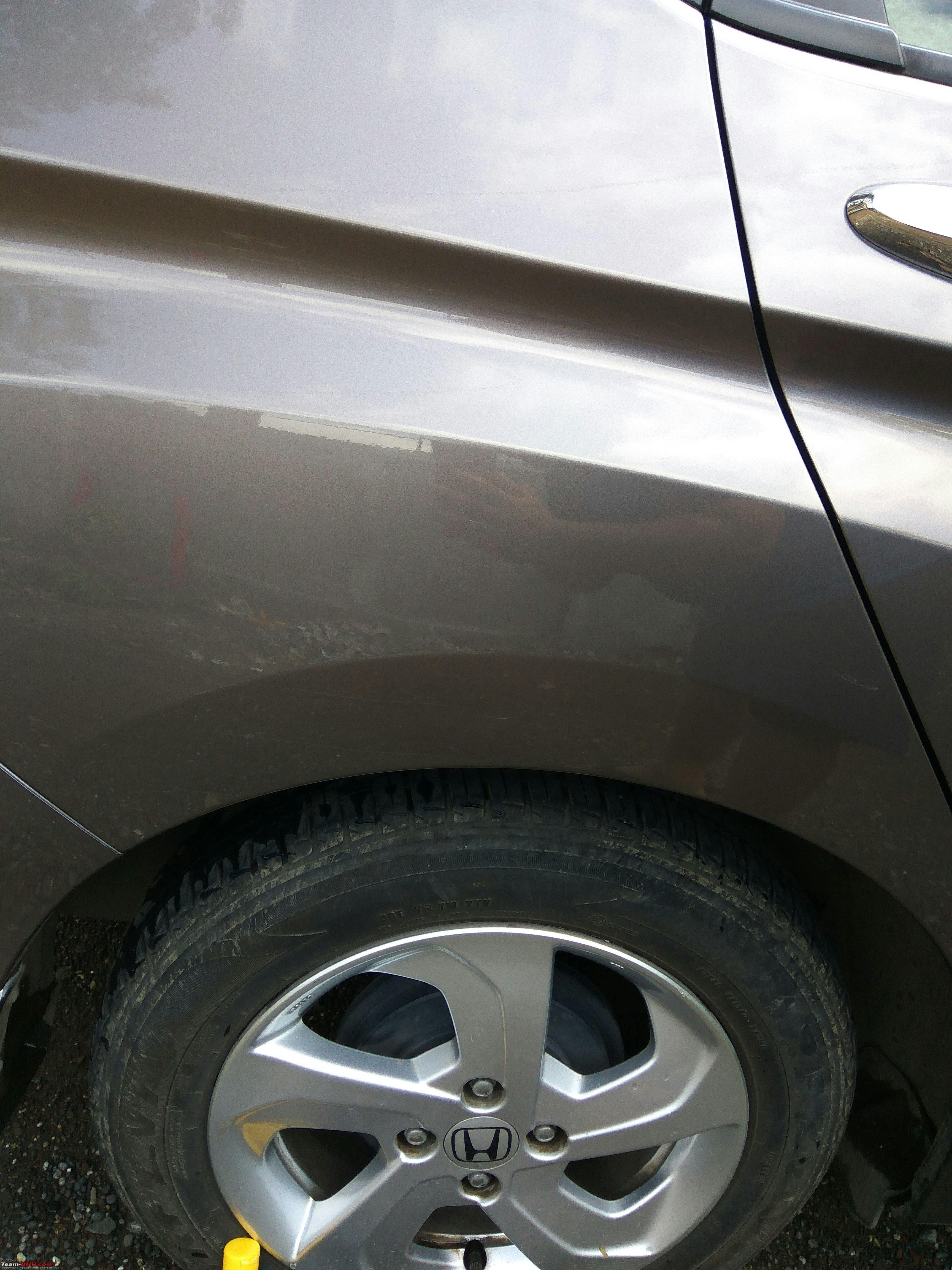

Scratched right rear panel
Folks,
Any suggestions whether this requires repainting or would rubbing and detailing do the trick?
Anyone who can share a good DIY link will help. I tried to search the section but could not get an uncomplicated DIY link.
Thankyou

Re: Scratched right rear panel
Originally Posted by Shashankjk View Post
Folks,
Thankyou
Most of it or the the whole looks like a clear coat scratch to me. It would be a two minute job if a machine is used but if you want to do it by hand, then get a branded rubbing compound and a piece of sponge and work on the area in circular motion. It should go away with a couple of passes over the area. Avoid brands like Motomax, Waxpol and the like and if you are looking for an inexpensive compound then look at 3M finesse or Perfect it. If you want to spend more money then I would suggest Meguiars Ultimate compound. The only problem with these are they are pretty mild and not so aggressive which will require considerable elbow grease. The cheaper ones like Waxpol, Abro, Motomax are very aggressive and can give results in one round of rubbing. But they can do good damage if used in excess which is underside.
To verify if this method will work, first wet the area with water and check if the scratches are visible. You will get the same results with a compound but permanently.

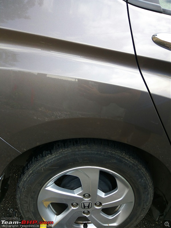

My first DIY. Fixing a scratched side panel
Hello, I tried my first DIY this morning. Went to my local car accessories shop for buying 3M Finesse but unfortunately he didn't have it. He suggested me another compound "Scratch Out - Scartch and Swirl remover". I kind of trust this guy so I decided to give it a shot. (Plus he gave it to me at a discounted rate). I also brought a microfibre cloth. Both costing me a total of 580 bucks.
I followed the steps mentioned.
1)First applied the compound and kept it that way for 10+ minutes.
2)Then rubbed it by a microfibre cloth with about 15-20 passes over it.
Here is the pre DIY picture
http://www.team-bhp.com/forum/showthread.php?p=4214582
Here is the result post DIY.:thumbup:
Thanks for the guidance audioholic and team-bhp. You get the credit for being the mentor for my first DIY.

Re: My first DIY. Fixing a scratched side panel
Glad that it worked well for you. But what was the product you got? Is it by formula 1? I see that the product is quite expensive. Hope it is from a good brand and not a fake one.

Thats good to see. However, when using a compound next time, use a piece pf sponge instead of a microfiber cloth. The microfiber cloth will absorb the compound and will get spoilt. The sponge on the other hand is ideal for use with compound and will hold the compound until it diminishes. You can later just dust it off.
