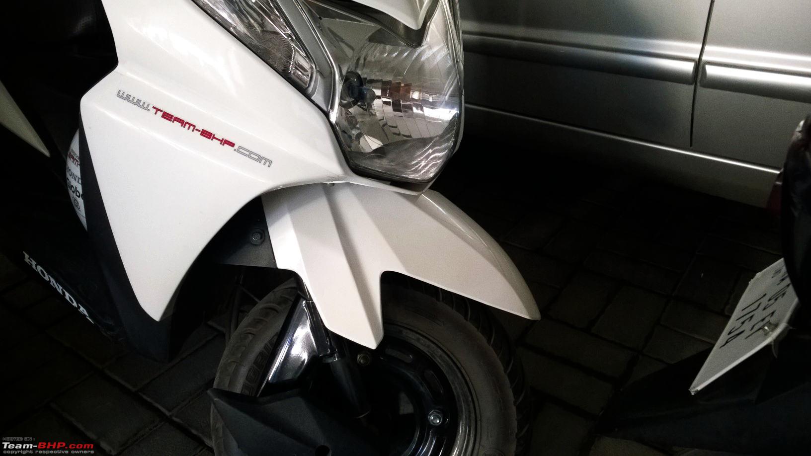

I had this same thought that too having a pearl metallic white finish. I have to give this painter full marks for this job he did:
Before:
After two coats of base metallic white:
After the pearl metallic clear coat
Note that ONLY the plane containing the scratch was painted and not the side itself. I wanted the paint to cover as less area as possible. Paid him 250 for this one. Even the metallic particles are the same size and they reflect evenly with the original paint.
Very neat job! Can you please share where it was done? I would like to get my car bumper scratch painted.
