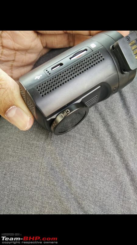

Hi A4anurag, very nice DIY tutorial and a nice camera as well.
I feel you are not using the CPL filter properly. When used correctly CPL filter is able to cut down dashboard reflections almost completely depending on the angle of the sun. Your results should be something like below:
Originally Posted by drivebyfire View Post
quoted my own post above from here
What you are getting is:
Without CPL Filter - Glare from dashboard
Removed oversized link
With CPL Filter - Slight reduction in glare
"removed oversized link"
As far as I can see there is hardly any reduction in dashboard reflections.
You have to rotate the CPL filter to the point where you see that the dashboard reflections off the windshields either disappear or are at their minimum. You will get best results when the the angle of the sun is 90 degrees to angle of you camera. That is if your car is angled such that sun is either coming in from your right window or left window.
The dot that you show in the following image:
CPL Filter mounted and set at the required position for best results
is not for best result of CPL filter but its just for reference, so if you were to move the position of the camera (say if you had suction cup mount) then every time you wont have to re-adjust CPL filter position, you can simply remember the relative position of dots and adjust CPL filter for best result instantly without looking at the video.
CPL filter works both ways - it can eliminate glare and reflections completely whereas in opposite orientation it can maximize glare and reflections as well (as is the case in Punto Evo picture above). So it is important to adjust CPL filter correctly or else you might end up worsening your dashboard reflections.

Sincerely thank you for pointing out the mistake I made all these days by not using the CPL Filter as it should and was mistaken that the dot on the body and one in the first must match for best results.
Went out today and adjusted the CPL Filter and was shocked by the results.
Here's the images:
Before adjustment:
After adjustment:
Before adjustment - Direct sunlight
After adjustment - Direct sunlight
Initial setting of CPL Filter
Current setting of CPL Filter
I am very happy with the results. Thanks once again for pointing out my mistake.

Amazing results - just as I expected. CPL filters really work like magic, I consider it literally the best accessory I ever bought for my DSLR.
It is particularly useful for dashcams and as you show the dashboard reflections are close to gone during day time. At some angles of the light the reflections will be reduced to absolute 0%.
You will find that CPL filter will be just as effective during night time as well, because maximum reflection is caused when car passes under a street light. At that time the reflected light coming from dashboard is at 90 degrees to CPL filter which means that the filter will reduce reflections close to 100%.
Provision of CPL filter is a huge USP of the Mini 0806 which often goes unnoticed as not many people know the utility of CPL filters. I guess this just makes a very competent camera even better.
