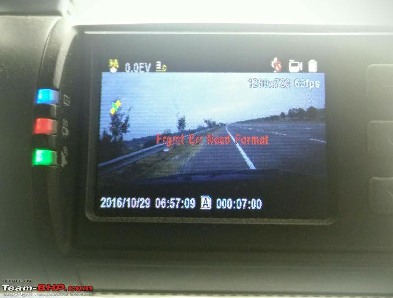

FIRST ISSUE SINCE INSTALL
While driving three days back, the dashcam stops recording and throws an error that read "Frgmt Err Need Format"
Switched the unit OFF and restarted it to see if the issue solves or no. Sadly it didn't. After 5 minutes, the error appears again.
As it was displaying, 'Need Format', I did go ahead and format the card. The error hadn't appeared since then. Have driven over 300 kms so far.
Any reason what the issue could be?

I received this error with my Mini a few times when it was in use. This is due to continuous overwriting and the employed space prioritisation technique (if compared to HDD's and SSD's) that leads to data fragmentation over a period of time, only a format resolves it. It's recommended to format the card while it's in the camera at least once a month to refresh the partition tables in order to avoid issues.
It could also be a failing card or battery, usually media testing utilities like H2testw will not tell you explicitly that the card is about to fail, one would have to compare the current read & write speeds to when the card was new. Test the battery by checking how long it records without power on a full charge.
I've read that you use a Samsung card but towards general awareness, one should avoid the red and grey Sandisk Ultra cards for dash cam use as they have a tendency to go into read-only mode on encountering an error, and that's the end of the card. Best cards for dash cams are MLC based, Transcend and Lexar being the preferred choices.
I do the in-dashcam formatting weekly or biweekly.
I'll check this technically.
But IIRC it hardly has any power on battery.

Not trying to scare you but in case it does not hold charge, usually it's a dying or puffed battery that needs replacing. Also the power supply and current/voltage management being inherently flaky on these doesn't help if the battery has gone bad thus leading to other errors and issues.
Also if you're interested in bumping up the video quality through higher bitrates, check out the below linked modified firmware.
http://mini0806.com/1/post/2015/05/0...e-version.html
