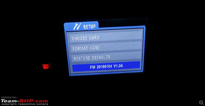

As I had initially told that the time zone setting is not for the 30 minutes and it allows only full hours to be selected, the website just has received an update (May 2016) with the issues addressed.
2016.5.07 - The one I installed!
  1. Added half time zone for special country
  2. Updated firmware time from Jan.04.V06 (Apr.26)
2016.4.27
  1. Manual set to card A, but return to B after reboot - solved
  2. Added "reset setting" after firmware upgrading, suggest to reset
  3. Power on with low battery, the camera will alarm long time and not record - solved
  4. If LOW SPEED CARD, camera stop recording - change to record again after buffer
  5. When card full, can't switch to another card - improved
  6. Change default player to RV
RESULT:
I took a chance and updated but it isn't working still.
Firmware - Old - Jan, 2016
