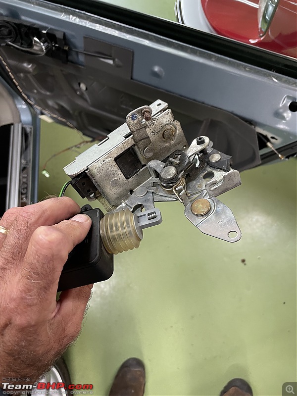

Yesterday I worked on the rear passenger door of the Jaguar. it could not be opened from the inside.
When something like this happens, before taking anything apart there are usually a couple of things you can do to check what might be the cause. First of all, do you feel any resistance at all when pulling the handle? double check the child lock is in the off position. Also, check if the door is properly unlocked. Especially, if you have actuated door latches, make sure the little pin indication open/close door is in the fully open position. Does the outside handle still work
In my case it was very clear that there was zero resistance when pulling the door handle on the inside. Everything else worked fine.
My Car Hobby: Jaguar XJR, Mercedes W123, Alfa Romeo Spider, Jeep Cherokee & Mini One-img_8272.jpeg
Which suggests a problem with either the linkage between the handle and the lock mechanism or the lock mechanism itself. Either way, it means the door card has to come off.

It took me some 2,5 hours of fiddling before I had the lock mechanism out. I am holding it by the electro-mechanical actuator for the lock.
My Car Hobby: Jaguar XJR, Mercedes W123, Alfa Romeo Spider, Jeep Cherokee & Mini One-img_8283.jpeg
My Car Hobby: Jaguar XJR, Mercedes W123, Alfa Romeo Spider, Jeep Cherokee & Mini One-img_8284.jpeg

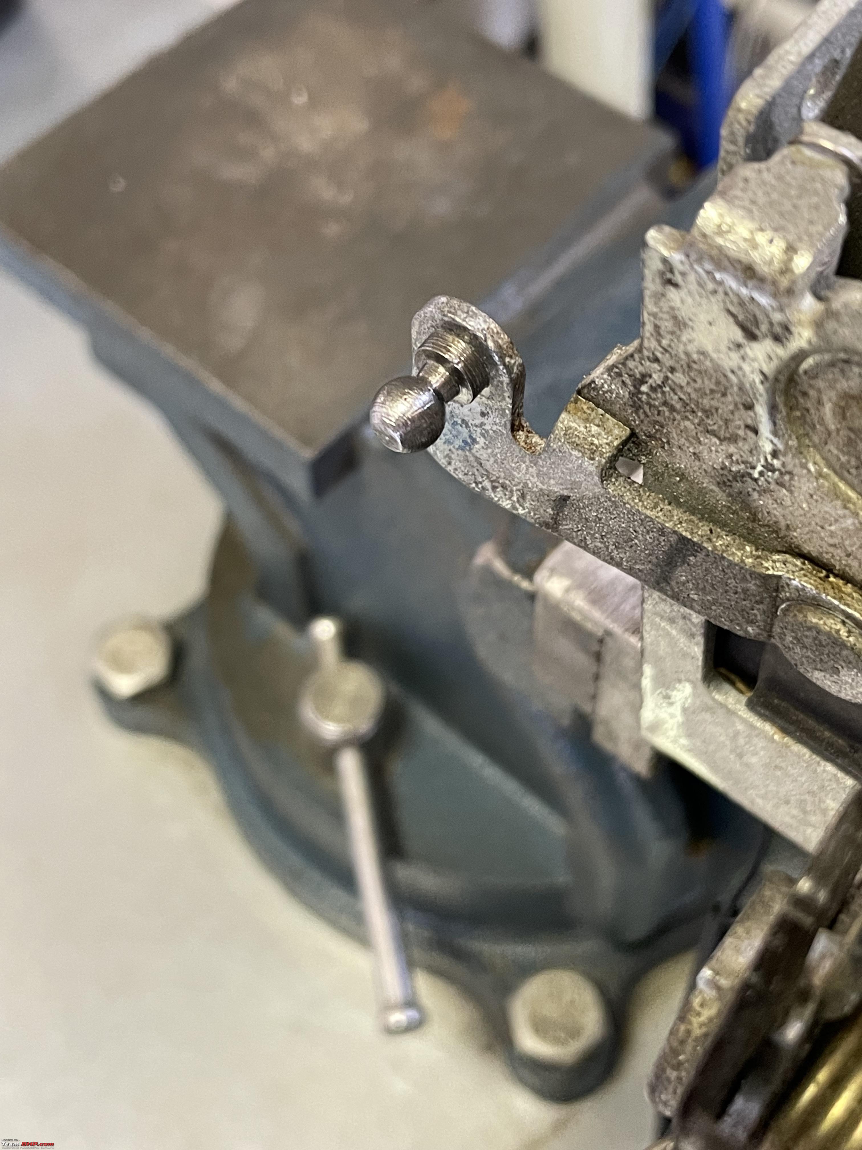

Here you can see how I managed to get that blasted connecting rod off, by slipping the ends of long nose plier under it, whilst it was still in the door.
My Car Hobby: Jaguar XJR, Mercedes W123, Alfa Romeo Spider, Jeep Cherokee & Mini One-img_8288.jpeg
