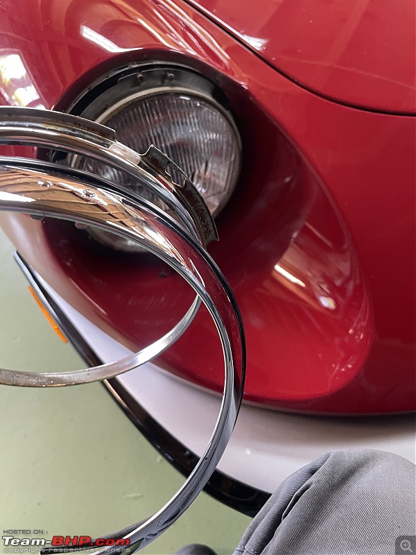

Nothing, so I took the headlight unit apart to check the bulb.
My Car Hobby: Jaguar XJR, Mercedes W123, Alfa Romeo Spider, Jeep Cherokee & Mini One-img_6821.jpeg

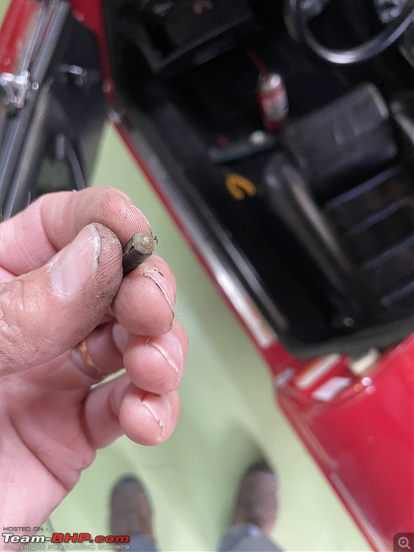

The bulb was fine, I checked I got 12VDC on the connector, for both the dipped and the main beam.
So I decided to check the fuses a bit better by removing them. You can see that the fuse is not popped, whilst still in the fuse holder.
But with the fuse out of the fuse holder, it became immediately apparent what the problem was. Terrible corrosion of the fuse, on both ends! Cleaned it and all problems were gone!!
