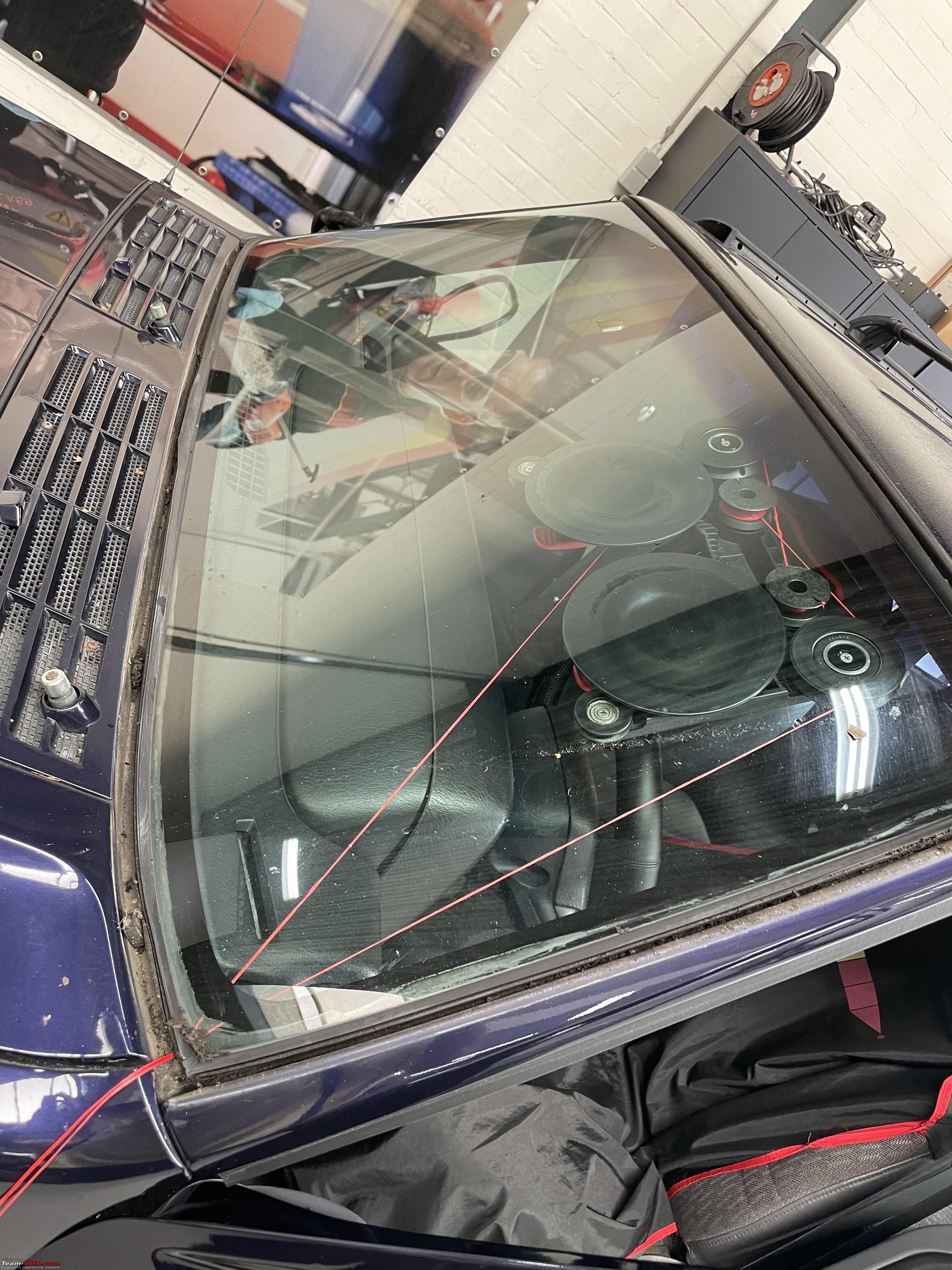

The next part was really impressive. I had not seen this before. As with most cars, the window is glued/kitted into the window frame, i.e. into the chassis. Getting it out can be quite a challenge.
These guys, being the ultimate professionals, (replacing windows is all they do) had this very nifty little tool. It is placed on the inside of the window.
My Car Hobby: Jaguar XJR, Mercedes W123, Alfa Romeo Spider, Jeep Cherokee & Mini One-img_3313.jpeg
It consists of several drums with very strong, thin wire and gears to wind the wire in. The wire is then stretched alongside the outside skirt of the window.
My Car Hobby: Jaguar XJR, Mercedes W123, Alfa Romeo Spider, Jeep Cherokee & Mini One-img_3312.jpeg
With everything set up properly, they take an electric drill to power this nifty device and the wire cuts through the old glue/kit like a warm knife through butter. All done in 90 seconds!!
