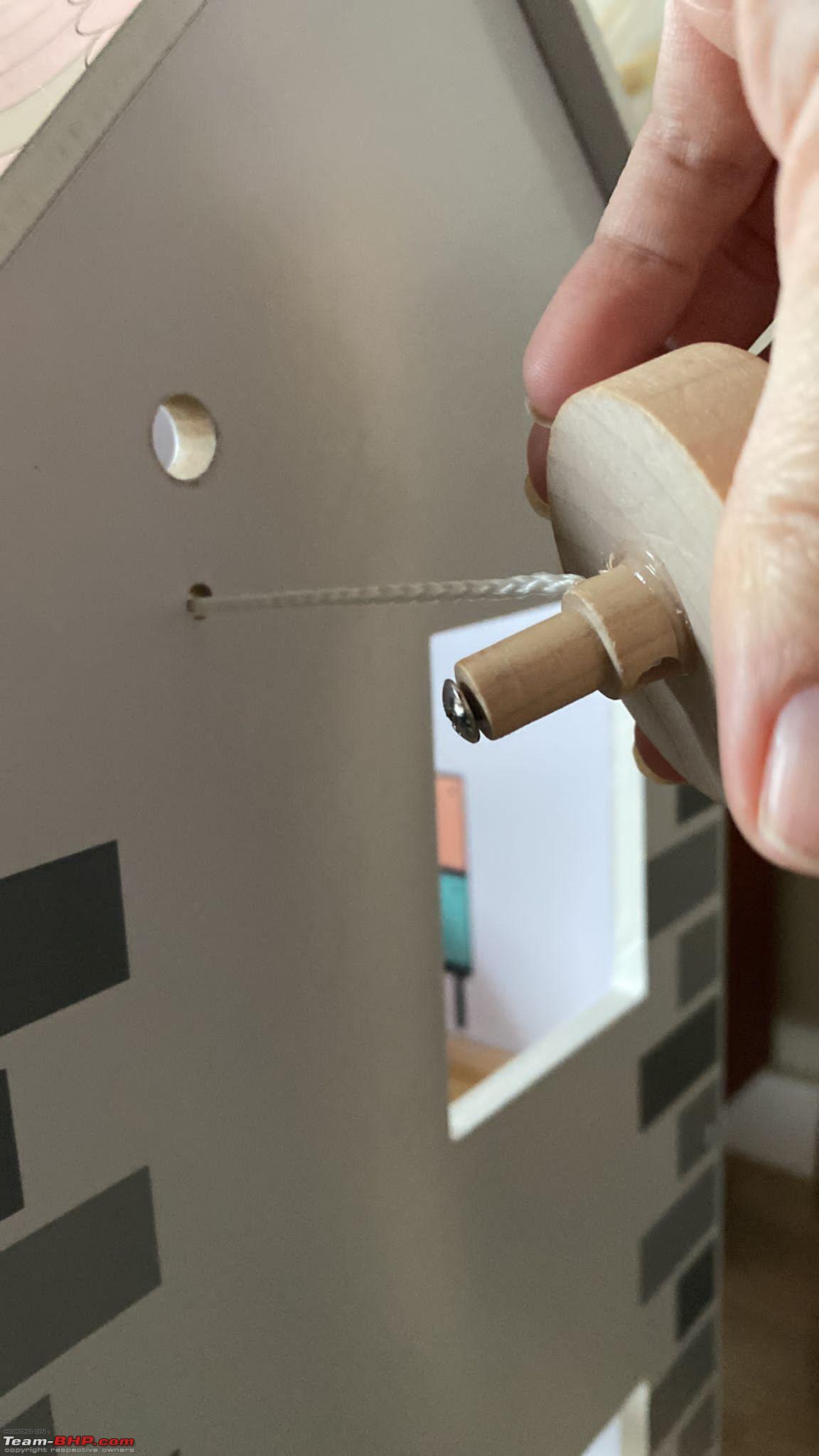

Strictly speaking not really a car topic, but it involved a lot of fiddling and use of my lathe and mini mill; Our granddaughter Bella was given a doll’s house by her “soma” (the mother of our grandson). It’s gorgeous and she loves it. It even had a little elevator you could operate with a little winch. Unfortunately, the winch broke very quickly.
My Car Hobby: Jaguar XJR, Mercedes W123, Alfa Romeo Spider, Jeep Cherokee & Mini One-97e70047019f43e68ecb2ff2c75a3c77.jpeg
So I made a new one. From brass, steel and aluminium bits offcuts.
My Car Hobby: Jaguar XJR, Mercedes W123, Alfa Romeo Spider, Jeep Cherokee & Mini One-6678fe5036f44adeaf13f8d95597d3ca-2.jpeg
Nice little job, I really need to get going again with the build of my model Scuderia engine.

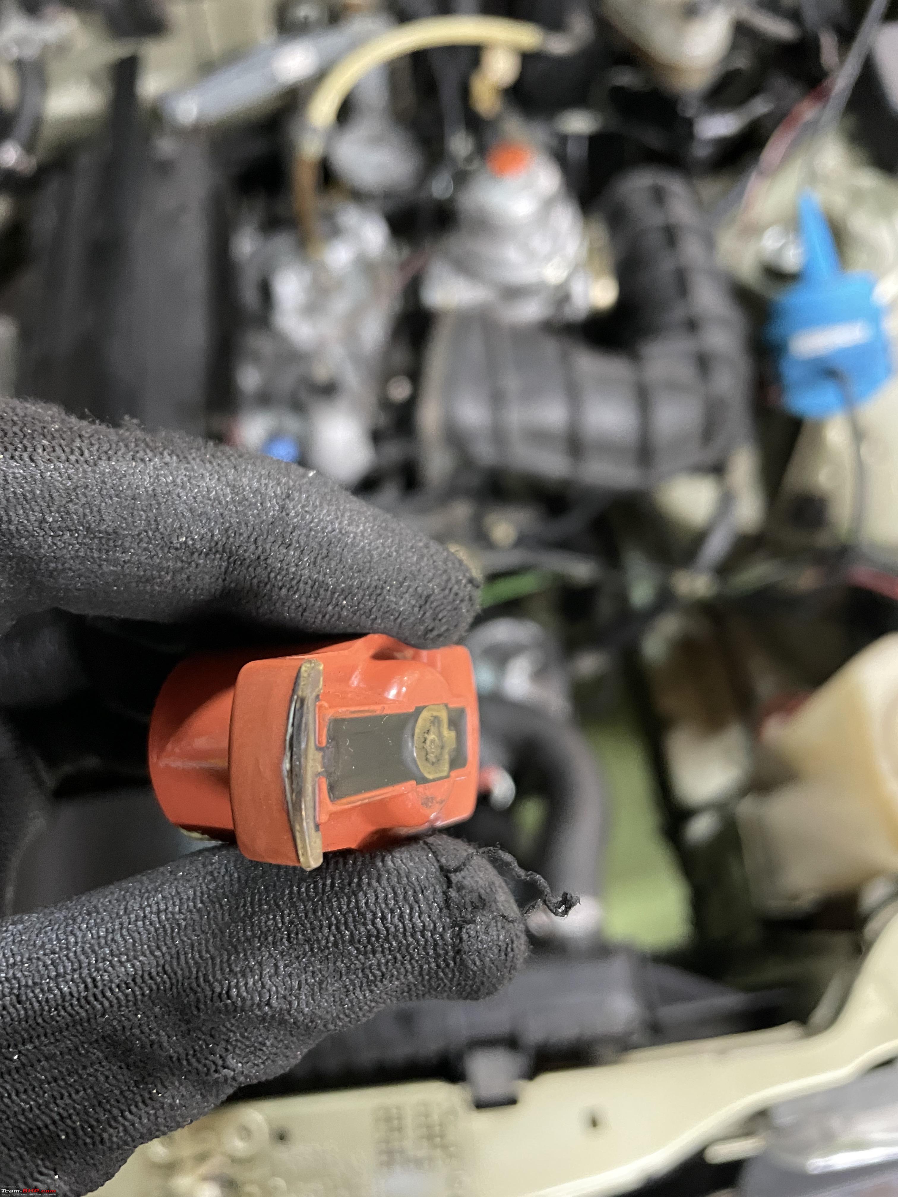

With my W123 having failed its MOT due to way to high CO percentage, it was time to get this sorted. I don’t have the equipment to measure any emissions. Also, tuning these W123 is a bit of a combination of knowledge, experience and a proper Mercedes diagnostic tool.
In the past I used to visit Mercedes specialist Cor de Jong. You can find my earlier visits to him in various earlier posts. So I called Cor, only to find out he had moved home and workshop. He moved to a much nicer and cheaper location only a twenty minute drive from where we live!
So I went to see him first thing Saturday morning.
Cor hooked up the W123 to an emission analyser and his Mercedes diagnostic analyser.
My Car Hobby: Jaguar XJR, Mercedes W123, Alfa Romeo Spider, Jeep Cherokee & Mini One-img_8998.jpeg
My Car Hobby: Jaguar XJR, Mercedes W123, Alfa Romeo Spider, Jeep Cherokee & Mini One-img_8999.jpeg
It took a bit of fiddling and a drive and some more fiddling but Cor managed to get the CO back to just over 2% in the end.
My Car Hobby: Jaguar XJR, Mercedes W123, Alfa Romeo Spider, Jeep Cherokee & Mini One-img_9005.jpeg
Its likely to come down a bit more, after driving some more. High CO means incomplete burning of the fuel, so the engine needs to clean itself a bit. So I will be doing some more Highway driving with it in the weeks to come.
We did notice that the engine does hold back a bit now and then, especially during acceleration. We had the same problem before and Cor managed to minimise it then. But we also felt that it is unusual for the carburettor to have deviated so much from its correct settings. Which is probably an indication that the needle or other bits need replacing.
I am going to see if I can get the correct parts, not so easy these days, and then return to Cor to fit the carburettor parts and tune the ignition some more.
But the W123 is in good enough shape to pass the MOT, so I will call them tomorrow to make an appointment

Checked the rotor too, again not be bad, but I just ordered a new one as well.
