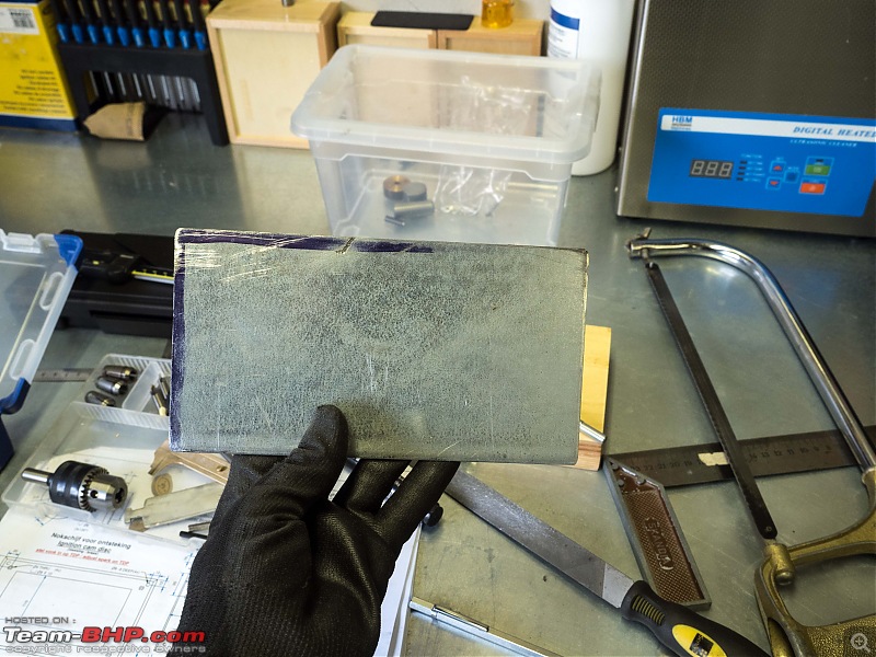

First thing the base plate. I had a piece that was almost the correct size. It is 5mm short, but that is alright. Just had to tighten it up a bit, was a bit rough;. No fancy machinery required. Just a vice, a file and some good old elbow grease

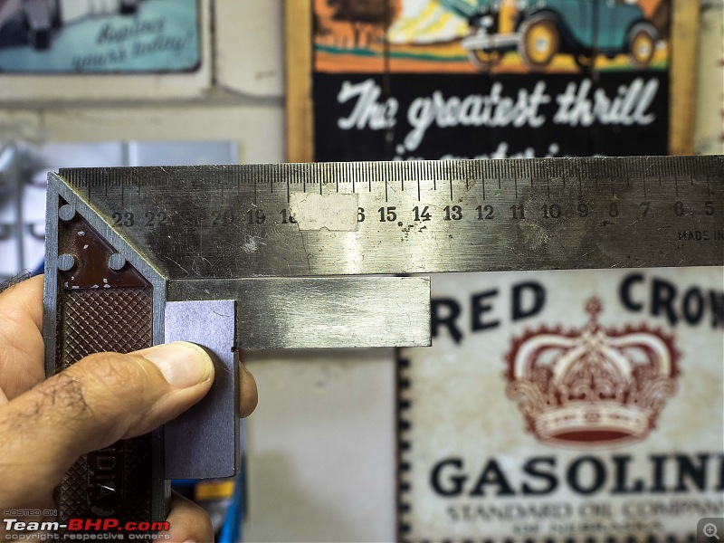

I also discovered a problem with one of my tools. this thing is not at a 90o Angle at all! I did some checking, because I bought this a few months ago and everything else I have is several decades old. But it is indeed the new tool that is buggered!

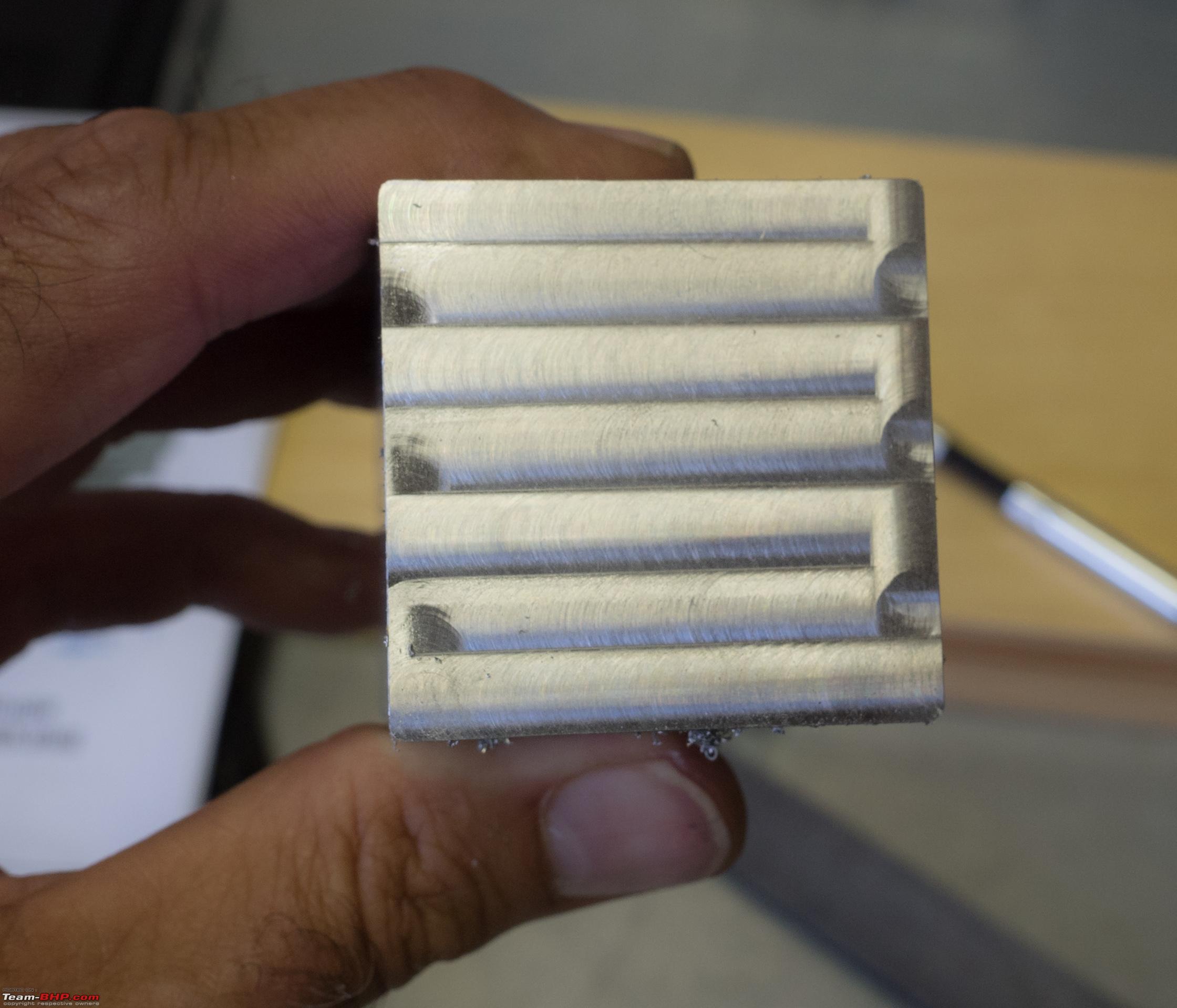

I also started machining the aluminium support for the cilinder. First thing is to bring it to the correct length. I used my mini mill. I am not satisfied with the finish at all. I used different bits (10 and 8 mm), different speeds, left-right, top bottom. But I still end up with a distinct overlap edge of each pass of the cutter.
It’s not much. Afterwards rubbing it on 1200 grid sandpaper caught rid of it quickly, but still.
Not sure what the problem is? any thoughts?
Filing accurately takes a lot of skill!
This I cannot overemphasise - for measurement, layout and marking tools get the best you can afford. In these items the world is awash with junk now. If you go through any of the catalogues you'll find a very wide price difference of seemingly identical items. Ask yourself why. Not everything can be accounted for by 'brand tax', price gouging, or country of manufacture.

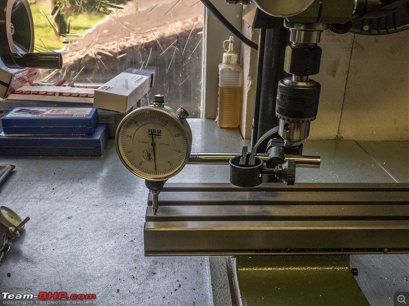

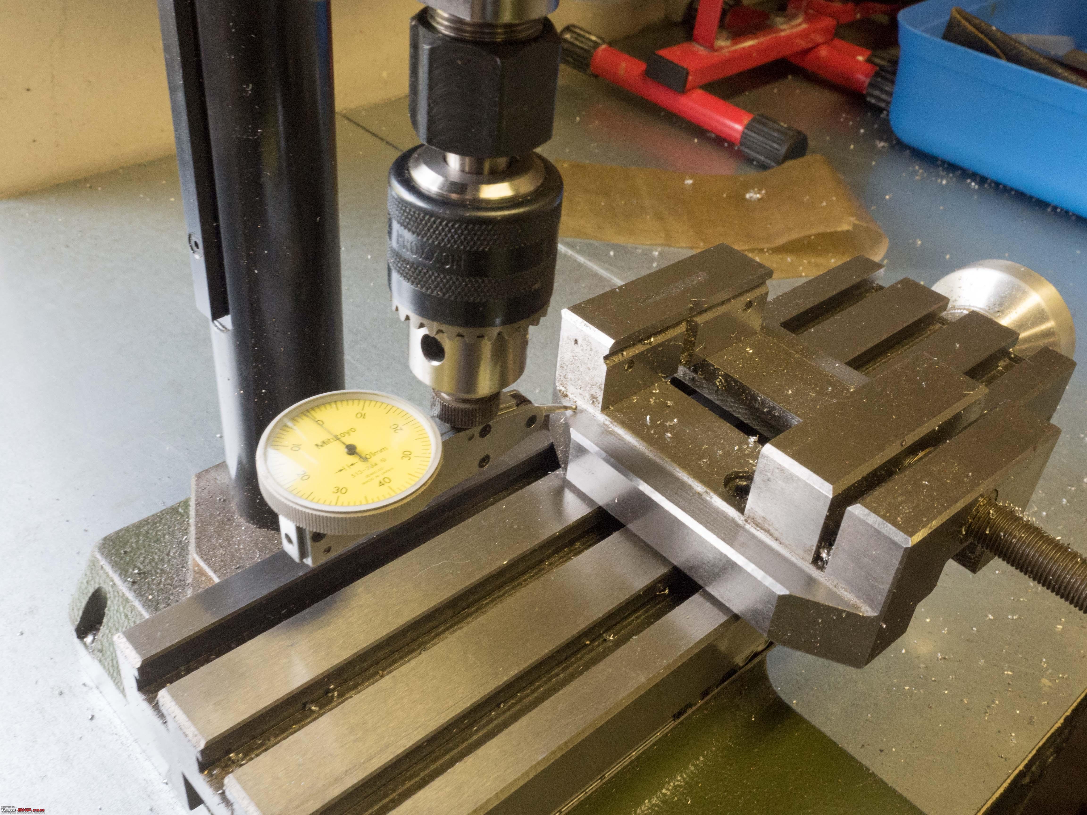

Two things
The milling head is not trammed (squared) properly wrt the bed. Don't know if it is adjustable in your case.
Also start and end outside the workpiece.

The videos are for turret mills because the head is adjustable. Even if you can't adjust the head, it should be checked for squareness.

First thing I did this morning is to check some more video’s from Blondihacks on tramming and squaring.
So I checked mine:
DIY: Metal model engine building UPDATE: build complete (page 16)!-p7180001.jpg
I don’t have parallels. Would you believe HBM has been sold out for weeks/months! So I make do.
DIY: Metal model engine building UPDATE: build complete (page 16)!-p7180003.jpg
Bit of improvisation to get my dial gauge installed, but it worked. I will make a proper attachment for it too.
DIY: Metal model engine building UPDATE: build complete (page 16)!-p7180004.jpg
DIY: Metal model engine building UPDATE: build complete (page 16)!-p7180005.jpg
There was quite a bit of adjustment to be done. The only adjustment I can do on my mill is this very one. Took me a couple of hours. As you tighten the various bolts, everything moves again. But I got it set up very precisely in the end:
It is very difficult to capture these cuts properly. It looks a whole lot better, but it also feels a whole lot better! it shows more, but you can hardly feel that little ledge. Blondihack calls these water chutes.
Tried first time on a piece of spare stock
DIY: Metal model engine building UPDATE: build complete (page 16)!-p7180007.jpg
DIY: Metal model engine building UPDATE: build complete (page 16)!-p7180008.jpg
DIY: Metal model engine building UPDATE: build complete (page 16)!-p7180009.jpg
Next took, redid my cylinder support. Again, difficult to show on the photographs, but the look and feel improved considerable over what happened yesterday.
DIY: Metal model engine building UPDATE: build complete (page 16)!-p7180010.jpg
DIY: Metal model engine building UPDATE: build complete (page 16)!-p7180011.jpg
There is still some difference cutting along the X-axe versus the Y-axe. The Y is better, noticeably so.

Conventional milling is follow milling. Climb milling needs a very rigid setup, and a 0backlash screw. But if your machine can handle it, climb milling is preferred. With the coming of VMCs climb milling became the norm.
Probably because it has a siwelling head your machine is not rigid enough when taking cuts in the x direction.
Tools have different geometries optimised for different purposes. Read up on those. Use the correct one. Doubt if you can use insert + shell + Arbor in your case but Proxxon might have a special solution.

So for now I got myself this one:
Attachment 2032041
Attachment 2032042
The square has a serial number. Which is a good sign. Did you get a calibration certificate mentioning this serial number?
Any indication of where it is made? Europe is supposed to be supplied by its factory in Italy. Rest of the world from China.
I am getting good enough finish to keep going, so I started the second cut on the cilinder support. Careful measuring and marking. I use one of these marker as marking dye. Works really well!
How are you marking? I don't think you have a surface plate.
I can see now that the crank/ flywheel support is machined from solid. In which case might have been a better idea to buy bearings already assembled in pillow cases. Maybe even selfaligning ones. I would.
Cover the T slots, if possible.
I was trying to find something good about Britain. It's tough these days
Wait for Brexit to be fully completed!
Yes, it has a number (00439) but no calibration certificate, nor indication where it is made. These days they also have a facility in Los Angeles, for the USA and South America.
I don’t have a surface plate and I don’t think I will be getting one soon. I use the old trusted technique of putting the measurement in the caliper and running is along the piece! Real terrible I know, but even Blondihacks uses this technique. And contrary to popular technique it has not worn down to tool at all!
Although it is important to get the marking done precisely, you still need to check and recheck when working on the mill I find. I am getting some edge finders though. They look very handy!
If you are halfway serious about metalwork, you will need it.
Can't make out what you are doing.
Aluminium or brass will not wear hardened steel. But precision instruments should not be abused.
Without a precision marked handwheel, or a DRO, IMO not of much use.
