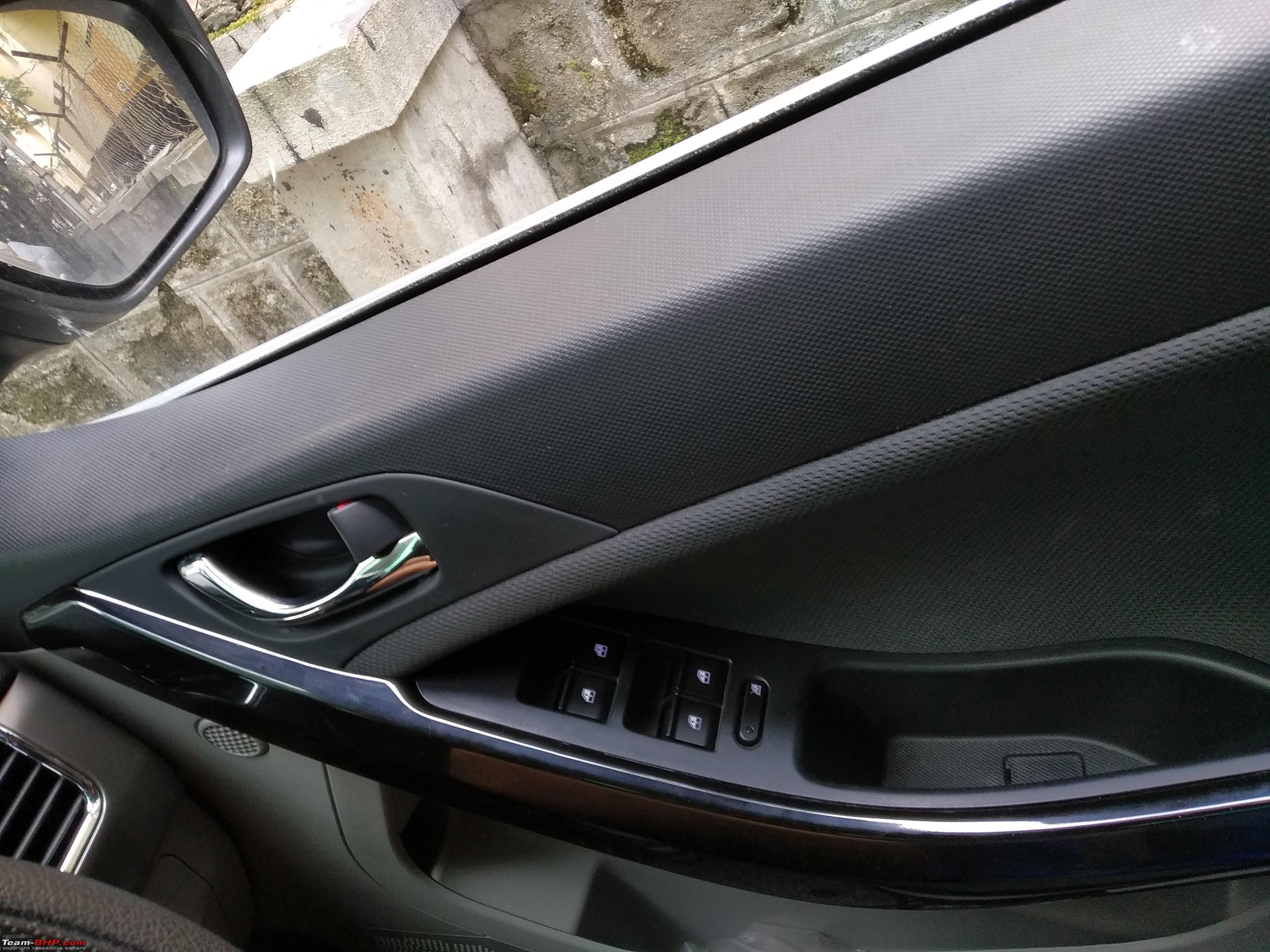

  16. Here is how it looks now. I took the picture during the noon, so the illumination is hardly visible. Sorry about that.
    DIY - Illuminated power window switches in the Nexon & other Tata cars-installfinishedlightson.jpg

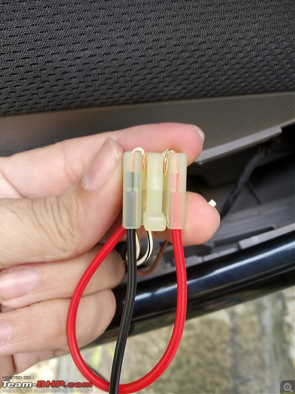

  5. This is a sample of how I have added my +ve LED wire into the existing pin for "UP" in the connector. Do this & click the pin back into position.
    DIY - Illuminated power window switches in the Nexon & other Tata cars-addingwiretopin.jpg

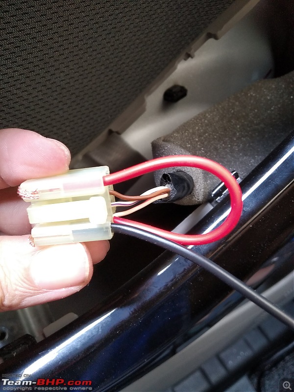

  6. Ensure that no exposed copper part of the wire remains outside the connector. Strip the wire to the correct length to get all covered by the connector housing.
  7. Due to the pandemic, its near impossible to source these little pins to add into the connectors. Hence - I have done it a bit crudely by inserting a stripped end of the wire itself through the connector & folding it away safely in the gaps where the male connector of the switch slides in. The male pin in the switch tightens the grip on the wires & the switch itself also holds it in place. No chance of this ever going loose.
    These 2 wires actually meet the + and - pins of the switch's connector. Note the orientation besides the connector's latch. RED is for +ve and BLACK is for -ve.
    Polarities will matter for the LED to work.
    DIY - Illuminated power window switches in the Nexon & other Tata cars-howtoledpins.jpg
