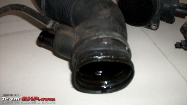

I followed your steps and cleaned the MAF sensor and also throttle intake part and as much as i could do with throttle installed in car due lack of proper tools but, managed to clear the throttle idle adaptation limit reached with it.
Is oil in the intake hose a cause of worry or do i have to replace the intake hose?
DIY : Cleaning your MAF Sensor for Rs 120-dscf0286.jpg
DIY : Cleaning your MAF Sensor for Rs 120-dscf0293.jpg

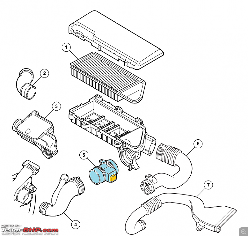

Had an issue with my Figo lacking in engine power/throttle response. Cleaning the air intake setup including the MAF sensor, helped resolve the issue. Posting a picture of the MAF sensor's position for others' reference, who might want to go down the same lane. The part highlighted in blue houses the sensor. The area highlighted in yellow is where a module with wires running from it (probably to the ECU) connected.
Mods: The image is taken from the service manual shared by one of our members in the Service Manuals thread. If sharing the picture here will lead to copyright issues, please delete this post as required.
DIY : Cleaning your MAF Sensor for Rs 120-maf-sensor.png
Is the location the same more or less for the Figo 1.2's MAF? I think it is on the left side of the air filter box.
Is there a manual in the service manual link for the 1.2 which I could follow for a DIY?
tharian is online now
The Service Manual covers both Duratec and DuraTorq engines. I checked the manual and there is no mention of a MAF sensor for the Duratec. There is a T-MAP sensor mentioned though.
