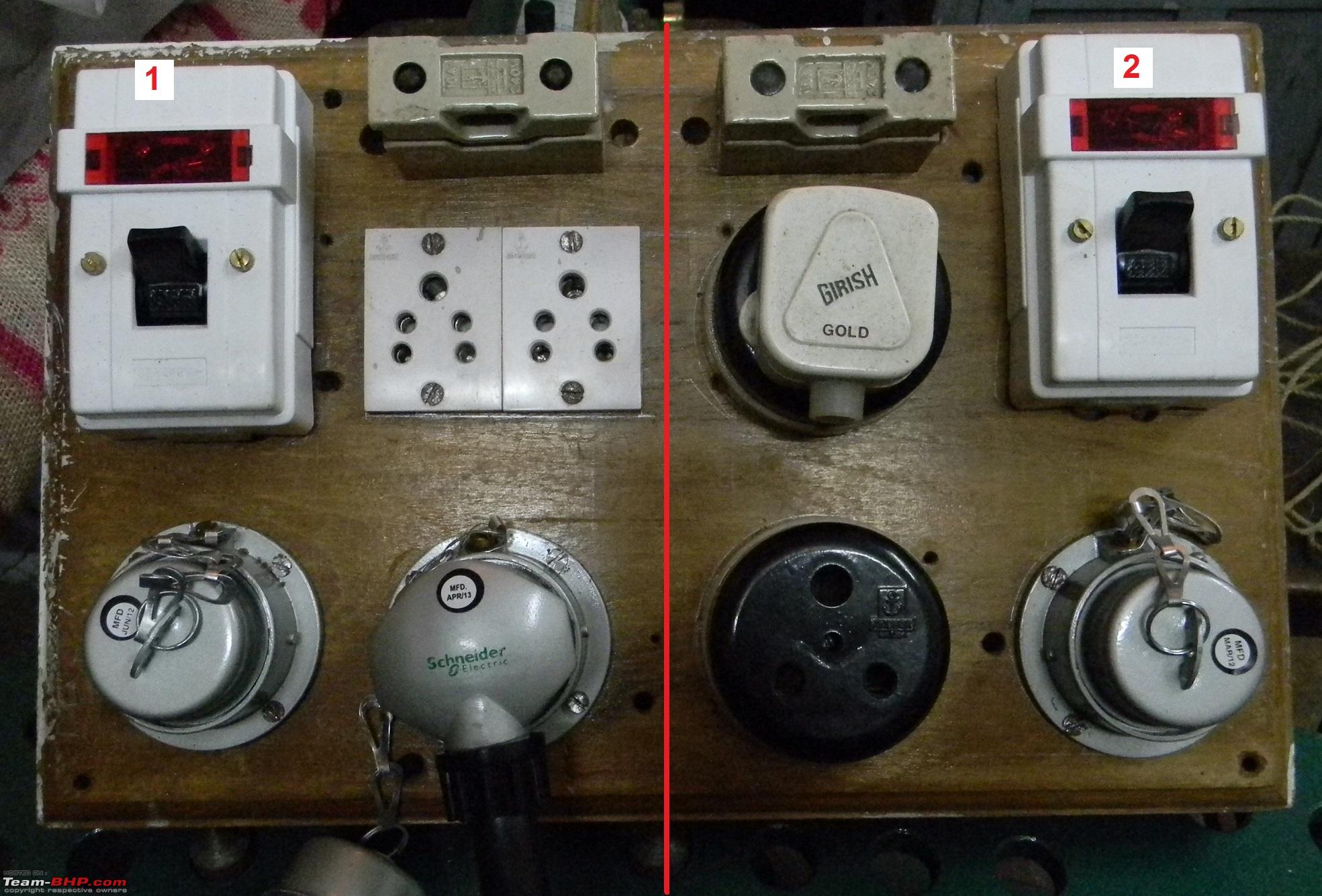

I am doing wiring Job for the workshop. Have constructed a board for equipment use, & while doing it made simple wood drills out of nails, to be used as the screw guide holes. Its done by hammering their ends flat & cutting the heads off.
No its not my original Idea, have learned it from the carpenters
Bit OT but thought worth sharing
This workshop board will be taking care of many appliances at one place, two phase-neutral pairs will be brought in from the source & will feed the two DP switches & they will control the half parts of the board respectively. As there is no other person to use power-tools other than me, appliances will not be run all at a time .. so no overloading issue.
