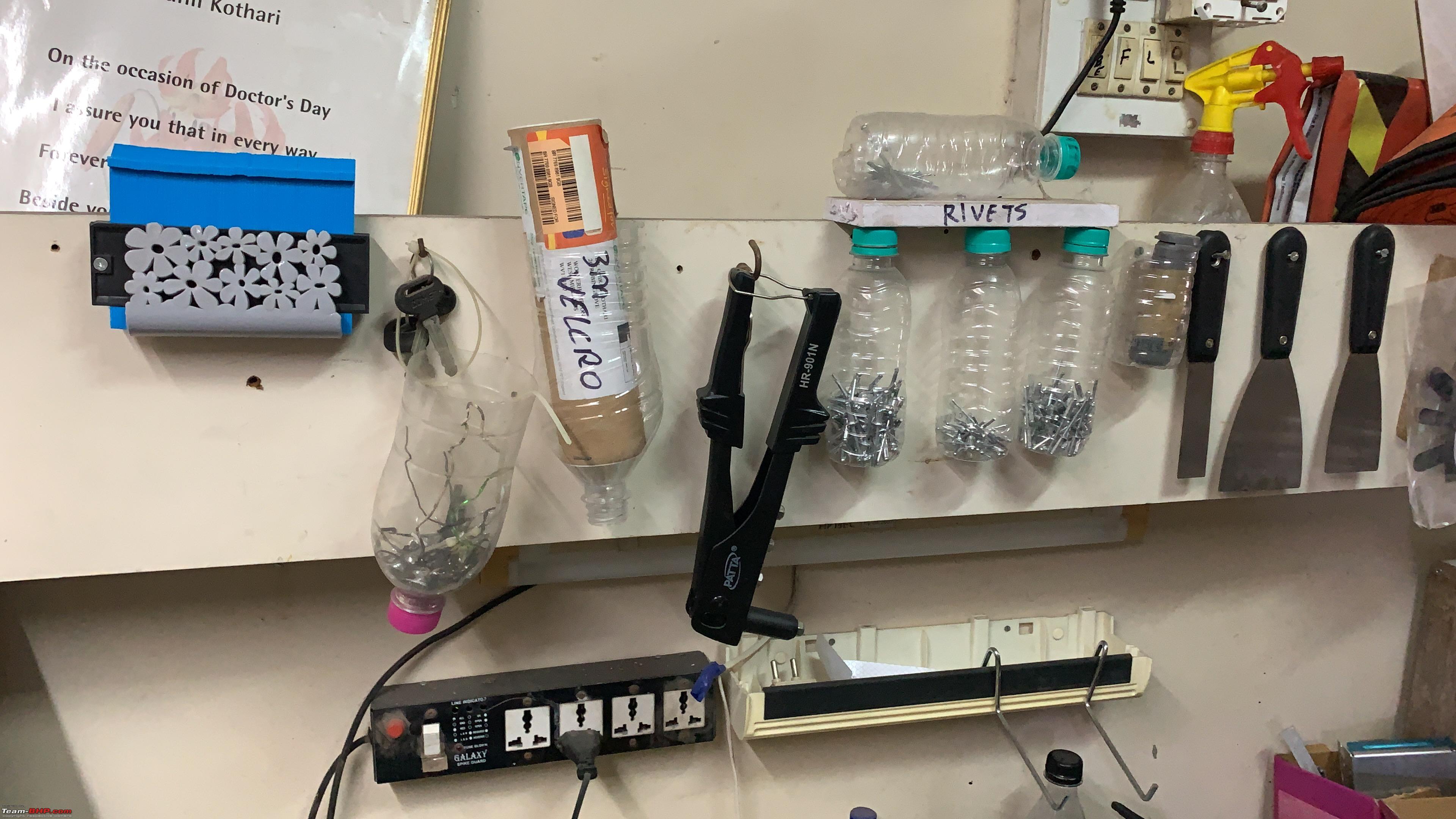

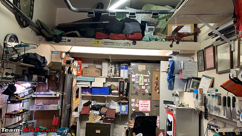

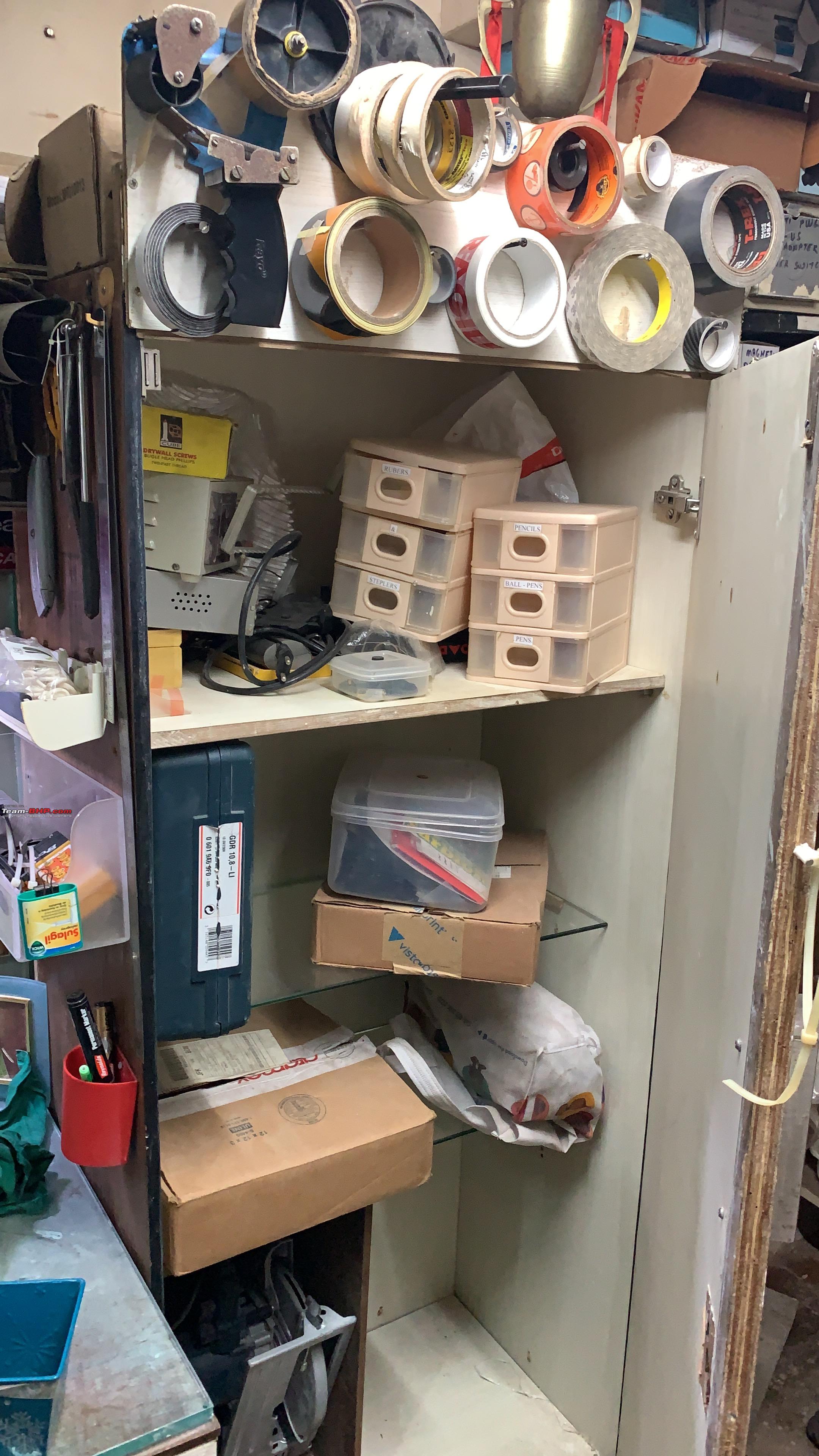

My garage had been quite unorganised!
Started getting it organised. Sorting screws, hanging tools etc.
Atleast the next 7 days of the lockdown I'll be busy!

It looks wonderful. Be careful of too much tidying: you won't be able to find anything afterwards!

What an Idea Tejas ! I mean your 500 ml water bottles arranged in a row with screws etc held by their caps. You have a nice garage there.
Is that a table saw ?
I always wanted a closed garage where I can store my tools. Just the other day I was frantically searching for my circular saw and I misplaced it somewhere. I had to make do with an angle grinder. It is not the right tool for the job I was doing.

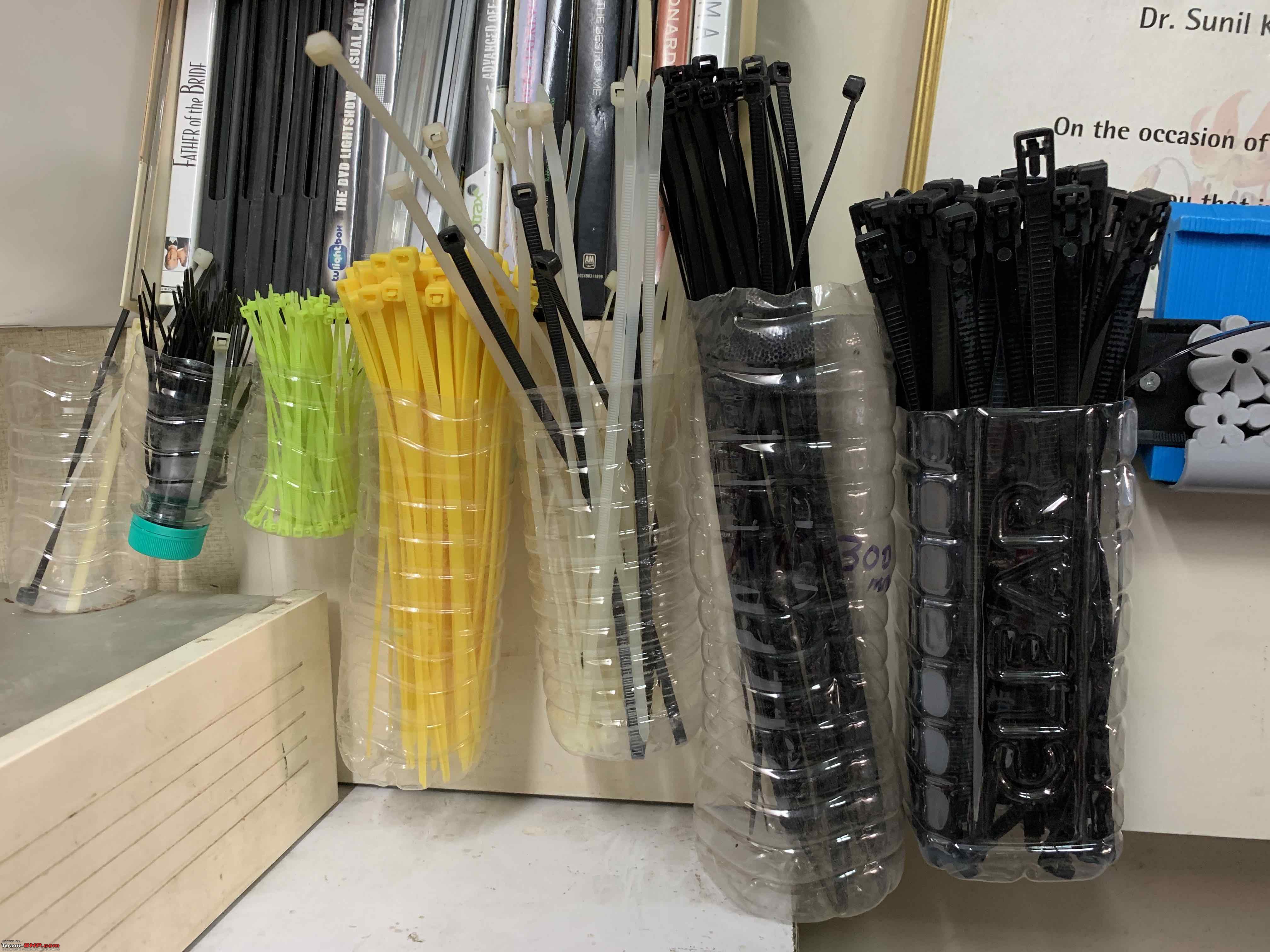

Here's a closer pic:
I recycle mostly everything.

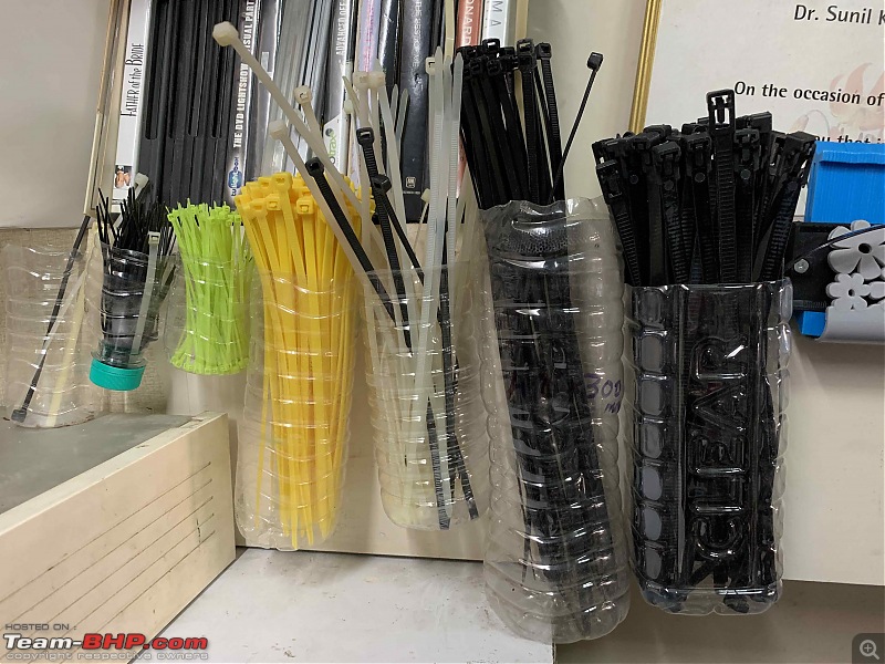

Bottles for zip ties:

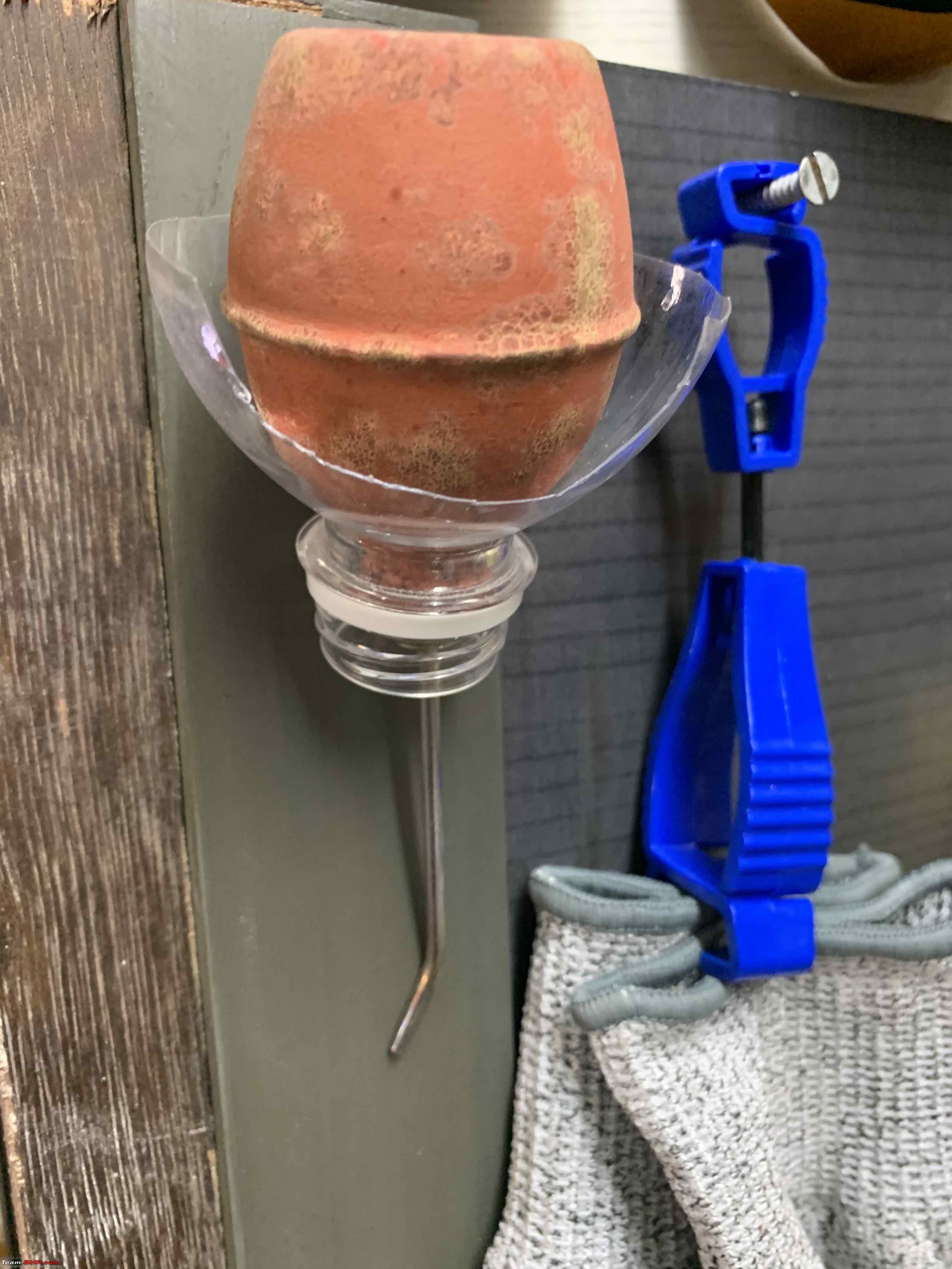

Top of the bottle also good for holding screw drivers, chip blowers, etc:

Man, those Bisleri bottles with the caps screwed to the ply above is ingenious! Who'd have thought?!
Great setup Tejas! Also loved the angle grinder mount and the hand drill mount.

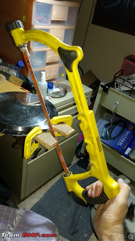

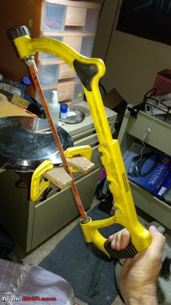

This is a task for the hacksaw
The cover may be thin, but it is still stainless.
The old blade in the saw would barely touch it. Luckily I had some new ones
I reversed the blade, so it cuts on the down stroke, as the jeweller's saw above would.
This is the photography grip! The actual one was better,
and it was easy to use both hands.
The down-stroke cut is natural, following the weight of the handle
De-bur and finish with files
The key to such a task is the bench peg. I got so used to using one when I was a hobby jeweller. Was quite surprised to find that carpenters here make up something similar! This task could easily be held close enough to the cut to prevent chattering.
The other reason not to use a jeweller's saw is it takes knack. When in the habit, one can easily do so much with this wonderful tool. When out of the habit, one can... break blades every few seconds! Who remembers hacksaw blades being like that? They were in my childhood: not hardened on the edge only, and they snapped very easily. Thankfully, now, it is a forgiving tool

Second, misunderstood the geometry anyway: the slots should be parallel to radii, not radii.
Dogleg (mirror image) would be better. The cover would have to be put on askew, and then guided in. Advantage - a jostle would not dislodge it.

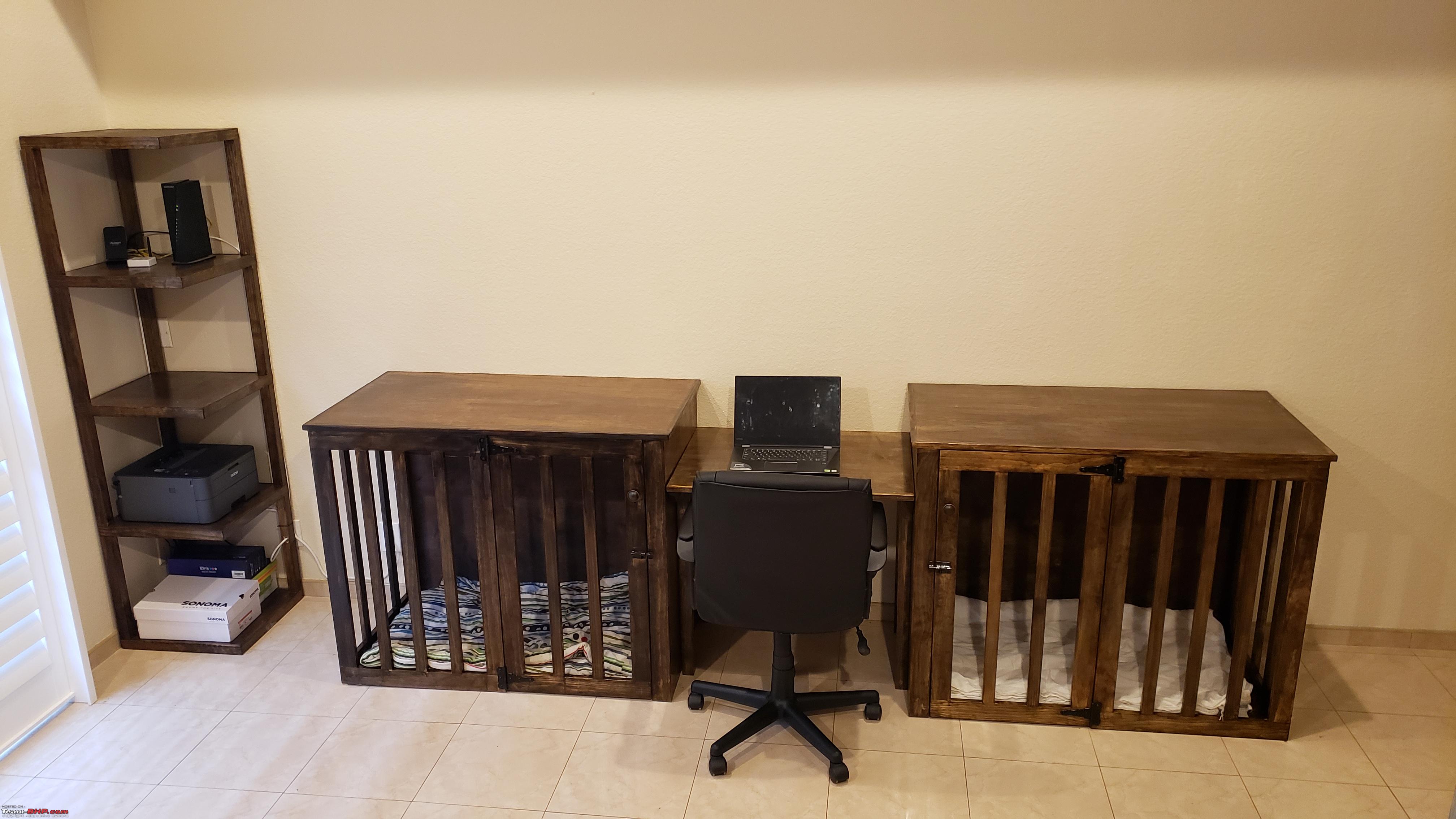

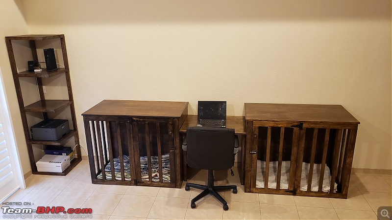

We adopted another large dog recently. The thought of having two huge metal crates or day beds in our bedroom was not very enticing. Decided to make something that addressed all the needs.
1. A stand for the printer, and wifi router that can be placed high.
2. Work desk for the lockdown
3. Day beds & Crates taller than 3' and around 4' wide for our large dogs.
Built two identical crates out of prime pine wood, and glued a maple plywood for the top. This way we can use the top as we please. Iron clothes, put art pieces, or indoor plants/pots.
Then I stained with dark walnut, and applied a clear coat. The doors prop open completely, and stays open. The dogs use it as a day bed. Having large gaps between slats for easy airflow was important, for so cal summers. This is what the whole setup ended up looking like. Yeah, I should have cleaned the laptop screen before taking the pic.
