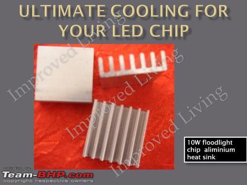

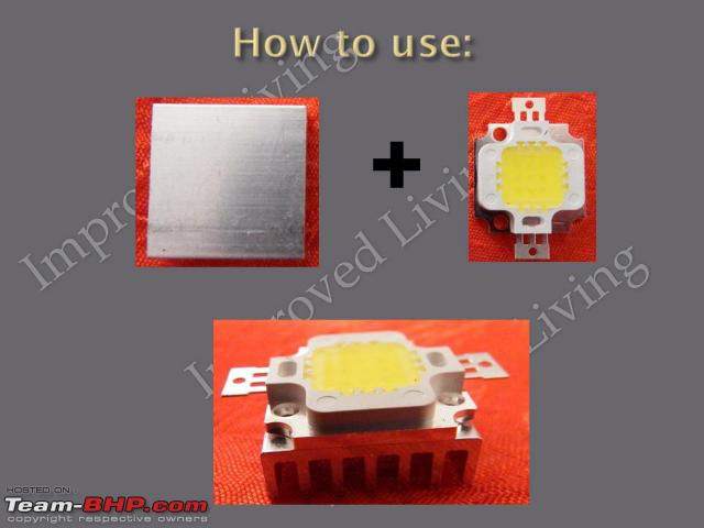

Is this enough area for a 10w led? The picture is from someone selling it online. I have similar sinks, but was thinking of using two instead of one. Can I use one? The led is the same as the one in the picture. It will be exposed to air, the sink.
From my experience - For short period runs, it will be enough. Hours of run will need a fan for forced cooling on this heat-sink for 10W LED with reliability and long life. It really gets hot !
What if I use two sinks? Fan would be a little difficult to install.
How will you join them ? If the heat produced is high or the ambient temperature is high, it may not be enough to dissipate the heat. You would need a larger heatsink or taller fins to radiate the heat produced.
Since there are no published results for the LED chip, you can try it out with a single heatsink with (with heatsink compound ) and test for a few hours. Measure the temperature rise and if necessary lower the driving current.
Prowler is offline   (1) Thanks
Heat produced is pretty high. However, I once ran one on a piece of aluminium sheet of about 8 square inches(a 2X4 inches). I let it run for about 30 minutes, and it didnt blow. and the sheet was not very hot. I could handle it while the LED was switched on.
As for joining them, I was thinking the led mount points will be two each on face of the heatsinks, and when the led is attached, it will hold them together. With heat transfer paste between the base and the face.
Just in case things go wonky, do you know what kind of fan I can use? Presumably it has to small enough. And the LEDs are going to be far apart enough that each will need its own fan, if at all.
I have 15-20 LEDs, and a similar, if not more, number of sinks. I think I can get by with burning/melting a few. Let me try and see.
If you have a CPU heatsink with its own fan, you can try that. I could see a matching heatsink/fan from an AMD processor. You may get one from a junked MB. The CPU fan runs off a 12 V supply - if I remember correct. So supplying 12 V shouldn't be an issue as you will be driving these LED chips from a 12 V rail anyway.
Mseal - epoxies may not conduct heat. Get a proper heatsink compound from an electronics store nearby.
