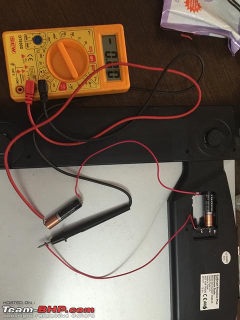

not sure where I am going wrong. I am unable to get the device to come on, if I connect the DMM in series mode but with a parallel it comes on which is not right anyway.Tools for a DIYer-imageuploadedbyteambhp1445763893.362831.jpg

I think you have wired the DMM incorrectly. From what I can see, you have moved the pin from the COM port. The black cable should stay in the COM port and the red one needs to be moved to the current port(pin). Though technically you can swap the wires, the COM pin should be always connected.

Thank you, that helped. Realized that the weighing scale when switched on is drawing 20ma and when switched off, it seems to be drawing every minute or so pulses of the same 20ma for a second. It is also extremely sensitive and footsteps around or near it is causing it to draw that current. Guess I will need to start using rechargeables for this one.

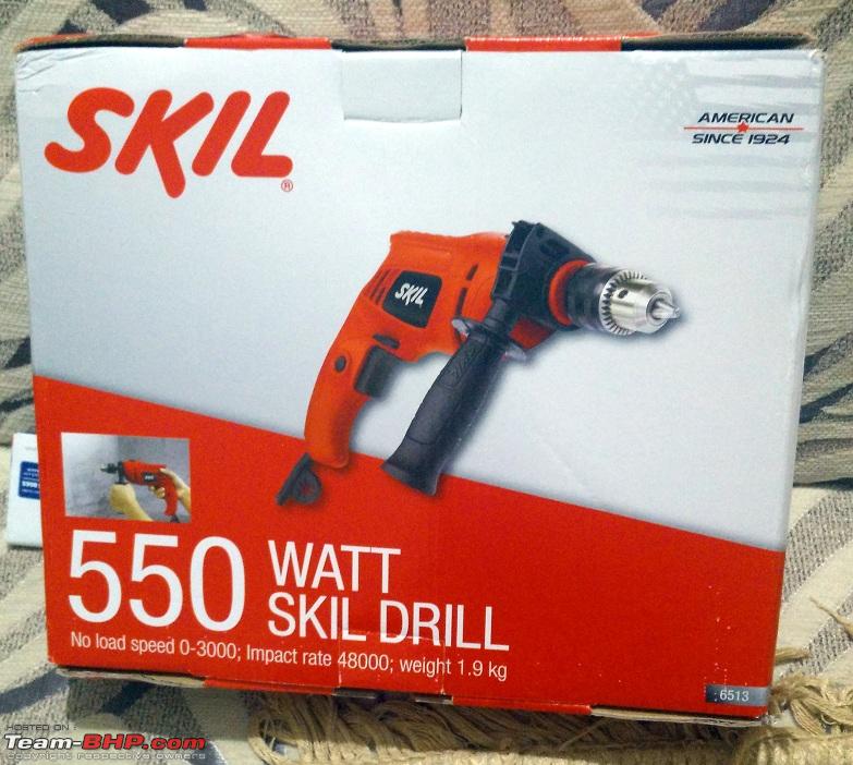

Got the SKIL drill from PayTM. Very fast and powerful, should suit me well.
Bosch X30TI drill bit set was cancelled by the seller
My only complaint is that the variable speed is controlled solely by the trigger. It would be nice if there was an external dial to control the variable speed apart from the trigger.
