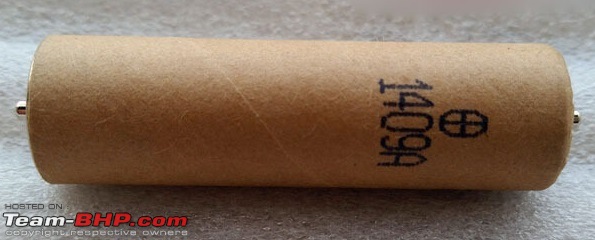

Any idea what this battery is called and if it is available locally? This came out of my Panasonic trimmer and the same is available in ali express. A regular rechargable AA battery fits the slot but there is about 1-2 mm gap at the negative terminal side for which I need to do some juggad if I can't get the exact battery.
Attachment 1484829
Please see the attached battery specs file. The code 1409A is listed on pg 3. Have pasted the relevant portion below. This is a 6V battery. So I don't think your idea of using a regular AA battery will work. Duracell and Eveready product numbers are listed. I am sure you will be able to get these in the US, but it may not be easily available here. Try the consumer electronics service outlets.
