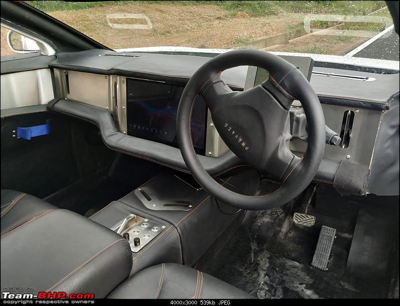

It seems to me that even though the car has killer looks on the exterior , the interior needs more attention. Its not all bad but could be better.
For example : Front boot needs a better design.
Visiting Pravaig Dynamics, a Bangalore-based EV company & checking out the Extinction prototype-pravaig_1.jpg
Don't use overhead switches for a road car. Its ok in an airplane since you don't need to keep your eyes forward all the time.
Visiting Pravaig Dynamics, a Bangalore-based EV company & checking out the Extinction prototype-pravaig_4.jpg
Such switches look best only on elevators.
Visiting Pravaig Dynamics, a Bangalore-based EV company & checking out the Extinction prototype-pravaig_3.jpg
Get a better carpeting in the interiors.
Visiting Pravaig Dynamics, a Bangalore-based EV company & checking out the Extinction prototype-pravaig_2.jpg
While i do appreciate the amount of effort that has gone into the production of the prototypes but if they are targeting to lease these cars to luxury hotels to ferry HNI's , they better get their interiors right.
