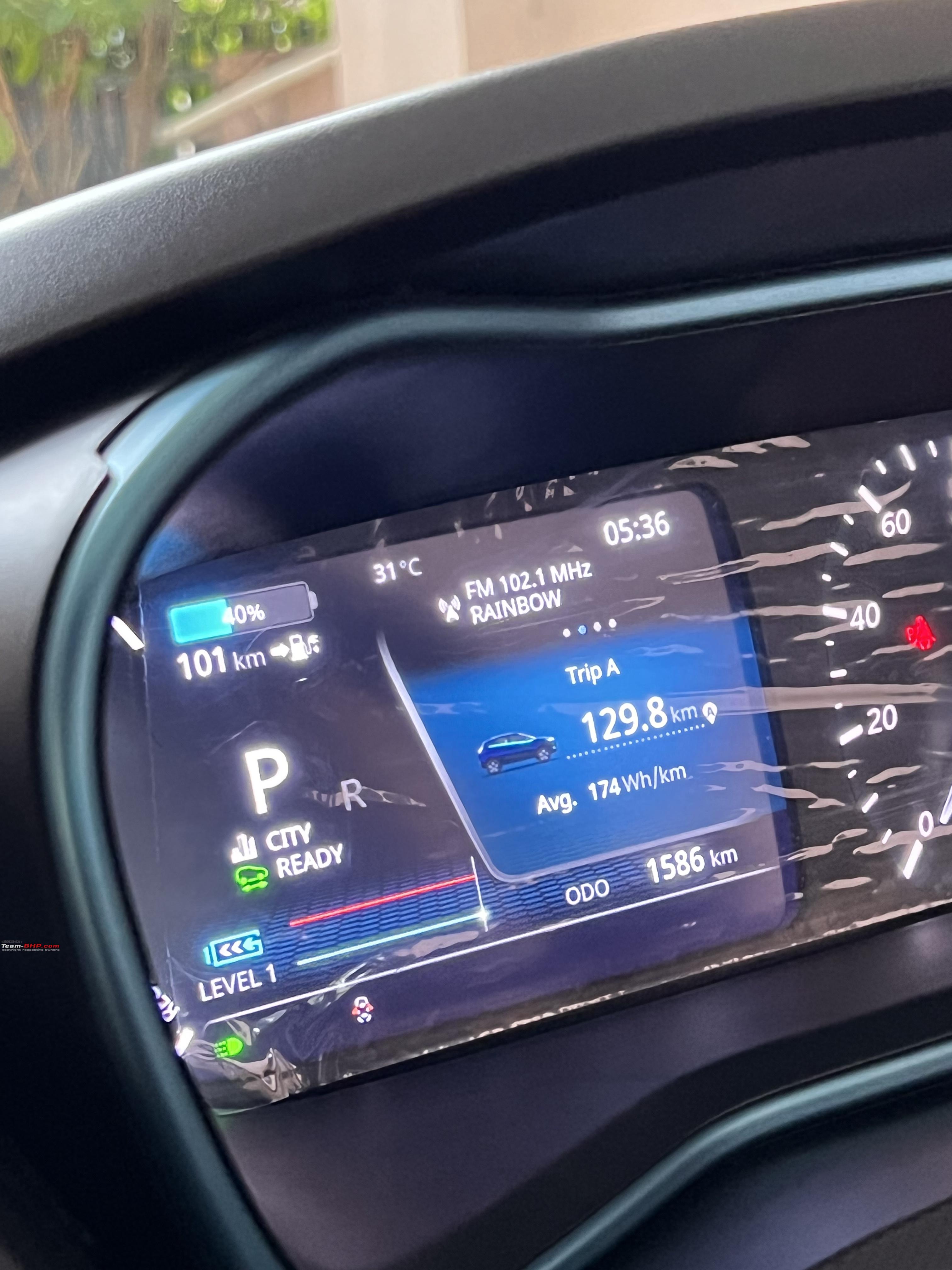

Did a 130 kms highway drive today
1. First 65 kms in ECO mode with regen at 1 and speed between 90-110kmph. It came to 153wH/km. It does not like steady cruise speeds for sure. It was showing around 163-165wH/km except for the last 8-9kms through city with constant deceleration and braking where it finally came down to 153wH/km.
2. I had to idle for 30mins with AC when waiting for an appointment.
3. When returning back it was mostly in sport and city mode with a few quick accelerator dabs thrown in and regen at 1.
The final figure was 174wH/km over 130kms.
Going by charge consumed,
First 65kms was with 25% charge amounting to 260kms on full charge and
Final 130kms was with 60% charge amounting to 216kms.
I’m beginning to believe 180kms with spirited driving and 240-250kms with sedate driving in Eco mode is easily achievable
In one of the previous posts of bhpian Varkey i saw 97wh/km consumption. Amazing driving style adaptation.

the wh/km is more based on your speed than regen level. The sweet spot for range/speed combo is somewhere between 65 to 70. Lower the speed, more the range but more asleep you will be. Faster you go, the range drops and of course this is basic physics and applies to every car be it be electric or fuel based.
For highway cruising, make regen level 0 and coast easily at 80kph on flat and slightly down hill road, and use regen setting button to brake rather than braking when slowing down.
In one of the previous posts of bhpian Varkey i saw 97wh/km consumption. Amazing driving style adaptation.[/quote]
I’m with you on this. I’ve been getting similar figures as yours with my EV max after 4 full slow charging sessions at home and over 1000 kms on the odometer.
The harder you are on the throttle, faster the charge drain. Mine is usually driven around in the city limits with 60-70kmph top speed hence no chance of using cruise control
Mostly driven with city mode and ECO mode only if I drive or instruct my chauffeur to do so.
