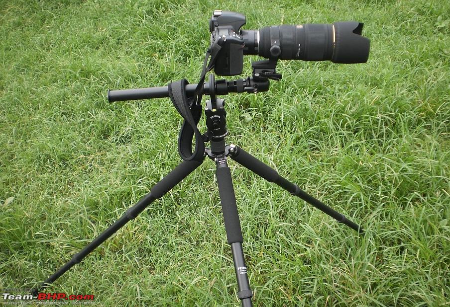

My first outing with the cheapest extension tube in the world went horribly wrong. I dont think I will be able to get any decent images with this set up. Today I tried it only with the 70-200 lens, it might be better with the 50mm which has aperture rings. There are many things one should know about an extension tube which has no electronic pins in it. I will give a detailed post next week ! Here is the set up used today.

hmm..so no aperture changes with that set up I guess :eek:
With 50mm it will be a bit easier..aperture ring and lesser weight.

Yes, I will try to be as clear as possible from my experiment. Please note this is my comments about an extension tube without electronic pins.
1) View finder is pitch dark through the tubes even on a full frame (FX) so I can imagine how tough it would be on a DX body.
2) Point one leads to the usage of 'Live view' which is unavoidable.
3) Point 2 leads to a very sturdy tripod. Hand holding ? Dont even think about it.
4) None of the G lenses and most of the third party lenses do not have aperture ring, which makes aperture control out of question. There might be some tactics but I could not figure out anything.
5) Quality is not supposed to be bad, but I did not find it anything exciting.
6) Mounts are not tight, 70-200 kept wobbling in between.
7) Exif data will show aperture as "0"
I am not in a hurry to throw this out of my bag, will have bit more patience and see if I can find something worth. Also need to try it on 50mm 1.4 which has aperture ring, but I am sure shooting bugs or flies will be out of question as the working distance will be hardly 3 or 4 inches.

Found this article related to AF lenses and extension tubes:
Macro Photography with Affordable Extension Tubes & Reverse Mount Adapters
The following steps to be followed to set the aperture.
  1. Mount the lens as you normally would.
  2. Set your aperture using your camera’s aperture adjustment knob/button to a small enough aperture. F/8 would be a good start.
  3. Press the depth-of-field preview button of your camera, it’s usually located near the lens release button on your camera’s body. You’ll hear the aperture blades close and if you peer into your lens, you’ll see the blades of the lens.
  4. Without releasing the DOF preview button, remove the lens from the body. Doing so will keep the lens stopped down.
  5. Mount the lens to your adapter and you’re good to go
Unsure whether this will work in your case. The question is how the DOF preview button will keep the lens stopped down? Even if it works, still a tedious task IMO.
For bugs, you will be better off finding an old MF lens(>100mm) with good glass and an aperture ring. Given the weight of 70-200, I would not risk it with the extension tube.
Another possible option is to buy a cheap 2x TC with metal contacts (strong enough to bear the weight). Remove the glass and use it as extension tube :)

Someone had suggested me the same and confirmed it worked on Canons, but I have not checked it with Nikon and would not try that by any chance. Somehow my 70-200 is mostly at f/8 or around that by default when its not in use (assuming by the gap). So, aperture was never a worry in the experiment. Test shots also confirmed more area was in focus.
Alternative option what you suggested is converter used as tube with the glasses removed, I have a 2X converter that costed around 9.5k and can not imagine to break its glasses :) A better choice is to get the Kenko tube set that comes with the metal pins. Anyway, my mind is on the Sigma 150 2.8 macro, no plans to buy anything for sometime, as there is so much to experiment with whatever is already in the bag !!
