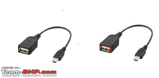

I bought the one sold by dvdstoredelhi - if you see the picture - you will see that one side of the connecter has a case. The actual female connector is inside the case - and is a 1/2 cm in. In case of my Reliance modem, the cheap 40 Rs cable connects it to the computer but gives an error. With the dvdstoredelhi one, it doesn't even light up. I think because of the case, my Reliance modem doesn't even go in completely. Even with my 4GB usb storage, I have to really push it hard in to make it work with this device - the 40 Rs. cable works file with it.
Since it cost me a total of Rs. 90, no point in returning it. I'll try cutting the case up & seeing. This is the first time I am using ebay - what should I do to indicate to the seller that it's not working as intended.

I used a knife and cut 1 mm off the end of the female's case. And now my USB modem goes in completely & seems to work fine.

Since I have already cut it, I can't provide the before picture.
Let me describe it as best as I can.
This is the picture on the ebay site
http://www.ebay.in/itm/SONY-OEM-USB-...-/140857930610
But actual product was a little different - it was like this - http://ecx.images-amazon.com/images/...500_AA300_.jpg
The difference is so tiny that you won't notice it.
Check this picture - http://www.team-bhp.com/forum/attach...hmentid=997719
The 1mm I have marked in red is the extra thing - it's slightly longer than that shown in the picture. This prevented my USB from going in completely.
I cut of the red part with a knife & it's all fine now.
