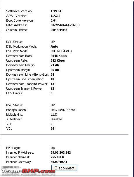

I had posted earlier my problem of the modem DSL link going up and down and eventually dying post 10pm and coming up again and becoming fine at around 6am..I have a Linksys AM300
I am enclosing a screen shot of the status of the modem.. any help?

The strength of your DSL link is pretty OK as per the screenshot. Between, shall you post the screenshot of the modem page when the problem is there. Understand from the current screenshot that the PPP connection is Up and connected with an IP address. I guess it is the screenshot when your connection is not having any issues.
