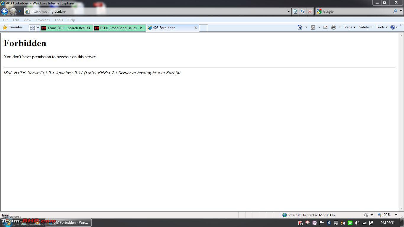

last month we got a bill of rs 4850 for broadband usage. after complaining they said that if we apply for a unlimited plan , they will correct the bill. . i i applied for the plan and they changed the bill to 840rs. and but i dont know if they have changed my plan or not.
also i am unable to check usage on my connection. the site doesnot open. i cant even change my passord. I use a wifi modem. is it because of that?
Absolutely no!!! as long as you're checking your usage from your telephone line it should work. I use a wireless router between the modem & PC. I'm able to check using both desktop as well as laptop no issues.
Edit - BTW, download DUF (Dataone Usage Finder) instead of checking through the browser. Its easy, quick as well as has some meaningful information to understand.

You can use this link http://10.240.43.216/ to check your usage and change your password.
