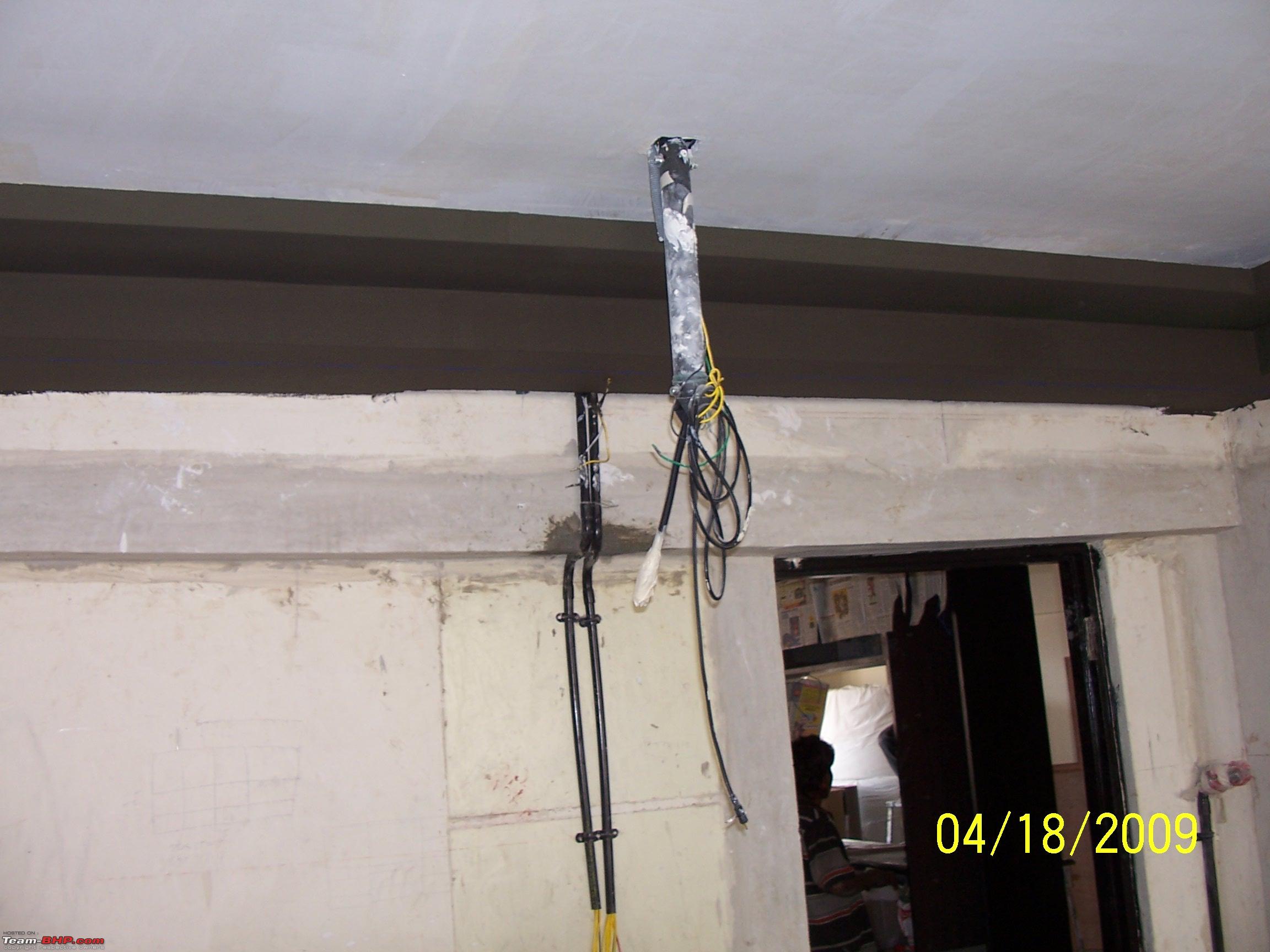

I would suggest you going for a screen rather than painting the wall. A wall will not give you the same PQ as the screens. A 120" screen will cost you between 10k to 20k depending on motorized or manual.
2. I know the projectors only have HDMI and other inputs, so player will have to be placed on a shelf or something and HDMI & power cables must be routed to ceiling. Anything else?
Depends on the layout of you home theater room, is this a dedicated room for home theater? If yes, you will need to plan where the units are going to be places and ensure atleast a 3" conduits along the ceiling to carry the HDMI cables to the projector. Running the HDMI cables in the conduits in now would be ideal, you will not be able to run it once the construction is over since HDMI cannot be bent if you have joints in the conduit.
3. Planning to provide provisions for 7.1 speakers, so when I setup home theatre by 2012 or later, I should have them available in market, any inputs on speakers provisioning? I don't really like creating box type hole inside wall, speaker size may differ later, etc. Thinking of artificial ceiling (one level of ceiling in wood or any material just below usual ceiling) to hold the projectors, etc - I'm yet to decide.
You will need to again lay the conduits now for the speaker wirings, mark the areas where the speakers are going to be placed and lay the conduits. You will need separate power points for the sub, so ensure this is also completed. A 1 and 1/2" conduit should be sufficient for the speaker wires.
For the ceiling, I would suggest a gypsum based false ceiling instead of a wood. You need a poroject ceiling to be fixed now to the ceiling. A false ceiling cannot hold a projector mount, so fix it now.

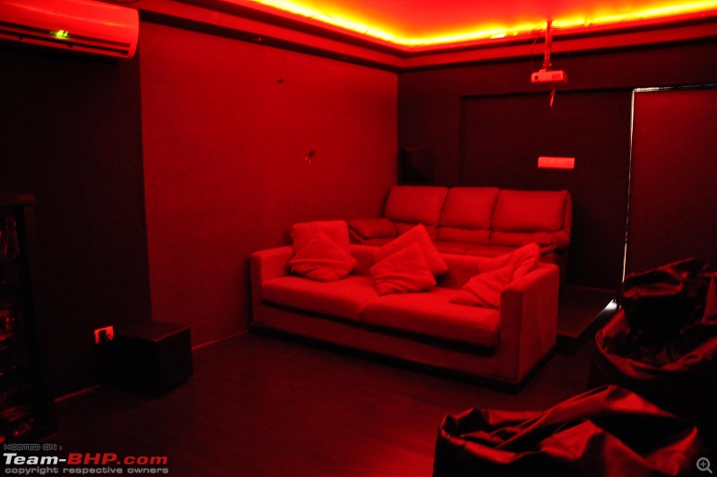

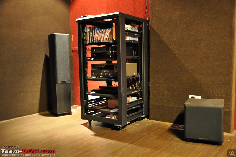

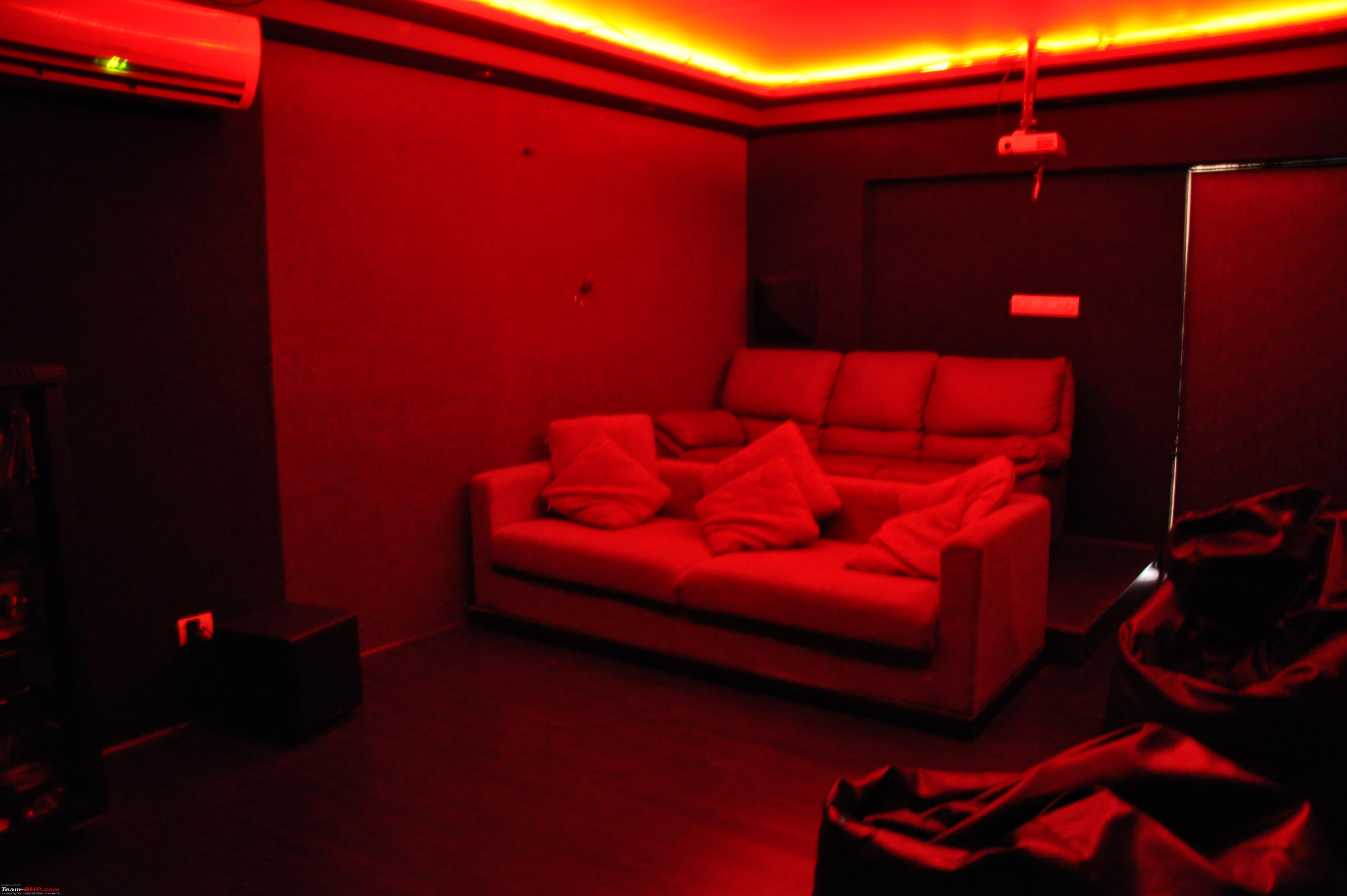

Here are some pictures of my dedicated home theater build, hope this will give you some ideas.....
All the best,
