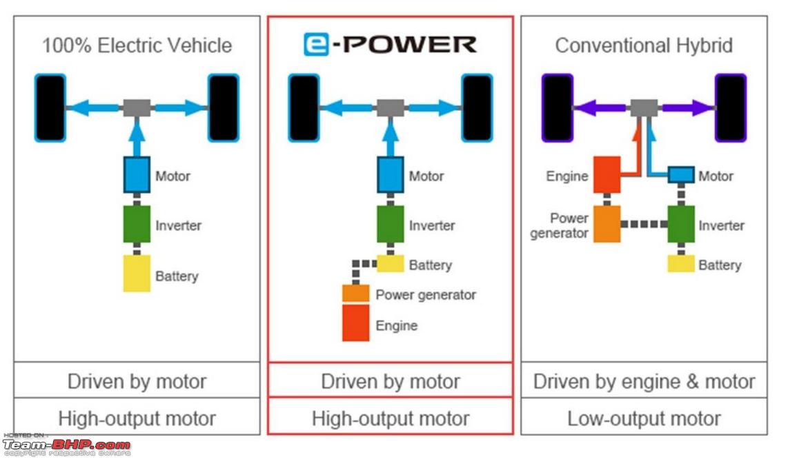

To put it in perspective for everyone, the middle image is what Maruti is trying to build. Nissan already offers this in Nissan Note outside India.
Engine runs at generator which charges a battery and battery drives the motor. Now the battery in Nissan Note is 1.5 KWH and claimed EV only range is 3-4 kms.
Please note: The conventional hybrid is not exactly how Toyota has implemented hybrid. Toyota can also use electric motor only to drive, hence it has an EV only range. But the ICE engine drives wheels along with the motor after a point.
