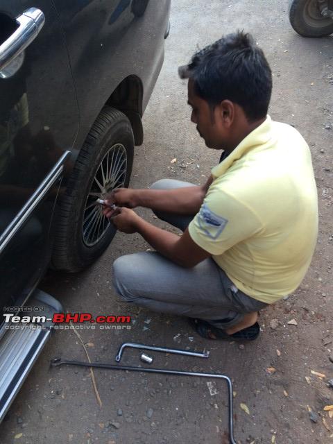

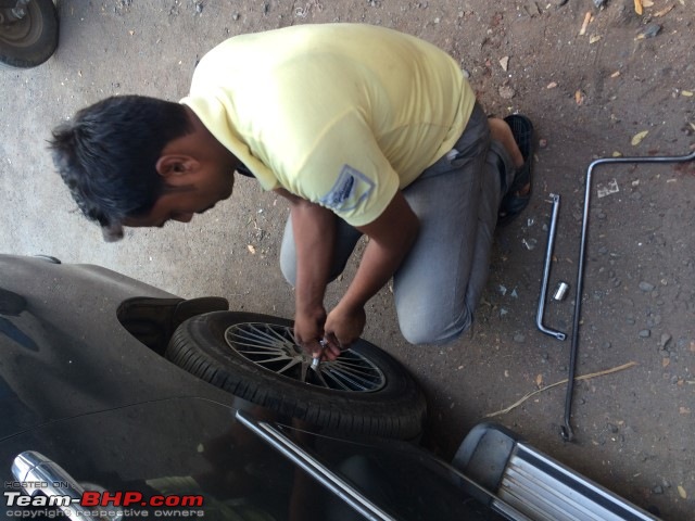

After about 5000km the Michelin got its first flat on tuesday the 13th. Dad had left for Kenya for some business and since I had exams even I was not using it. On tuesday when I returned from college I could see the car tilted to left hand side. On a closer look found the tyre to be flat.
There was enough air for the car to be driven and the tyre walla is hardly 300m from my house.So put the car in first gear and left the clutch and gas pedal and took the car to puncture guy. There I found the tyre had been punctured by a small metal object. Got the tyre repaired by using the tubeless puncture kit and went home. Paid him 150 bucks.
Toyota Innova Experience. EDIT: 10 years, 2,56,000 km up and SOLD!-image-small.jpeg
Toyota Innova Experience. EDIT: 10 years, 2,56,000 km up and SOLD!-image_1-small.jpeg
The metallic object.
Toyota Innova Experience. EDIT: 10 years, 2,56,000 km up and SOLD!-image_2-small.jpeg
Ironically all these days when the car was running everyday there was no problem , must be the metal object pierced the tyre in one of the car's recent trip to Daman. The second thing it was the rear left tyre again!
The same spot with one less nut and a bent rim. Looks like that side is spooked. This is the third puncture I'm facing on the rear left side. It has eaten up 2 tyres till now.
Just hope it doesn't eat the Michelins too.
