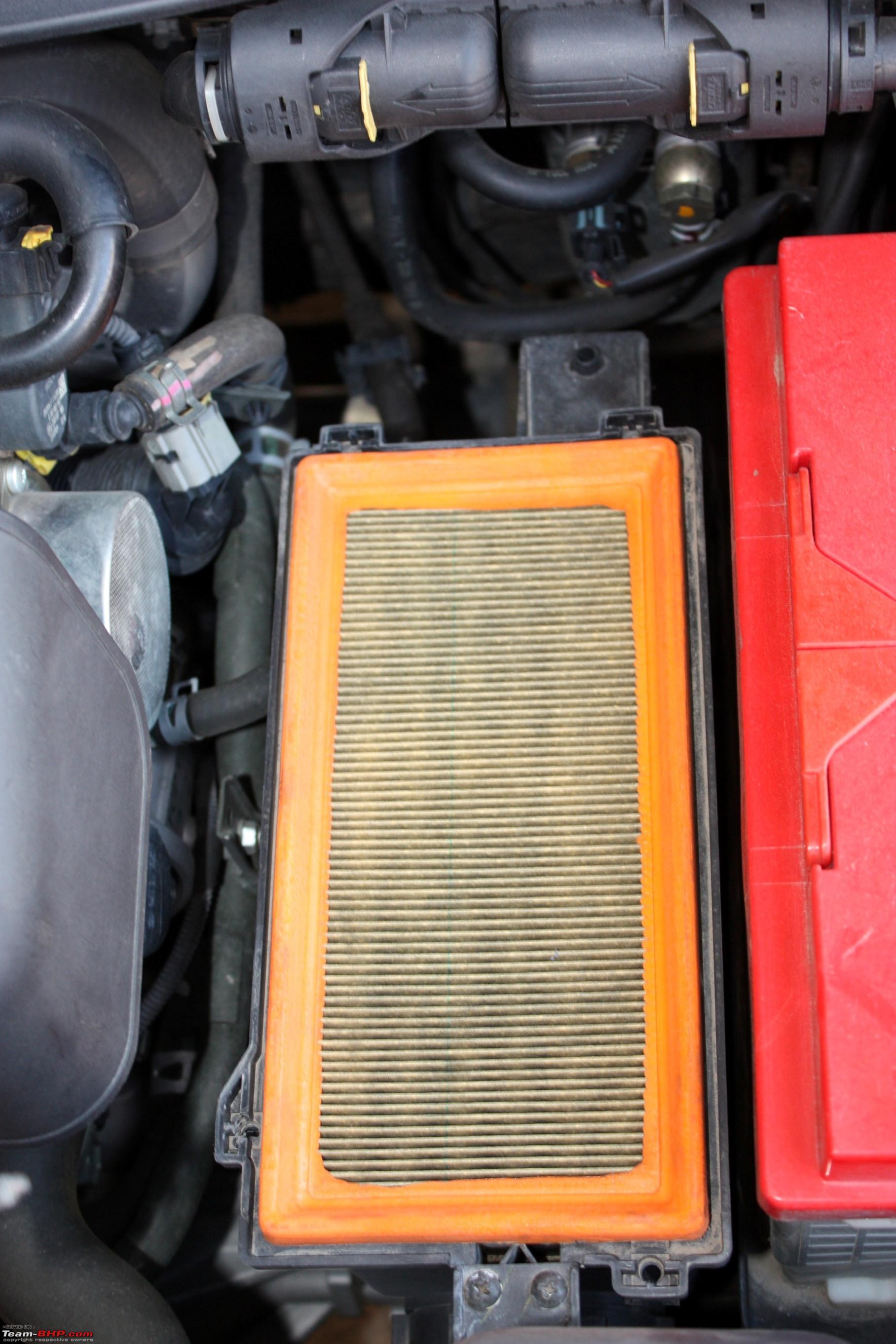

Ahh this is the air filter eh.
Swift Diesel, Saga continues. The DIESEL experience! Part II 72k kms Update Page 182. Now SOLD!-airfilterinbox.jpg

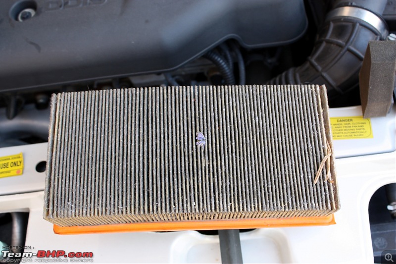

From top it looks quite clean, lift it and ohh la la what do we have, flies, straws, dust and what not.
Swift Diesel, Saga continues. The DIESEL experience! Part II 72k kms Update Page 182. Now SOLD!-flynstraw.jpg
Swift Diesel, Saga continues. The DIESEL experience! Part II 72k kms Update Page 182. Now SOLD!-beforeclean.jpg

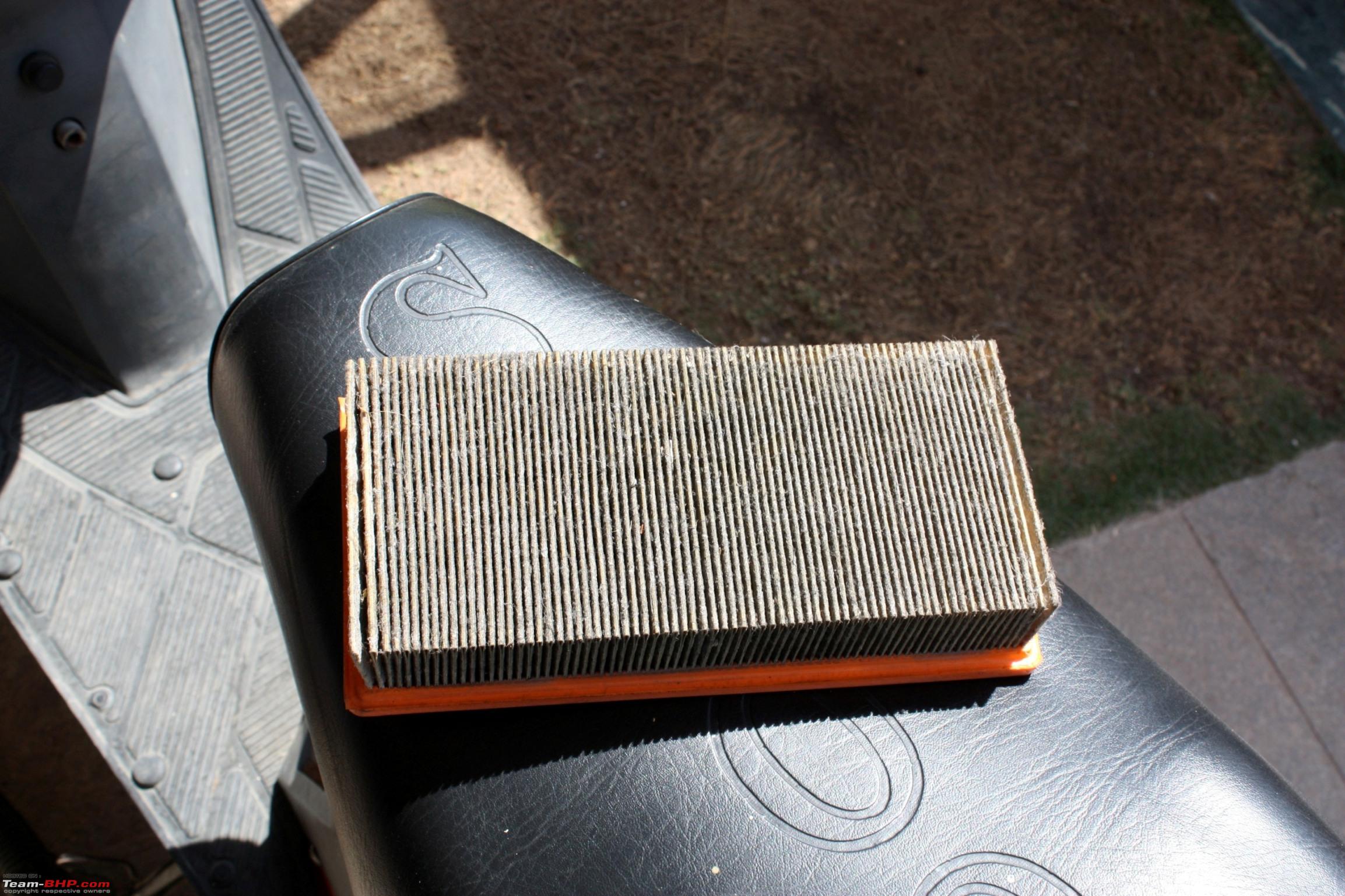

Now take the air filter and run pressurized air on it, either from an air compressor or you can use the blow function of a home vacuum cleaner. Tap the air filter and repeat the process, soon the dust will reduce and your air filter is clean.
Swift Diesel, Saga continues. The DIESEL experience! Part II 72k kms Update Page 182. Now SOLD!-cleaned.jpg

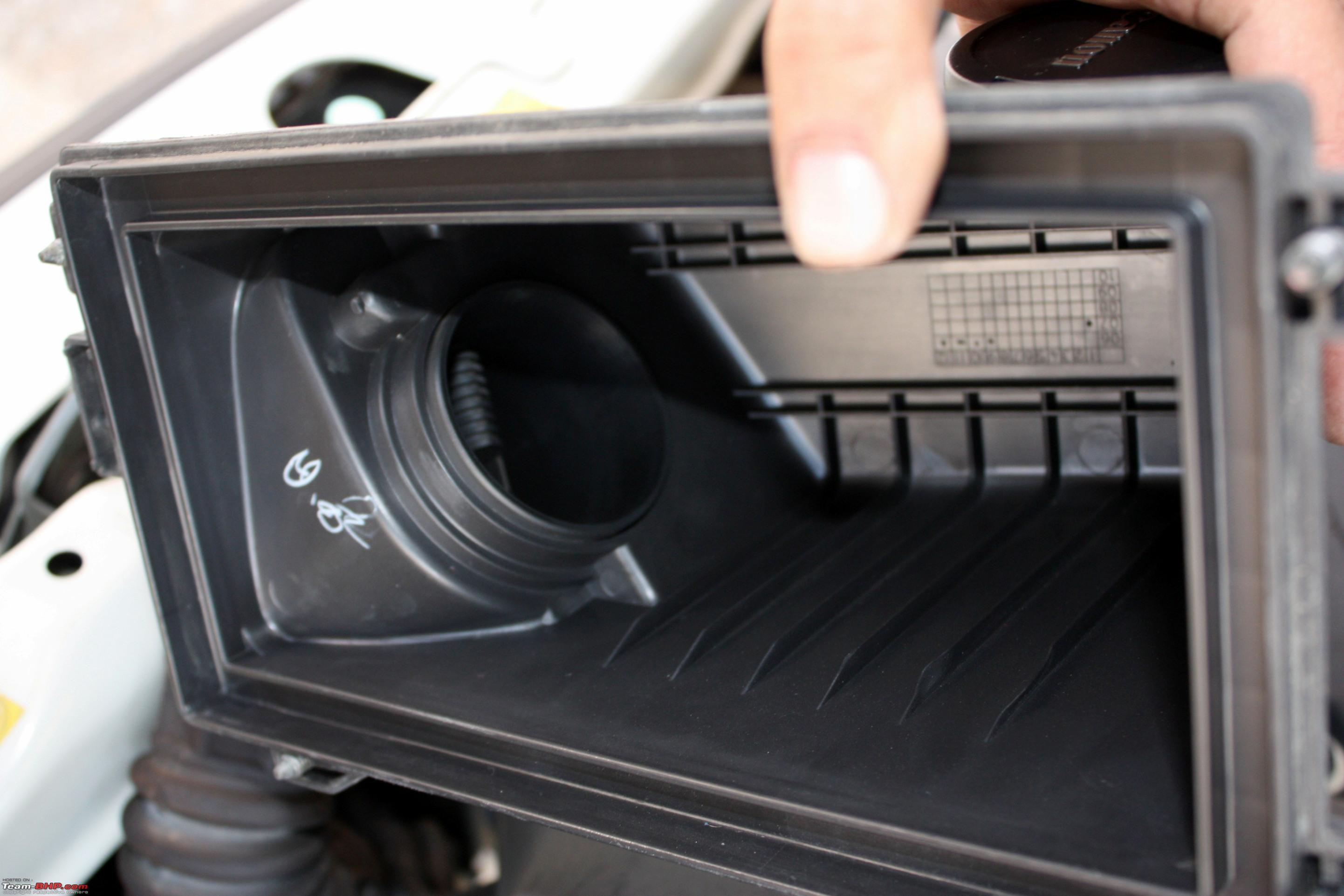

Do the same with the cover of the box also, if you look carefully you can see the air map sensor in the middle of the pipe, inside the cover.
Swift Diesel, Saga continues. The DIESEL experience! Part II 72k kms Update Page 182. Now SOLD!-airmapsensoropen.jpg
