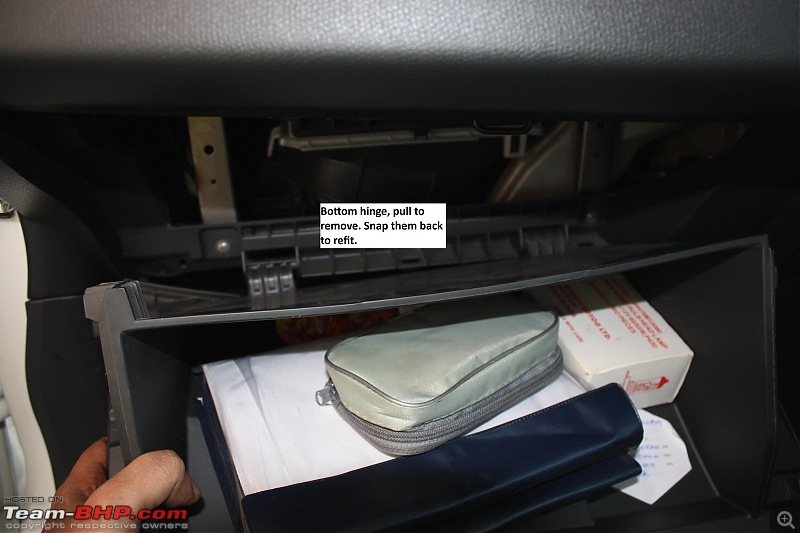

Ok i forgot to take the contents inside off, lazy me! If you remove can avoid the risk of things falling off on the floor lol
Step two: The glove box is held at bottom on 2 hinges, which are snap fit. They can be pulled out without much effort. Again dont use brute force on these since they are all made off plastic and can break.
