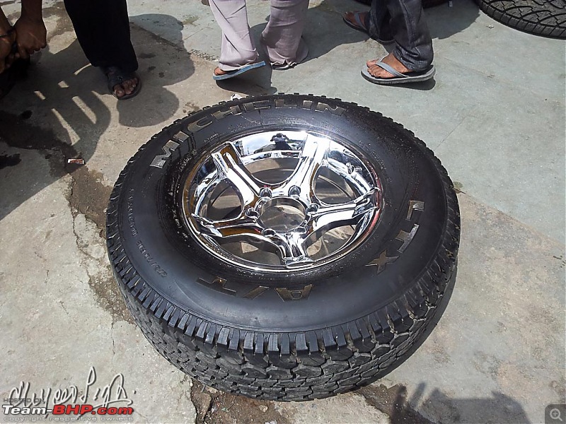

NEW ALLOY WHEEL
I bought another Alloy Rim and now after the disastrous experience of me bursting 2 tyres within 24 hours I always carry 2 spare tyres with myself.
The new alloy wheel and testing that on the vehicle. Now this new bling alloy is doing a duty as a spare tyre in the boot.

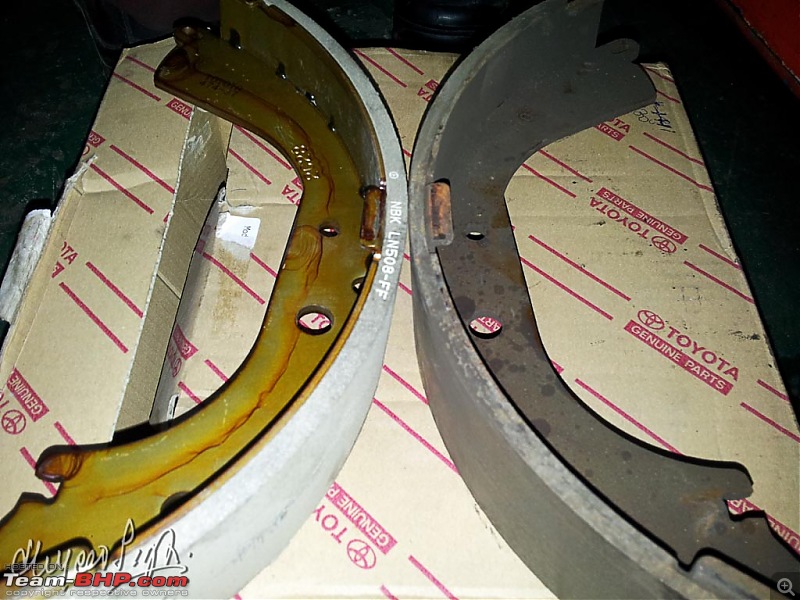

GENERAL CHECKUP AND BRAKE LEATHER CHANGE
In Feb’13 before heading for the Desert Storm ‘13 as a Rally Marshall, I had a small feeling that the brakes of the vehicle weren’t as effective as before and as I’d just changed the front brake pads a couple of thousand kilometers before, I took the vehicle for a complete checkup before I headed out for the rally. Here we discovered that the leather in the rear brake drums had lived their life and it was time to change them. So this was done.

New and old Brake Shoes Side by Side

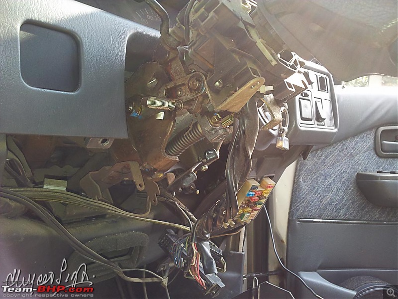

GETTING THE REAR WIPER WORKING
Since the time I’d bought the vehicle, the rear wiper didn’t work. So This time around I got the complete wiring checkup. What was observed was that the wiper levers besides the steering wheel must have been changed the the levers which were henseforth installed didn’t carry have the functions for the rear wiper. I didn’t want to place another switch in the already cluttered dashboard. As a result there were a pair of unused buttons on the dashboard which were for the power antenna. These were the ‘UP’ & DOWN’ button. So I got the power antenna disconnected and the ‘UP’ button now does it duty as the Rear Wiper switch and the ‘DOWN’ as the water washer.
Here we are trying to figure out which wire goes where

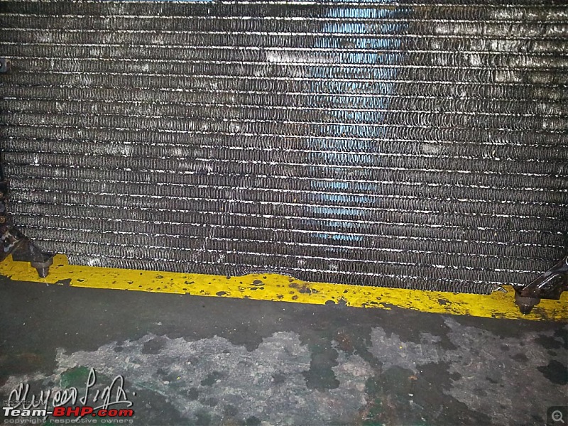

NEW AIR-CONDITIONING SYSTEM
The major expense that was done during this 10K Kms was that I changed/ overhauled the complete Air-Conditioning System in my vehicle. The parts that were changed were 1. The Compressor, 2. The Expansion Valve & 3. The Aircon Bottle. While we were at it we also completely cleaned up the Radiator, The Cooling Coil & the Condensor. The coolant was also replaced. While removing the aircon pipes two of the piped broke as they’d been welded before and we cutout the broken portion from the place where it was good and changed that too.
Toyota Landcruiser - 80 Series HDJ80 - Owned for 82,000 kms and counting-20130306_140926.jpg
This was the condition the radiator was in. The condensor was even in a worse condition.
