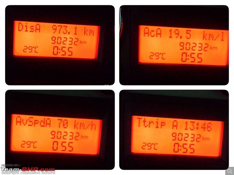

Trip Logs:
Chennai - Coimbatore - Angamali - Thodupuzha - Vagamon - Vandiperiyar - Kumily - Cumbum - Dindigul - Trichy - Chennai
Code6'd Fiat Linea MJD: 100,000 kms & counting!-masvagmas.jpg
Chennai - Coimbatore - Chennai
Code6'd Fiat Linea MJD: 100,000 kms & counting!-mascbemas.jpg

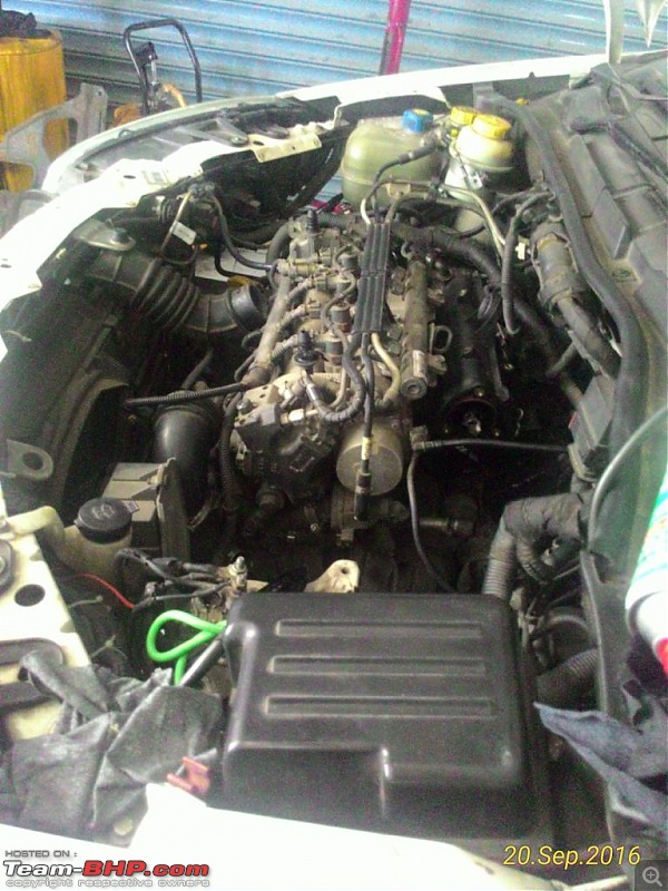

The odo has crossed the 91k mark. Off late the usage has gone down, thanks to the prevailing situation in Bangalore for TN vehicles :(
Last week was in Coimbatore and hence left it at Marvel Erode for some long pending works. Since the last 20k kms I have been facing a peculiar oil reduction issue. Though there has been no visible leaks, I did check on this with both True Sai and Marvel and they both checked for visible leaks and said things were just fine.
Obviously I had to take that answer since the power and FE have always been good. But then this reduction was constantly lingering in my mind and was irritating. I measured it carefully and the reduction was about 400-450 ml at about 4000kms. Next discussion with FASS and my mech suggested me to switch back to Selena as they were wary of Delvac1. So I did switch back to Selena after the timing chain change at 80 and then the same continued.
So last week since I had to work from home from CBE, thought it was the best time to leave the car at FASS so that they get ample time to diagnose. I suggested to check the inter-cooler for any oil inside and if so then check the turbo. They did check the inter-cooler and there were no oil traces, turbo was also fine. They then decided to clean the intake manifold, EGR valve and also the exhaust.
When these were all opened up, the soot was found to be within tolerance in all the above except the EGR which was badly blocked and clogged. The technician added that he has not seen such badly clogged EGR! The EGR was cleaned once around 30k mark at CAI during the oil cooler replacement, but then not sure if it was done properly? Had no clue. So they did the cleaning and did a TD and said that there is remarkable difference in the pickup and whatever smoke was there on 2nd gear full out acceleration was also gone and requested me to drive now with the OE air-filter instead of the KN and share my views.
They also added that such badly clogged EGR would have led to oil burning. So took delivery and yes I did find the car quicker in gears 1&2 and also felt it being more relaxed. I did see the pics of the EGR from the mech and it was a little bad. So will have to monitor on the oil levels for the next 5000 kms at least to ascertain on whether the issue is resolved or not.
Additionally got the power-steering oil and brake fluid changed and also got the wheels balanced and aligned. I felt the rear wheels wearing out unevenly and hence specifically requested them to check on the alignment and suspension and the feedback was that all was well. The tyres have anyway done 49k kms and will be changing them in a couple of weeks time.
Overall extremely satisfied and happy with the service rendered by Marvel and I don't mind driving down 100 kms to get the work done from them
At work in Marvel:
Code6'd Fiat Linea MJD: 100,000 kms & counting!-p_20160920_102024_1_p.jpg
Code6'd Fiat Linea MJD: 100,000 kms & counting!-p_20160920_103617_1_p.jpg

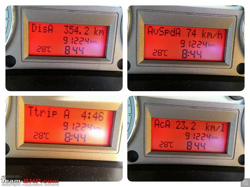

Some stats over the last 2 weekend drives:
Bangalore to Coimbatore
Code6'd Fiat Linea MJD: 100,000 kms & counting!-1475760462756.jpg
Bangalore to Chennai
Code6'd Fiat Linea MJD: 100,000 kms & counting!-1475760508736.jpg
Chennai to Coimbatore
Code6'd Fiat Linea MJD: 100,000 kms & counting!-1475760542276.jpg
Coimbatore - Bangalore - Chennai - Coimbatore
Code6'd Fiat Linea MJD: 100,000 kms & counting!-1475760574266.jpg

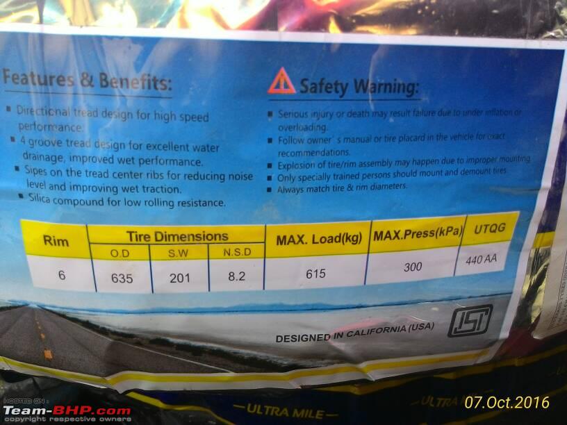

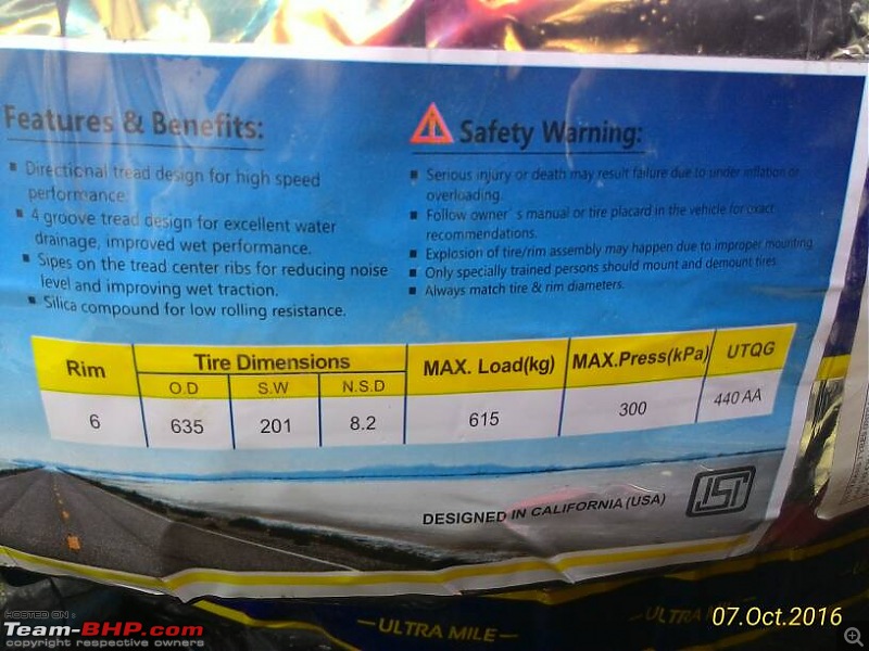

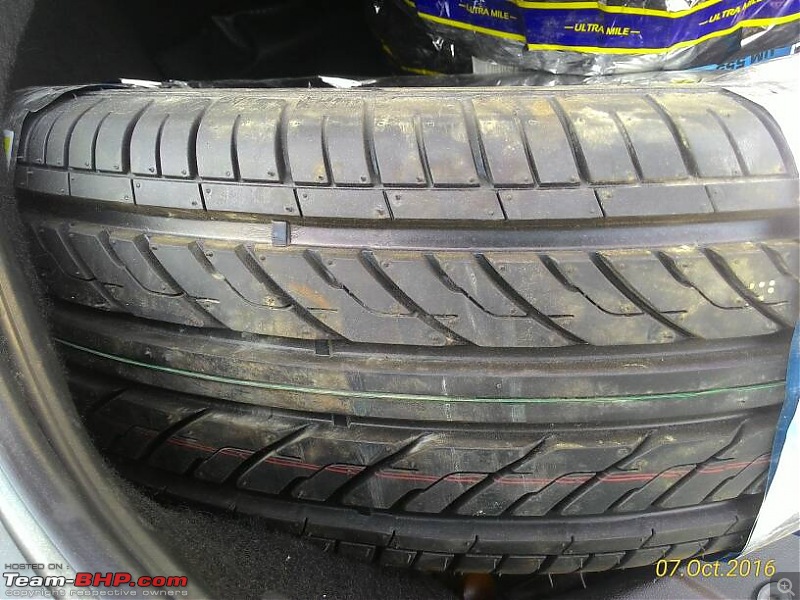

The Odo is little over 93,400 kms. Got the tyres changed last week. The yoko earth1's have done about 49,800kms and since one of the tyres had uneven wear and was badly worn I decided to change. Else the treads in the other 3 "looked" good for another 3 to 5k kms.
Now was the dilemma on what tyres to buy. Budget was a big factor this time. I couldn't stretch beyond 4-4.2k for a tyre. This figure was in mind since I got the Apollo alnac4g for 4200 (195/55/15) but little did I know that the price diff for 195/55 and 195/65 was so much. Same alnac4g in 65 people was >5k.
Then was plan b. Couldn't source nexen like I did for the Palio's earlier. So started looking for Ep Accelera. The accelera phi again I was unable to source (comes in 60 profile and not in 65). The accelera alpha was available and well within my budget, but the alpha's have a reputation of being miserable in wet condition and hence ruled them out.
Kenda was next as I know quite few using them in punto and linea's. But my cousin gave me a contact who is the distributor for Accelera and UltraMile. My cousin had installed UM555 in his Logan recently and was happy with them. But he had hardly run a few thousand kilometers only.
Looked up into Google and there was hardly any information except the India specific site (Ultramile Tyre). Called up the distributor and he assured me on the quality and offered a replacement or refund if not satisfied. So went ahead and got the UM555. The deal was done and he shipped the tyres to Coimbatore.
So far I have done about 550kms and the tyres feel good. Will keep the thread updated as I clock more miles.
Post the tyre change, I did feel that I should have changed the earth1's much earlier. Could realise how hard the earth1's have become and the ride had improved so much.
Few pics:
Code6'd Fiat Linea MJD: 100,000 kms & counting!-1476373820699.jpg
Code6'd Fiat Linea MJD: 100,000 kms & counting!-1476373842169.jpg
Code6'd Fiat Linea MJD: 100,000 kms & counting!-1476373860218.jpg

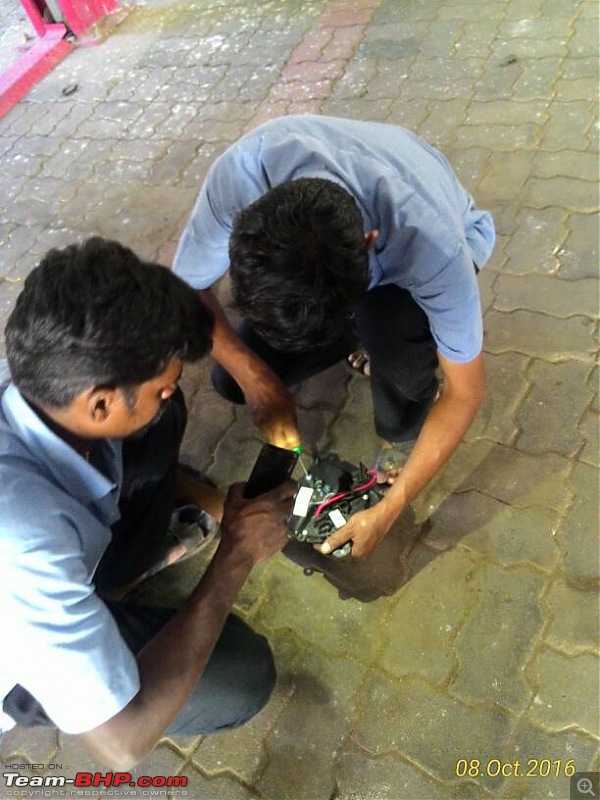

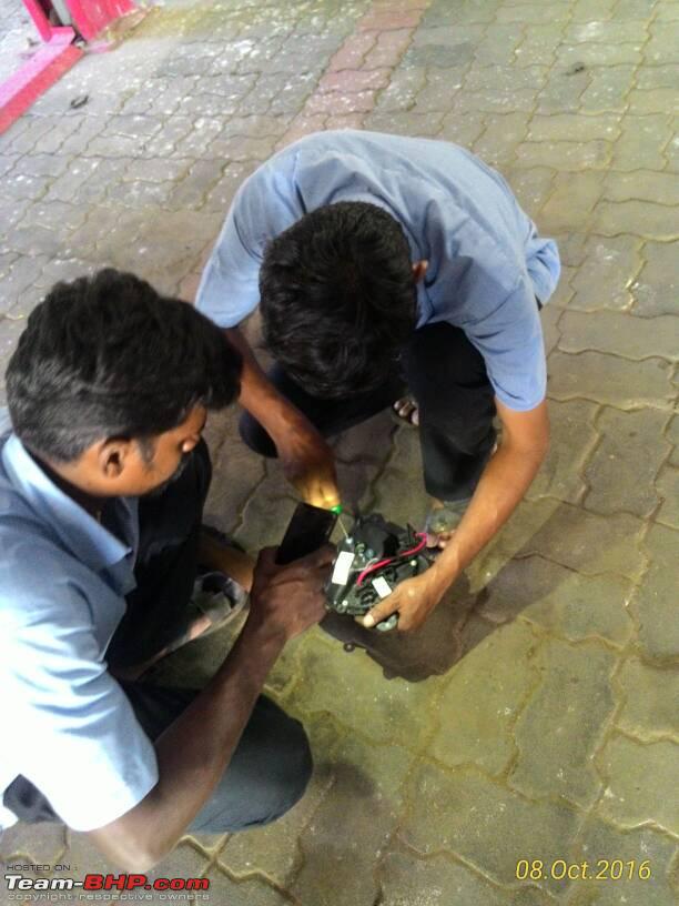

Post that headed to ambal auto a.c. works to check on the a.c. blower noise. After the last cleaning of the blower, the noise reappeared in a months time when driving over a bad patch of road.
So this time, removed the blower again and lubricated the bushes. He confirmed the noise was from the bush and oiled them. So far the noise has not come back. I'll monitor the same for another 2 months before deciding it as resolved.
Code6'd Fiat Linea MJD: 100,000 kms & counting!-1476373940289.jpg

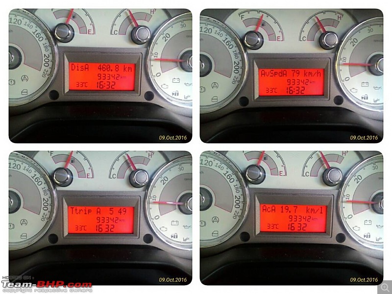

First highway drive with new shoes. Coimbatore to Chennai
Code6'd Fiat Linea MJD: 100,000 kms & counting!-1476373963208.jpg

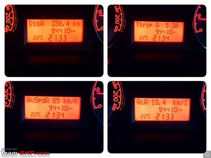

Back to Bangalore yesterday. Felt that a late afternoon start isn't apt for CBE-BLR drives. Started around 3:45 PM and found truck traffic on the higher side.
Code6'd Fiat Linea MJD: 100,000 kms & counting!-335cd0378361ffa26893d3e7e1d875cc.jpg
Route: Coimbatore-Sulur-Karanampettai-Somanur-Karupathampatti-Salem-Hosur-Attibelle-Chandapura-Carmelram
Took the Karanampettai-Karumathampatti to beat the Avinashi road traffic which sort of keeps increasing day by day and made worse due to Diwali being around the corner. This also ensures that you can skip the Rs.85 toll on NH544.

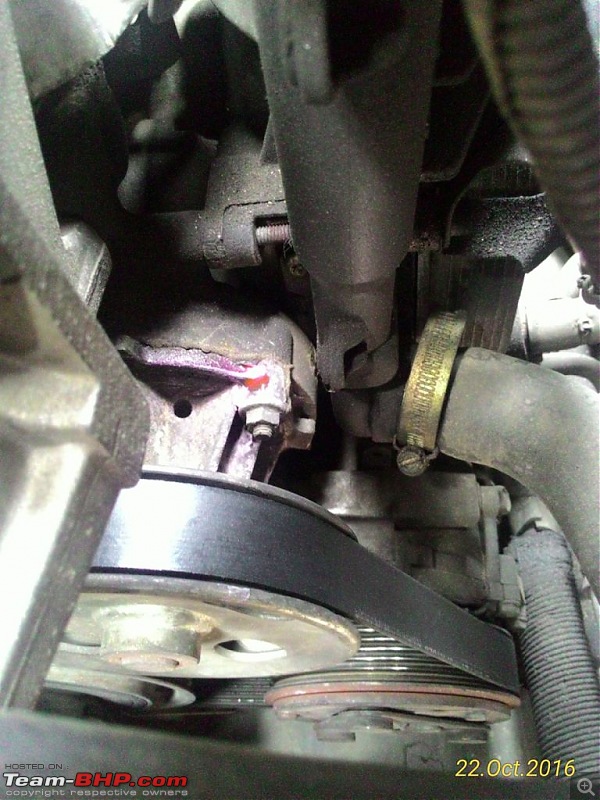

Prior to this, found minor coolant traces from the water-pump. So I'm due to get the same changed soon. Will have to keep a close watch on the same and plan to get it fixed.
Code6'd Fiat Linea MJD: 100,000 kms & counting!-waterpump.jpg

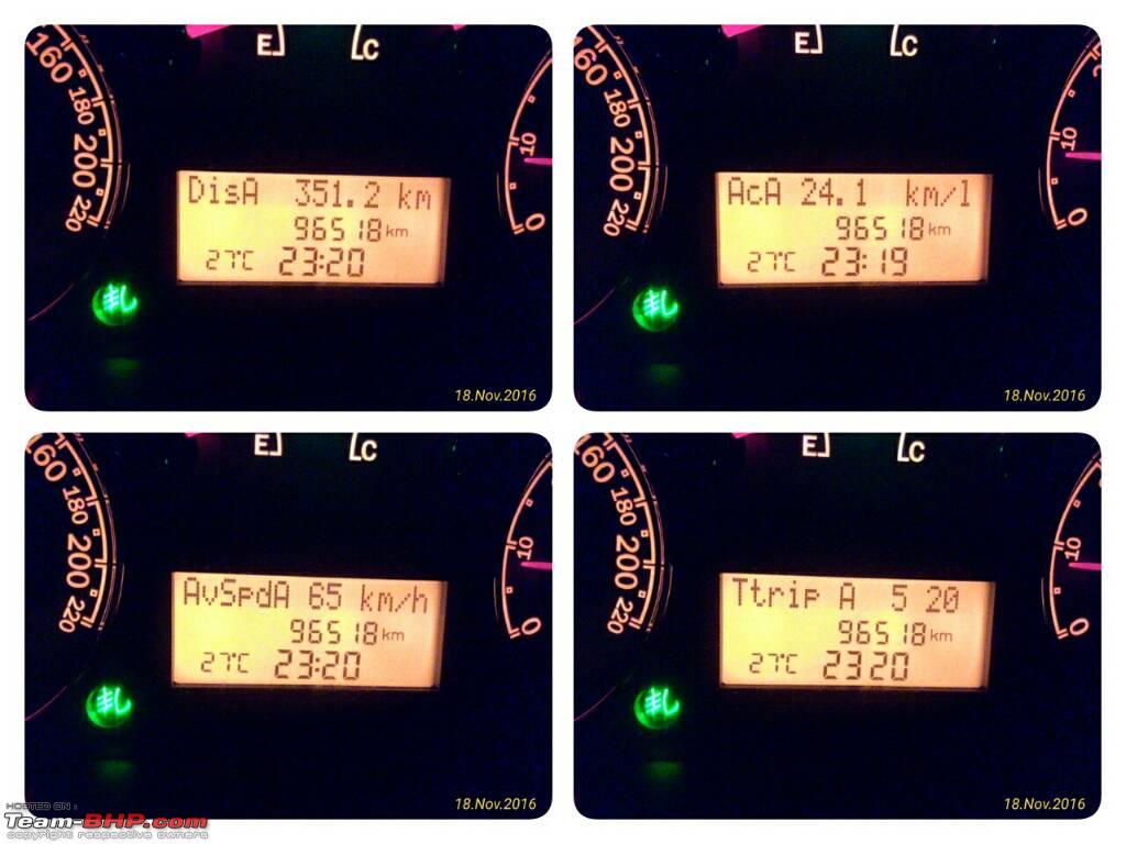

No tolls meant I could do another home run last weekend without much deliberation
Onward
Code6'd Fiat Linea MJD: 100,000 kms & counting!-edede49d3b1cc9f41f59ee0520e83174.jpg
Return
Code6'd Fiat Linea MJD: 100,000 kms & counting!-8540a2b8723f9149d7b8798c048debd4.jpg
