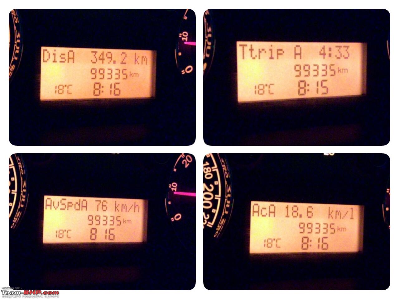

Return was on 26th morning. Started from CBE home at 3:45 am and reached BLR home at 8:15 am. A non-stop drive spanning 4 hours and 33 minutes. I did try the Sankkagiri Omalur route to skip the 2 tolls and was successful at that. These roads were also fantasic and hence the drive time sort of remained same as the one via Salem. I also skipped the Arasur/Karumathampatty toll by taking the Sulur-Somanur-Karumathampatty road.
Trip Stats: CBE-Sulur-Karanampettai-Karumathampatti-Sankkagiri-Omalur-Hosur-Bagalur-BLR
Code6'd Fiat Linea MJD: 100,000 kms & counting!-20161226_083350.jpg

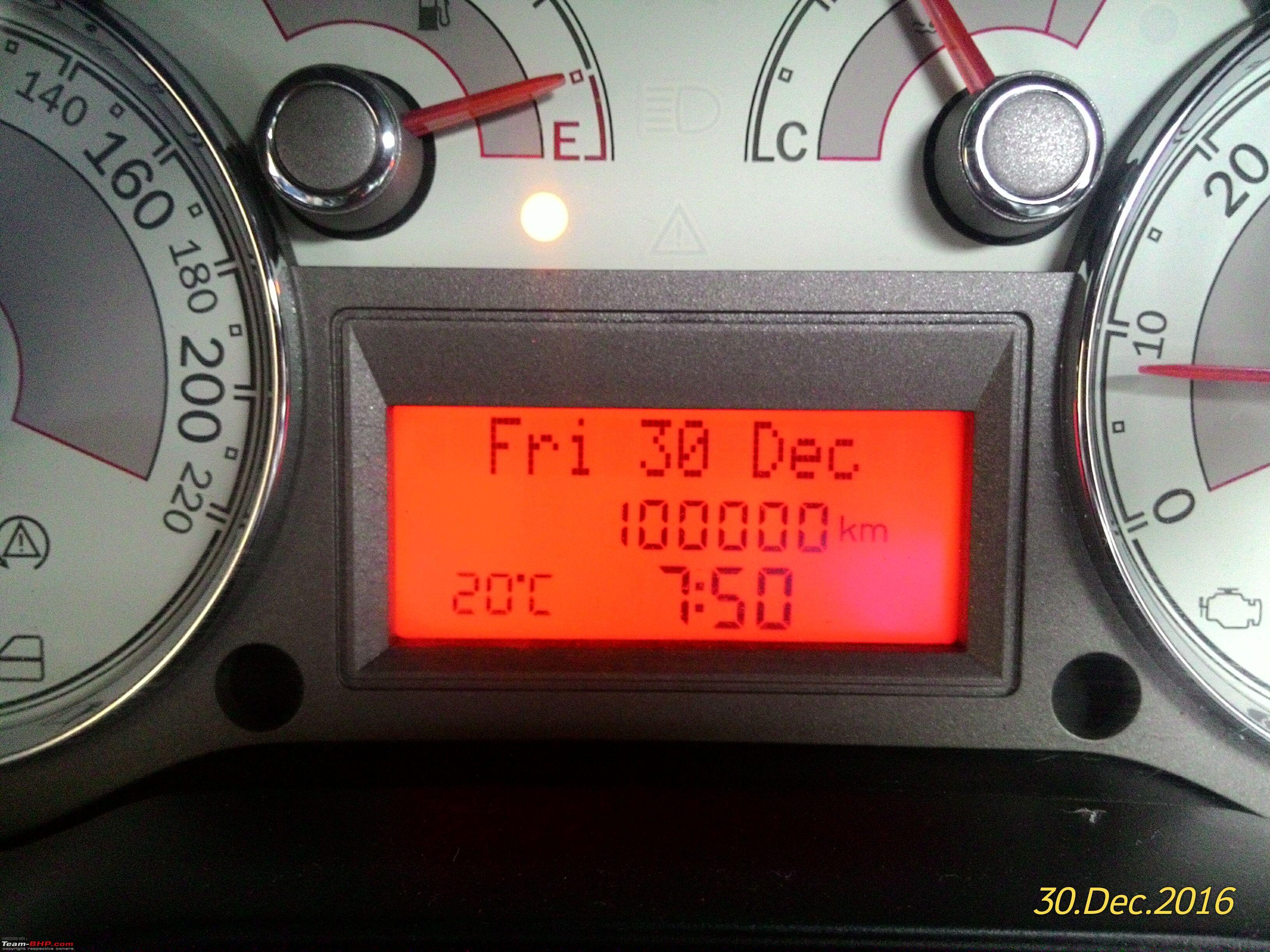

Crossed the 100,000 kms mark en-route the new year drive to Goa! Was able to achieve the same in 5yrs, 10 months & 16 days.
The last 53,000 kms came up in 21 months (day since I took over the car from dad) which roughly translates to 2500 kms per month.

5 digits for one last time on the Odo
Code6'd Fiat Linea MJD: 100,000 kms & counting!-p_20161230_075145_1_p.jpg

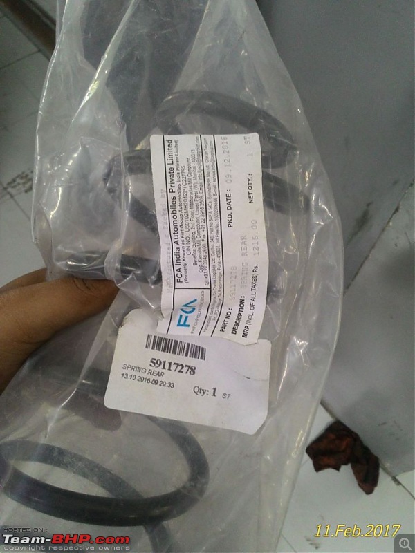

Last saturday (Feb 11) got the much needed suspension works done. Pradeep and DRIV3R helped once again to source the struts from Dhanam (Coimbatore) and bring it so True Sai Salem while I drove down directly to Salem from Bangalore. I got the Sona Koyo struts.

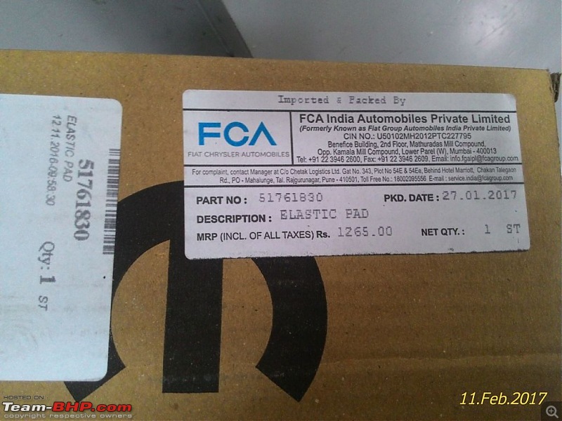

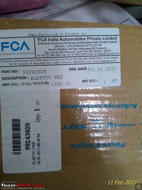

Decided to change all 4 mounts as well. But was also forced to getonto high gc due to the goofup by the Dhanam folks. Inspite of repeated confirmations they gave us the high gc struts. So decided to take the plunge into high gc as anyways I know I can be happy with the increased gc in Bangalore.
Moreover I was not too keen on changing the parts by getting back to Coimbatore from Salem due to want of time and the uncertainity of the part availability.
So the additional expense was on the change the rear coil springs had to be incurred for the taller shock absorbers.
Work was done neat and fast in the usual true sai manner and post a TD got the alignment done.

Rear Coil Spring
Code6'd Fiat Linea MJD: 100,000 kms & counting!-p_20170211_114658_1_p.jpg
Rear elastic pads
Code6'd Fiat Linea MJD: 100,000 kms & counting!-p_20170211_114754_1_p.jpg
Rear elactic pads/mounts
Code6'd Fiat Linea MJD: 100,000 kms & counting!-p_20170211_115239_1_p.jpg
Front elastic pads
Code6'd Fiat Linea MJD: 100,000 kms & counting!-p_20170211_115022_1_p.jpg
