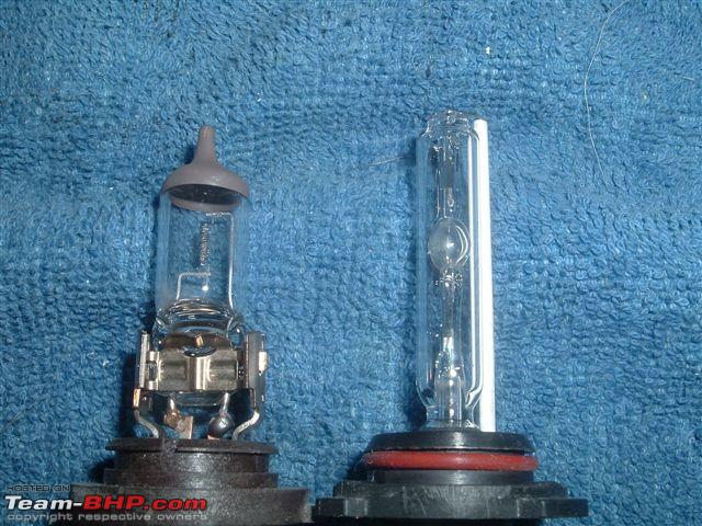

No, even the HID arc is longitudinal as with most halogens ( H1, H4, H7, H11) - H3 is the only transverse filament on , I think. The difference is the size and spread of the arc vs the filament. The HID arc apparently spreads more, and thus must be used with projector to prevent stray light escaping. Halogen filament is more tightly controlled and even. Probably a better approximation of a point source than HID, but I suppose engineers must take into account the average area of the light source rather than use the theoretical point source, to design optics.
