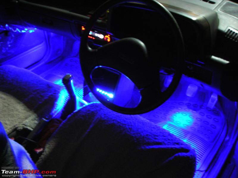

Hi! i'm new here! i own a 95 type 1 esteem. I did some diy mods to the interiors! I installed some led's. The connections were quiet simple, 18 LED's connected in parallel with a 560Ohm resistor each. the power supple has been taken from the cig lighter, Tell me what you guys think!

looks awesome, i would suggest you to open up the speedo console and remove the green rubber cap on the bulbs, its gives an oragne yellow effect, which makes the speedo very bright.
I am sure you must be facing the dull speedo problem
