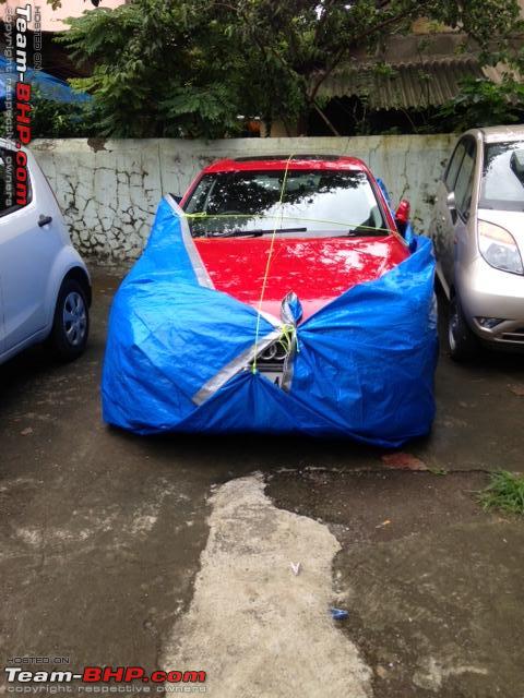

BHPian 2cents placed a chicken net around his car. Is this good enough?

Another option is a Car Capsule, but I'm not convinced. What if rats chew through the plastic cover? Then, it's Rs. 60,000 down the drain. I'd need a constant power supply and the effort involved in taking the car out & parking it back seems too much:
