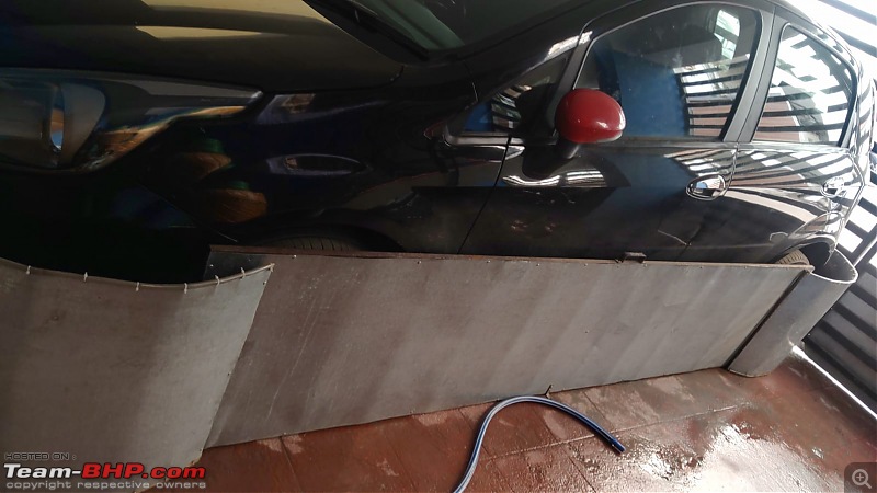

This seems like a simplified approach. Do you have the latest pictures / video of the final setup? Since you have used a single rolling sheet, the weight must be considerable. Can you kindly let me know what the sheet thickness is (0.1mm? 0.2mm? thicker?), length, height (3 feet?) and the weight of the full roll?

Attached 4 piece setup that i made as DIY for convenience. Its 0.2mm, 40feet, 3 feet weighing under 8KG as roll.
Thank you very much for the instant reply! 8KG is a really light weight design that gives me hope for daily use. (And I assume you have not seen any incidents of rats entering the car, by climbing up these sheet barriers.)
Never noticed a single event in last 4+ years.

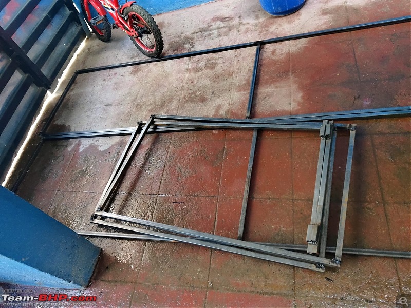

Looks like someone implemented the fencing suggestions from the opening post.
Thanks to Siva Shankar for sending these pictures in. Heartfelt gratitude for sharing them with other enthusiasts via this Team-BHP page!
Thank to this wonderful post, my car is now safe from the trouble of rats. I had something made from my welder and implemented it. I used GI sheet and metal frames, I got a total of 6 steel frames made and then nailed them with GI aluminium sheet. This has a very smooth surface which makes it impossible for rats to climb vertically and the entire car is fenced. The frames are closely locked with the help of a hook, so removing is easy. It has been 6 months now of using this and I have had no rat trouble after having this installed.
Also to note of the 6 frames (2 each side and 1 front & back each), I remove only 2 (Back and right hand side rear frame) to remove the car and park, so 4 frames are never disturbed. The whole process of removing takes me about 1 minute when I have to take the car out and about 3 minutes to park the car and place the frames. While parking just need to ensure the hooks are in place and locked.
This costed me about 10K, including the material and the welder charges. The welder took about 4 hours to get this done. This has given me great peace of mind and kept the car free of rats.
One more thing, I ensure that the engine guard cover never gets fully wiped (though I don't like it) as I want the dust to settle and be there as then I can detect any footprints of rats if at all they do sneak in (So far no such intrusion!).
Some pictures of the setup.
