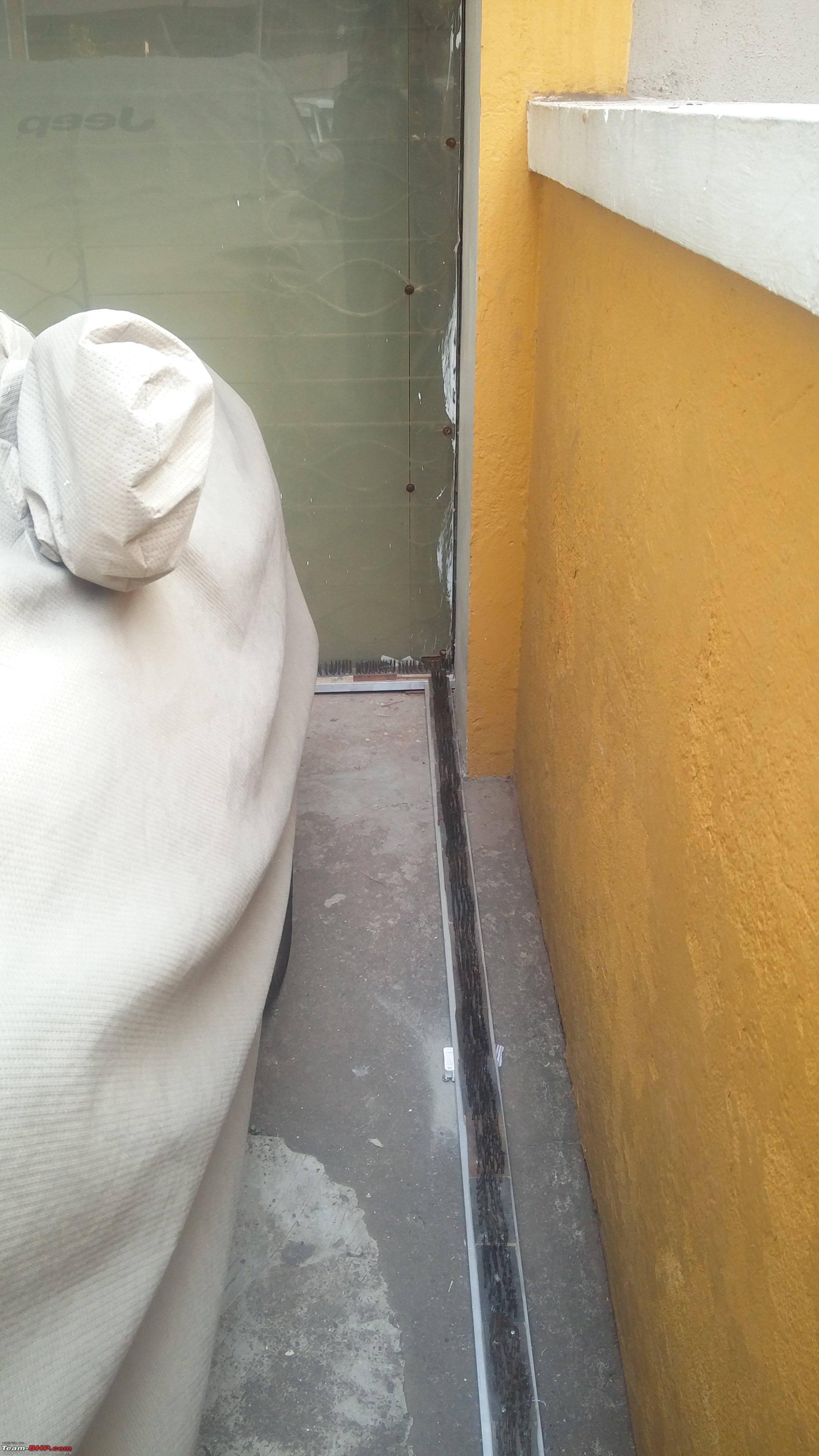

After seeing the success of my rat-repelling borders, a close friend got the same for his Compass.
Takes ~2 minutes for my watchman to remove or put back.

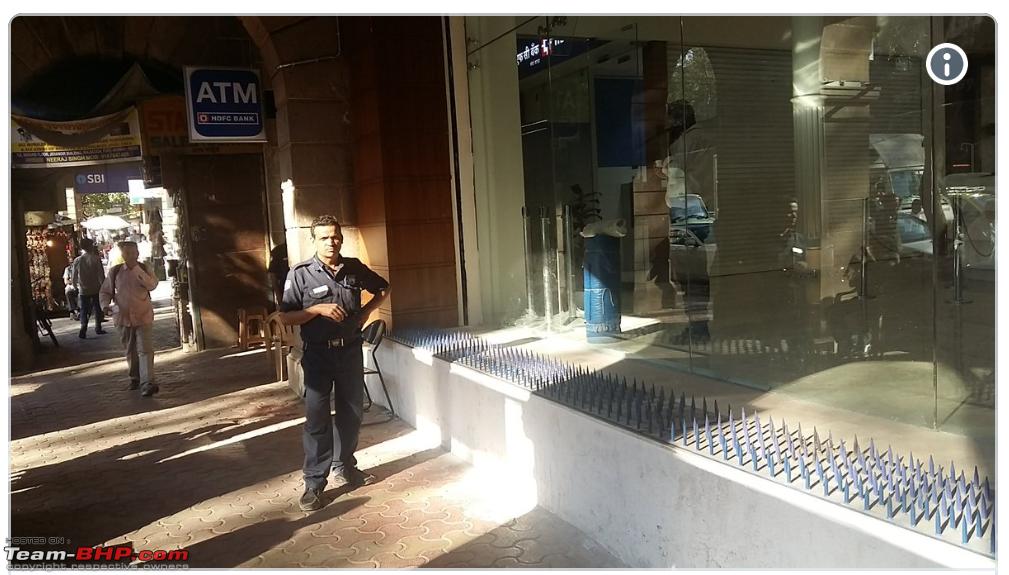

A slightly off topic news from the financial capital of India; although the intended targets are people and not rats. NDTV carries the news of a bank using iron spikes on the pavement outside its branch as a deterrent to the homeless folks who could use the space to sleep at night.
The same has apparently been removed after the move was criticised in social media.
A prominent bank in Mumbai is facing massive outrage over its unusual move to put up iron spikes on the pavement outside a branch, to prevent the homeless from sleeping there. Responding to the public anger, especially on social media, the HDFC bank on Tuesday assured that it would remove the spikes outside its new Fort Branch immediately.
Rat-proof Fencing as a solution for the rodent menace?-screenshot_20180327185453571_com.android.chrome.png
The website cites a tweet which raises a valid question:
What if a kid/elderly or physically disabled person falls on them and gets seriously hurt?

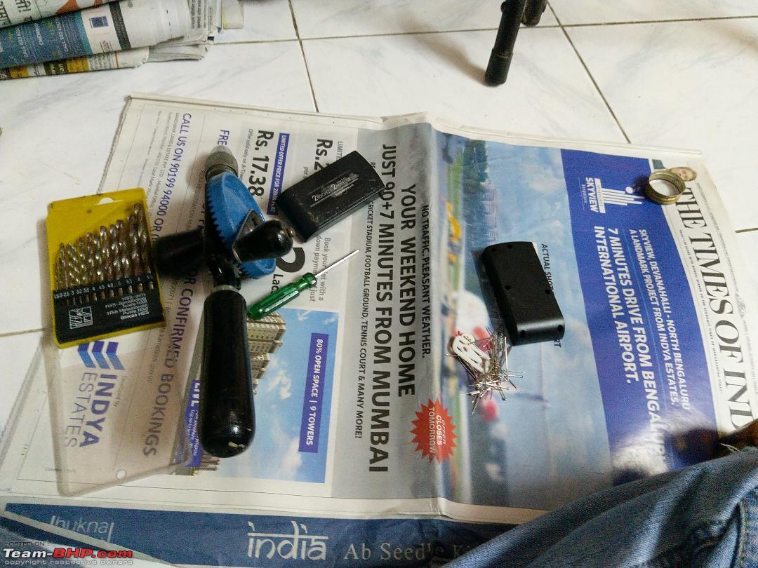

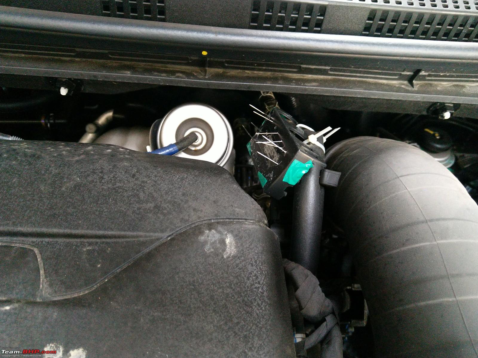

Here are the defenses for my new Verna. Just got her recently. Using all the experience from my previous rides I am trying to secure her with home made spikes. These spike thingy's are made from hard plastics that I found at home.Drilled holes in them and inserted sharp pins from the bottom and sealed the base with glue, foam and tape.
I decided not to get the Tar brush for the Verna because they looked ugly and was finding it difficult to mount them inside the car's engine bay. One advantage of the home made spikes is that they are extremely light yet prickly. They are also easy to install being small in size. The one on the battery is carried forward from my previous ride (Civic) and it was very effective from preventing the rats from making the battery top their private bathroom.
Rat-proof Fencing as a solution for the rodent menace?-img_20181028_073220.jpg
Rat-proof Fencing as a solution for the rodent menace?-img_20181028_073224.jpg
Rat-proof Fencing as a solution for the rodent menace?-img_20181028_073227.jpg
Rat-proof Fencing as a solution for the rodent menace?-img_20181028_073213.jpg
Basic tools used to make the spike thingy's

Along with the above I have also sprayed the engine bay with Autoshine's Rat repellent. It gives off a Sandalwood smell but being exposed to it a bit gave me a slight headache. Hopefully the above combination will prevent my car to mentioned on this thread ever again

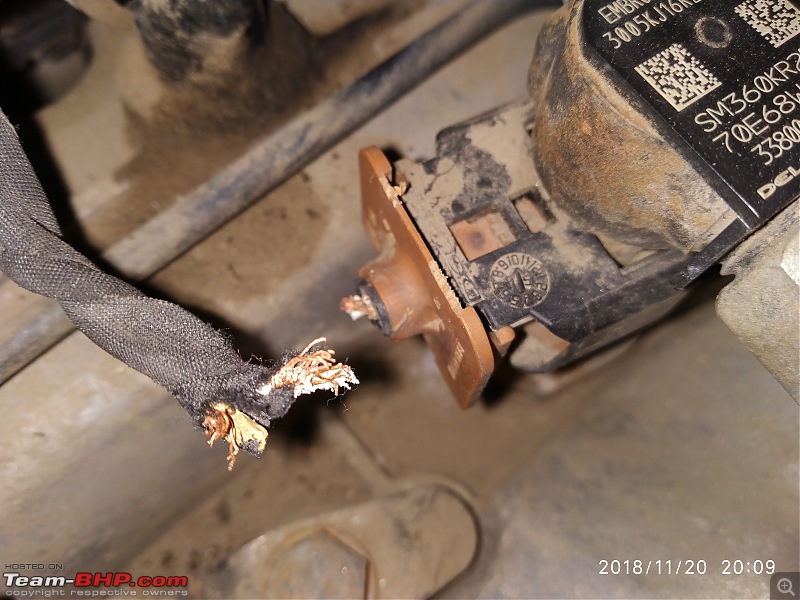

Morning when I started the car, I could feel unusual shaking. RPM was at 1000 in idle. When moved, power was definitely less too. AC was off as well. I thought of checking the A/C later and went to office.
Evening when I switched on, I saw malfunction indicator. Checked the oil level and coolant. All OK. A/c was still off. Power lower. Drove back home with warning light on.
While driving, my first thinking was rats cutting the wires.
Usually the ambient temperature sensor would be the victim. But this time, the temperature was fine. I was thinking of various possibilities.
After reaching home, checked the ambient temperature sensor which was OK. Checked any other wire cuts. Nothing. Opened up the engine cover and found this.
Rats !!!
One of the cylinders was off the entire time. It was running with 25% less power. That was why the less power and the shaking in idle.
Worst part is, the cable has been chewed right at the edge. I'm not sure if it could be connected. Me thinking my wallet getting bombed.
